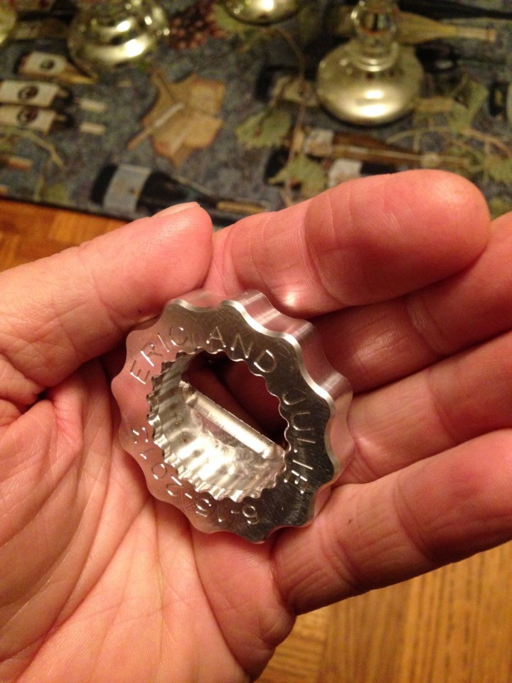

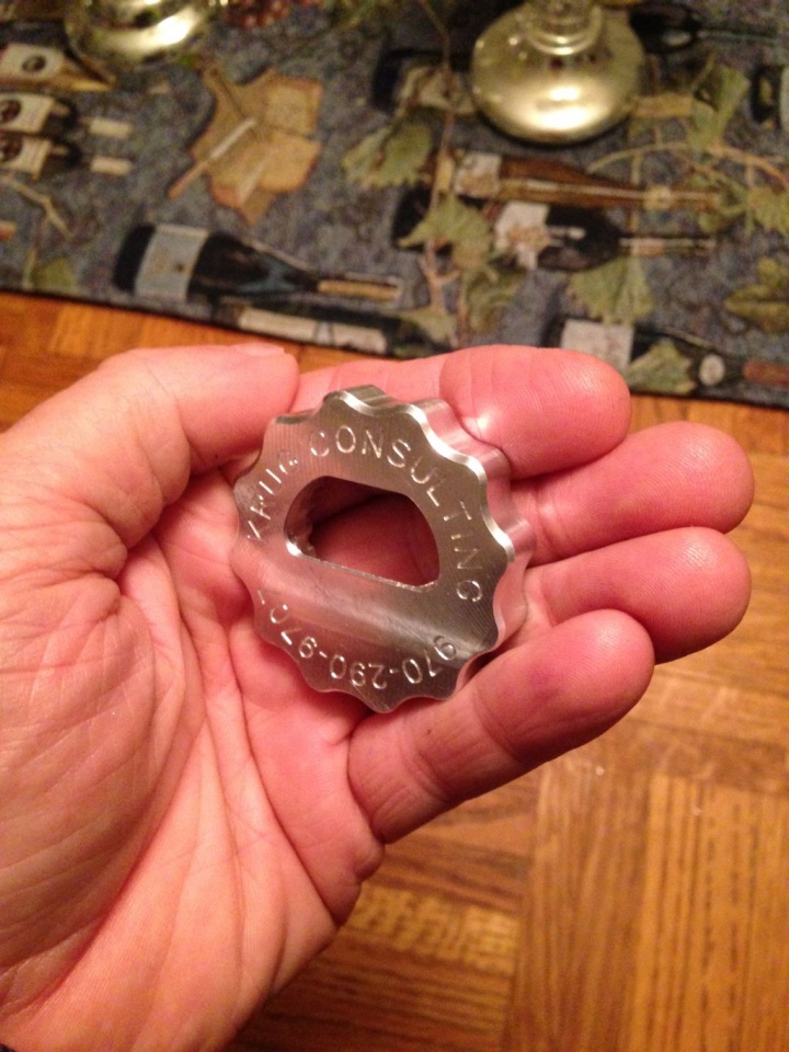

I'd rather not get into discussions on expertise and quality yet. Since you do not know me, I would let the product speak for itself. Assuming this project is a "GO", I'll provide a few bushings to select individuals and let you be the judge. I do not believe I can post a link in Market Research, so I'll just say that the bushings would be produced on a Haas 5-axis Vertical Machining Center. Google it and you'll appreciate the level of machinery used. While this machine is WAY more capable than making bushings, it can makes them at blinding speed. That is the only way to justify taking up valuable machine time on a friend's machine. Likely it would not disturb other jobs he is running.
Here are pictures of the top and bottom side of beer bottle openers for pry-open and twist off caps. He gave these away to attendees at his wedding. He cranked out over 100 of these the day of the wedding at his home. Designed using SolidWorks, milled from aluminum.
As long as we provide the machine the appropriate dimensions, it will create incredibly precise bushings.
