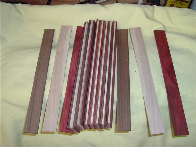

The first inspired pen looked okay but did not achieve what I was looking for so I cut up strips of Maple, Walnut & Padauk

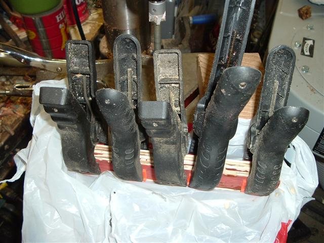

Laminated them up.

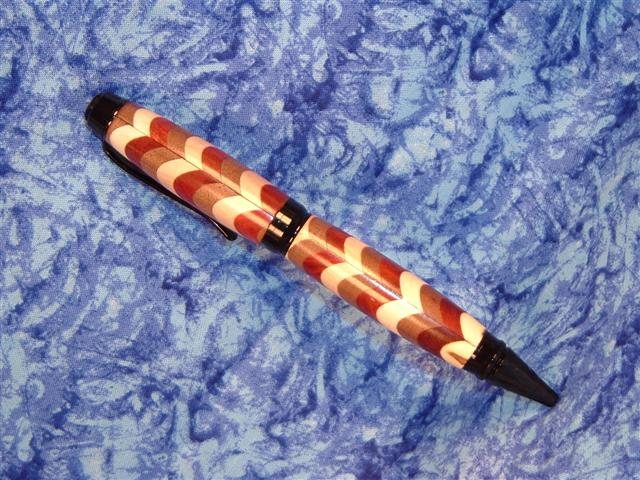

And cut them up a special way to make this one... Prototype #2
I learned that things need to be square.
Also learned was that I used the wrong cutting technique and wasted a full blank (Took 2 blanks to make this pen)
I should have taken more time in sanding the laminations to that you do not see the vertical line but that will come with the next pen. Finally, I'll probably make the strips a lot thinner and add some more wood species for interest.
This pattern extends completely around the pen, there are four good sides to this one.
Criticisms & comments are welcome.

What an eye catcher! <b>THAT'S</b> the kind of pen that sells a bunch of others.
"Wow! Where did you get that pen!?!"
"I made it..."
Great job. dynamite lamination. Way to go!
JimGo
Jan 24, 2005
6,498
North Wales, PA
VERY nice job! The laminations look GREAT! I like the slight curve to everything too. I agree with Bev, I don't think I'd add more colors; I'd be afraid it would get too busy.
swm6500
Feb 25, 2005
1,329
Palm Harbor, FL, USA.
Great looking pen Mudder, I say add some more colors and see what you come up with. Are you cutting the strips on a table saw. If so, what kind of blade do you use?

Cut on a bandsaw with a timberwolf blade and sanded with a thickness sander.

Mudder that is a nice looking pen, I think that if you made the strips thinner you could get away with more colors whithout it being to busy.

Very impressive. Apologies for a couple unsuccessful attempts not necessary. I thought the verticle lines added a nice touch and were intended. For my tastes, thinner wood with more segments and colors might make it too-too busy. This is a very attractive pen.

Strips ended up around 3/32" (.095" approx.)
