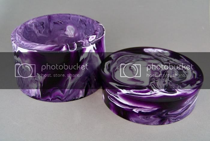

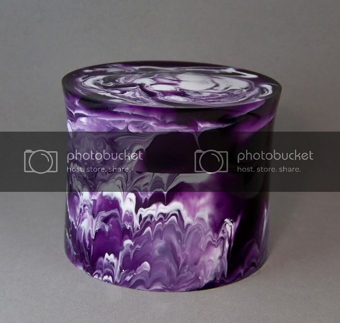

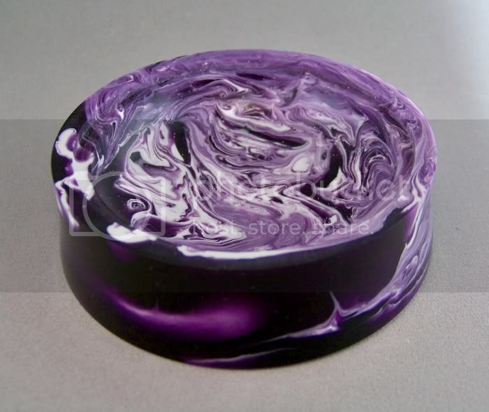

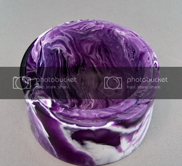

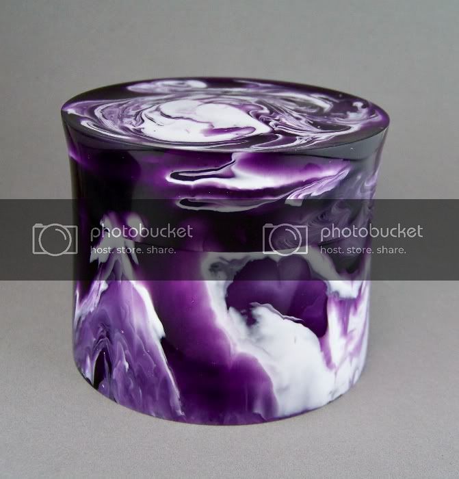

Especially George Watkins' article on turning a box. Thanks George! The instructions were easy to follow and I'm super happy with my outcome! The blank is of my own design. However, it's Alumilite! I wasn't confident enough to try it with PR. I haven't really done any turning other than pens and the occassional bottle stopper so my skills aren't very good with larger turnings. One thing I learned, and you can really see it in the pix, is that I needed to use more pressure and probably needed to leave it in the pot longer. I used 40lbs for about 3hrs and I still ended up with tiny pin holes all throughout the blanks. That's those little white specs that look like dust. Even with that I'm still super happy with my results. I made this one for my wife (She loves Purple!). On a special note, besides my parting tool, I only used 1 tool to turn the entire box. That was my grandfathers round nose scraper that I inherited when he passed when I was 10. I've never really used it before, but I was thinking of him while turning this so I found it fitting :) . So thanks for looking everyone. Comments/Thoughts always appreciated!

Why did you choose a Alumilite? I was turning several blanks last weekend. Most were your PR :wink: but I did two that were Alumilite. I thought to myself how much better I like the PR than the Alumilite. By the way really great job. I like the box and really neat that the scraper brought you fond memories.

Beautiful job! What I find with Alumilite is that if you wait to long to get it in the pressure pot, you will get those pin holes. 40 lbs is enough pressure and 3 hours is way more than enough time for it to set up. You are inspiring me to do something with those extras of resin I have in cups sitting around my shop.

Why not fill the pin holes with CA while turning. Then when you polish it they will not be visible. Just like doing a pen when there might be pin holes exposed by the turning.

Looks great Jonathon. What size is it? I can't tell from the pics. Try black shoe polish on the pin holes.
Mainly bc it's less likely to shatter if I get a catch. I prefer to turn PR but I don't have the confidence to turn somthing that big in straight PR. I give those blanks to my friend Russell to turn :devil:
Good to know, thanks Eric. I'll probably make a couple more blanks and I'll try to get them in the pot faster (I already have to move like lightning just to get all the darn colors in there!)
Thanks Earl, this one is approx 3" wide and just under 3" high. I'll see if the wife wants me to try the shoe polish or not. Thanks for the tip.
