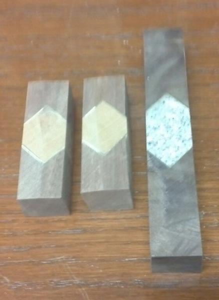

Seeing the pens that Mike (mikespenturningz) posted here, I decided to give segmenting a try and shamelessly copied his design..:smile:
I've done a Celtic knot pen before, but making these blanks proved to be more difficult for me... I've found that I TRY to be much too accurate when I probably do not need to be...
Anyhow, I have my blanks ready to drill and turn so I thought I would share them with you. These will both be slim lines...mostly because the kits are so cheap and that way I won't feel bad if I screw them up...or decide to give them away. And, I haven't really found another kit that I've fallen in love with yet. (Open to suggestions here)
The first 2 blanks are walnut, with a cherry segment. I used .010 brass instead of aluminum. I hope that it doesn't chew up my chisels too bad...:confused:
The next blank will be a one piece slim line and is a curly walnut burl with a corian segment. I decided to use .005 brass on this one...
I wasn't sure which thickness would work out the best, so I figured the best way to find out was to try em both.
Let me know what you think of the blanks...I'll post pics of the finished pens...if they turn out.
Thanks
Geo

So, onto the blanks...I drilled them last night. I was having a bit of run out on my drill bit so the holes aren't as tight as I like. Had to use what I had...
When gluing in the tubes, some idiot let the CA glue the blank to my glue board (used to protect workbench surface). Upon trying to remove the blank, a corner of it snapped off. :crying: I just glued it back on, clamped it and went to bed.
I will at least turn it today to see how it works out...
Updates to follow.

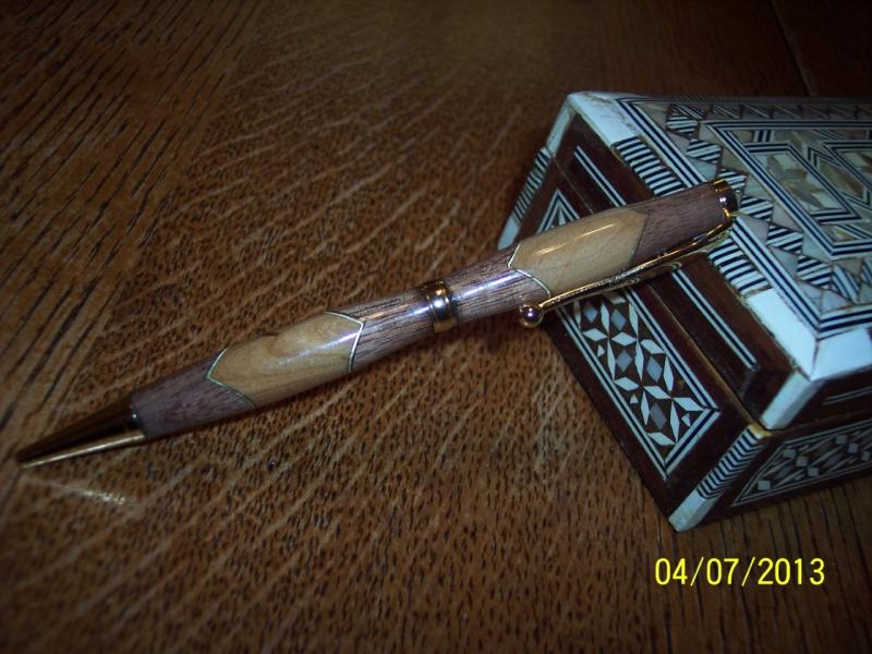

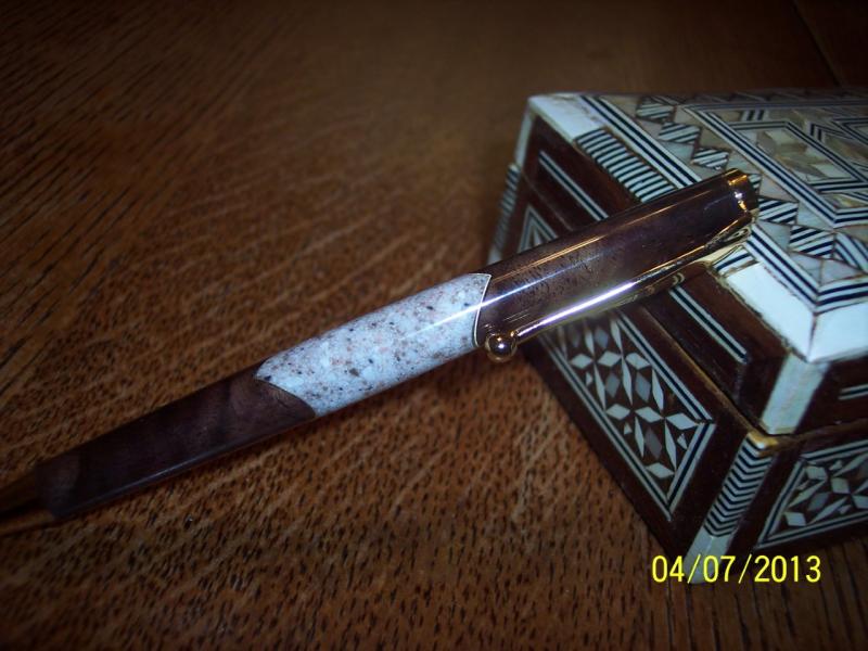

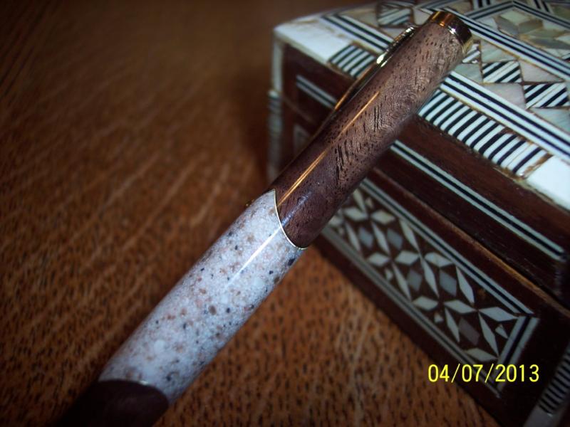

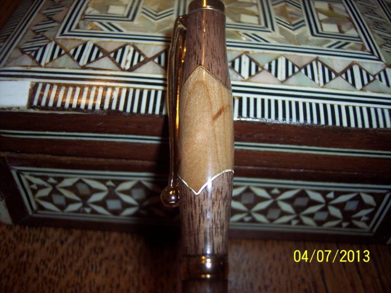

finished
My first two segmented pens...
The finish is 20 coats of CA...then up to MM 12000. Got really excited when I saw the lustre at MM 4000...and I think it just got better from there.
These are some of my best yet...at least I think so. C&C welcomed and encouraged... I know I need work on photography.
Thanks
Geo

Well, I think that proves that a slimline is certainly acceptable for this kind of segmenting. Nothing at all wrong with turning slimlines. I did 3 or 4 slimlines when I started turning, then quickly moved to the larger pens. But about a year ago, I started doing them again. Not all the time, but enough to know that they can be fun and really good looking. And like you said, they are really great to practice new ideas or skills.

If you keep the blank that fat then sure. Not for my taste on that look. Just my opinion:smile:
Good Job!!
Hi John... I'm just curious and I value your input. What did you mean when you said "if you keep the blank that fat"...
Do you think they should be slimmer? I'm always looking for constructive criticism...no hurt feelings here.

In my opinion I am a bushing to bushing type person with a hint of bulge on some kits such as a Sierra kit. It is tough to do with a slimline because of the small waste or centerband on them. Alot of people do away with the centerband and make their own so they can now be more concentric. To me I do not like the waspy look. I think slimlines if used should be just that slim. There are far better kits and more of them that lend themselves to blanks that have details such as yours.
This is just my own opinion which is worthless. The key here is if you like it then it is fine. You have to please no one except yourself unless you contracted a job out.:smile:

Hey John, I'm with you on how a slimline (using the centerband) looks best. I still think even turned down as you described, that the segmenting would be impressive. But I guess everything is subjective, and of course everyone has an opinion.:wink: My wife likes to tell me that I'm entitled to my opinion . . . . . . . . no matter how wrong it is.:rolleyes:
And Geo, as far as a better (inexpensive kit), I'd suggest the trimline. Basically the same, just uses a thicker centerband. That way, you can have it about as thick as you show, but without the skinny centerband. Or just do what you did with the 2nd pen, and eliminate the centerband entirely.

Thanks for the input guys...it is truly appreciated. I'm not really a fan of the "waist" look as much... but the curvature does feel nice in the hand I think.
I've been reading up on eliminating the center band to avoid the narrowness there. I might just try that.
Lots of things to try here... most important to me is to make sure my turnings are perfectly round and perfectly dimensioned at the tip, center, and nib...
Those are the goals anyhow.
