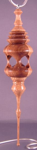

I actually started this one and its twin five years ago. I used two butternut and two walnut pen blanks and intended to part the turning in the middle and finish each ornament. I had a catch and lost one of the twins two weeks ago. I messed up on the inside of both so I put them in my v-block for drilling cylinders and used a Forstner bit to make the openings a more appropriate size. The finial and icicle are red oak. The main body of the ornament is about an inch and a half wide. Finished with Deft spray.

Have always wondered.....do you need to do anything special on the 'icicle' piece to keep it from breaking, or is it as 'tender' as it looks?

I was always worried about that too, Scott. But if you use sharp tools and go slow with light cuts it is actually pretty easy (with a straight grained wood, anyway). I actually leave it between centers through the sanding/sealing phase. Then I part of the thin end of the icicle and sand and seal it before parting off the tenon. Oh, I do support the back of the icicle with my fingers while I'm cutting. Kinda like a slidable steady rest. I keep the thumb of that support hand on the front of the tool rest. I'm not sure that makes sense, but that's what I do. It means one handing the skew, but with practice it isn't terribly difficult.
Now some will break or split despite your best efforts. You just never know what is inside the wood until you get there. I actually feared the Red Oak not being strong enough that small, but it was suprisingly resilient. Tighter grained woods like Maple and Cherry are definitely better for small things like that. The icicle on this one is just under 3/32" at the thinnest.

Great job and save. So, if the finial portion is 3/32 at the thinest, how tall is it? The one I posted just after yours is close to 9 inches tall and 1 3/4 at the widest. But someday I'll get to where you are with the small turnings.
It's actually the icicle that is the thinnest, Timothy. It is 7" tall not counting the eye.
