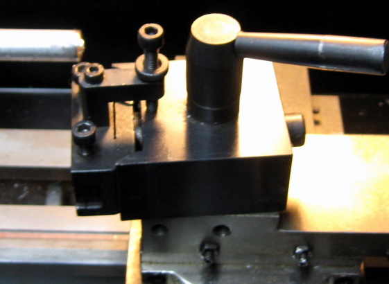

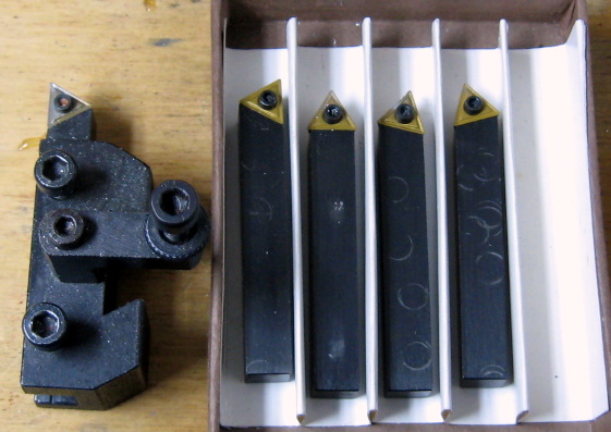

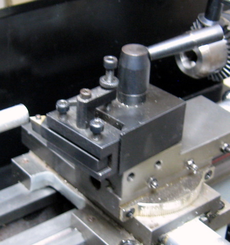

Jeff, I don't know if this will help you but, I thought I would throw this up anyway. I was given this set of tools by Mike Roux. I have turned aluminum, acrylic and, wood with this one tool that is mounted in the tool holder. I have used the one with the point in the center for cutting decorative grooves in my pen parts. I think these are available at Little Machine Shop. Maybe Mike will see this and, confirm that. OR, you can take a look at their site. Notice the tool post is turned slightly to the left to give the cutting tool a better angle for cutting. I know....poor pictures:redface: Hope this helps.
Those cutters were given to me so I don't know where they came from. I know you can get them lots of places. But I would think if you have a Sherline they may or may not be too big for it. I think I would check the Sherline site and see what they have. At least it will give you an idea of what's out there and what sizes will work.
