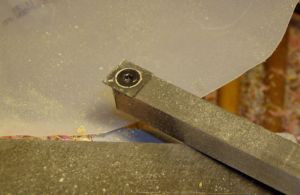

I don't know anything about how the others work, I looked at the Ci1 at Woodcraft, and one that another turner has in our club, and read an article by Frank - Rifleman1776, and made my own.
I enjoyed learning some new skills in making the tool. I have 2 more ready to go, and I am going to try some other inserts.
The first one took a little over 3 hrs to make. I must also say that JohnnyCnC, gave great advice and encouragement for me to undertake this project. The inserts I used were from Grizzly.
I can't compare it to the others as I have never used them, but it certainly makes wood round, very quickly.

soccer2010, Judging from comments above and from other threads, it's obvious that all the tools being discussed are simply holders for carbide tips. If one does not have the skills or tools to make their own, these readily available tools are just fine and a little shopping around will reveal some pretty decent prices.
Having the tools and the time to work with steel stock myself (sawing, drilling, tapping, etc) I chose to make my own carbide tipped cutting tool. I found some great prices on carbide cutters and the hardened attaching screws at http://www.globaltooling.net/. Click on Products then carbide insert knives.
I caught the cutters I needed on sale and am tickled pink with the way they cut.

I purchased my inserts from woodchuck/bitshird and got a piece of 1/2" steel from the scrap yard. A couple minutes with the grinder and a quick drill and tap and I was set. It's not super hard to do, but if you don't have the ablility to do it yourself then by all means get it from one of the suppliers.

The only bad part about grinding out the insert pocket is getting it dead level,and getting the back line right since it has to hold the insert from rotating. Carbide while extremely hard is also very brittle, it's easy to snap an insert by over tightening it, that's the advantage to owning a CNC Milling Machine, the new Woodchuck comes in two lengths, one for pens, and one for bowls, both made from stainless steel and both take 3 different inserts, 1 of which is rather difficult to find, it's a 2 inch radius insert that's 15 mm wide. The 15 mm square inserts and 4 inch radius inserts are easier to find, I don't even make the 14 mm tool any more but I still have plenty of inserts for them,
