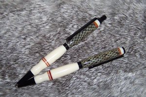

You might try ground coffee, cinnamon, paprika, or anything else you might have in the spice cabinet. This is a cheap easy solution to inlay. See the red paprika bands below on a Faux Ivory and Snakeskin Set.
