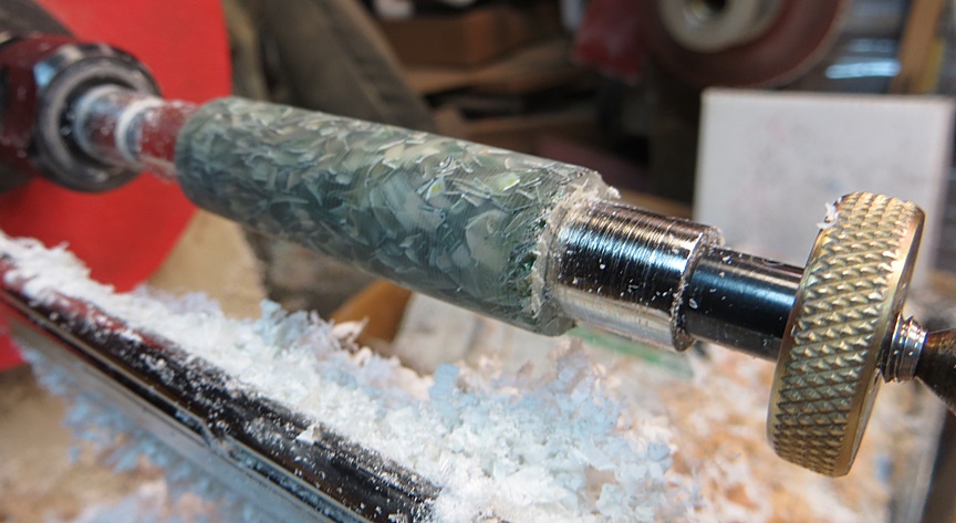

I turned some super brittle stuff that may have been inlace acrylester, my face was being pelted by little chips of the stuff most of the time. I ended up using a round nose scraper for the whole thing and it worked reasonably well.

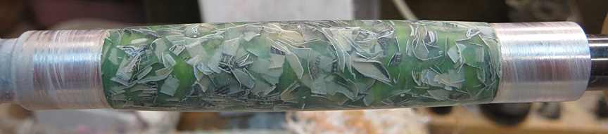

I have turned many of these, all with carbide. They are brittle and chip easy but like some have said the finished product is usually quite beautiful. Its my least favorite but for some pens they look the best.
I had good luck taking my Easy Wood Rougher (slightly rounded squarish carbide cutter) and tilting it up on edge at about 45 degrees for a shearing cut similar to a skew. Worked pretty well as long as the cutter was sharp and I didn't try to get very aggressive at all.

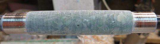

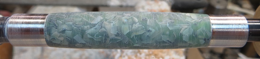

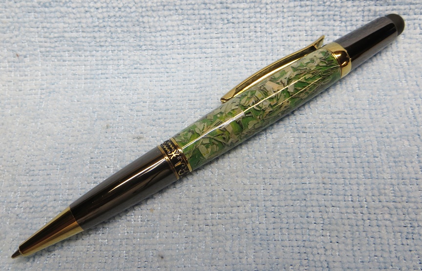

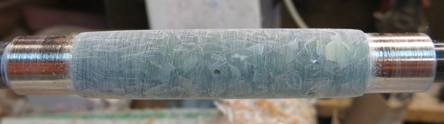

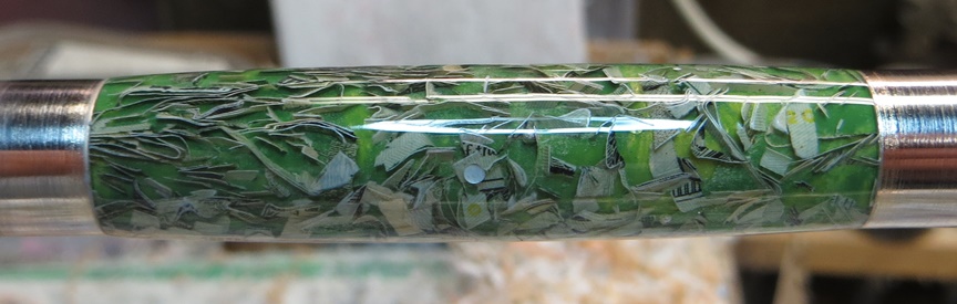

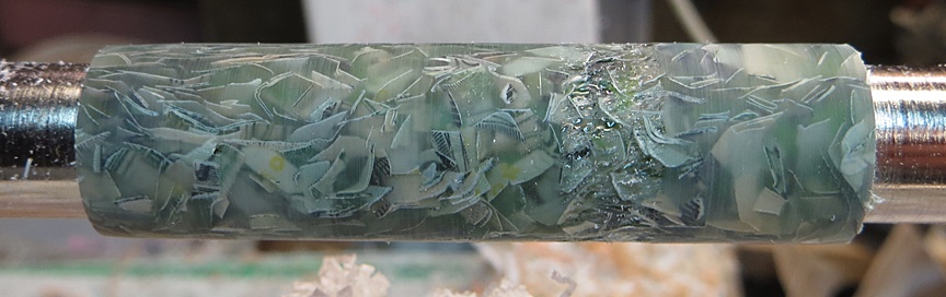

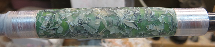

The last "chippy" blank I turned was a money blank. It has real shredded paper money embedded in clear resin. Even though it turned like inlace acrylester, I had no choice. My friend had her heart set on it. It was very brittle, but after I turned it straight, I switched to 100 grit sandpaper to shape the ends. That worked fairly well. But I won't turn another, or any IA blanks, if I can help it. It's just not worth the effort or the blowouts to me.
