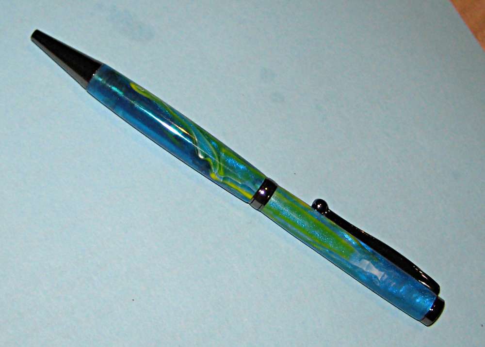

I just got back in from the shop; I've been turning some of this stuff tonight.
I really like the smell -- reminds me of when we patched surfboards. [;)]
I was turning more of the Ocean Mist tonight.
I use a razor sharp skew from square to round and all the way to finish.
I make sure the tool rest is smooth and clean so that I've got a good foundation to work from. I crank the lathe up full speed, then bring the tailstock up to the mandrel and lock it down. Then I just shred it.
Here's the one I turned tonight:
<br />

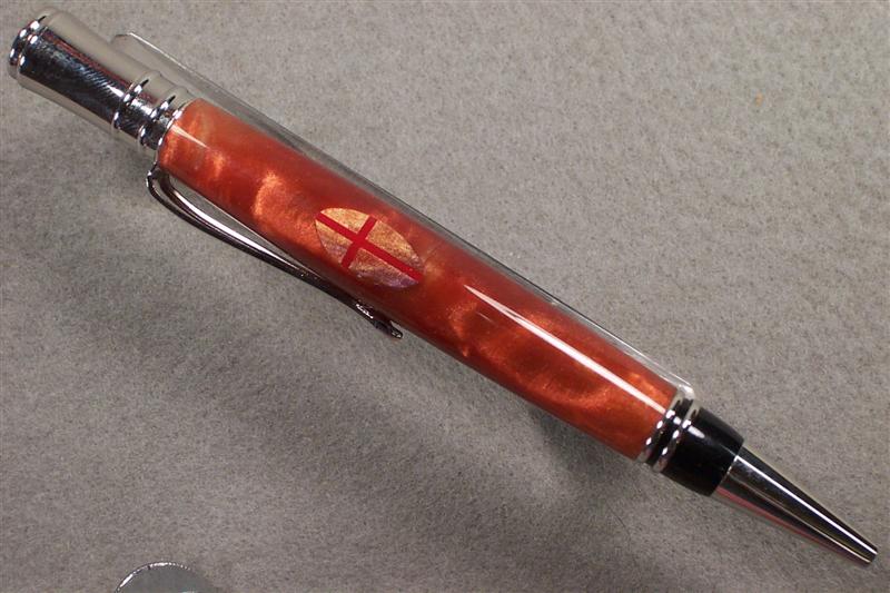

One guy even does inlays in these blanks and turns them with a skew too.
NB: I did NOT make this pen:
Take your time, scary sharp your tools and relax while you turn 'em.
IMHO, they're worth the time. It might take a bit more time to turn than wood but after turning properly with a skew, finishing only takes a few minutes. [8D]
