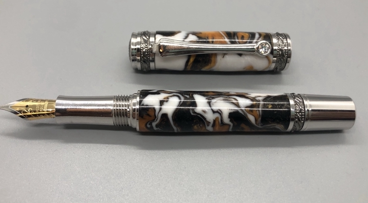

I don't like this stuff. I've never seen anything crack so easily when drilling, just little hairline fractures. It shines up really nicely, though. Any tips for better results or do I just need to practice more patience?
I have had the best luck with it by using 60-degree bits made especially for drilling plastics. The sharper point causes less aggressive penetration and significantly reduces catching that causes cracks and blowouts. I also pay special attention to letting the bit cool off to prevent cracks caused by the flutes packing full. And I try to drill to a depth then saw to expose the hole rather than punching through the bottom of the blank where bit catches are more likely.

I actually like the stuff. I found that the trick on drilling is to not drill all the way through the blank. I cut the blank in two and then drill from the matching ends just slightly deeper than the length of the brass tube. Then I cut the non-drilled end of the blank off so that the blank is just slightly proud of the brass tube. Face with sandpaper and not with an end mill. As far as turning goes, I never start turning with square edges. I always round them out. This minimizes chipouts. Sharp tools, light cuts, and turn them around 1000 rpm.
