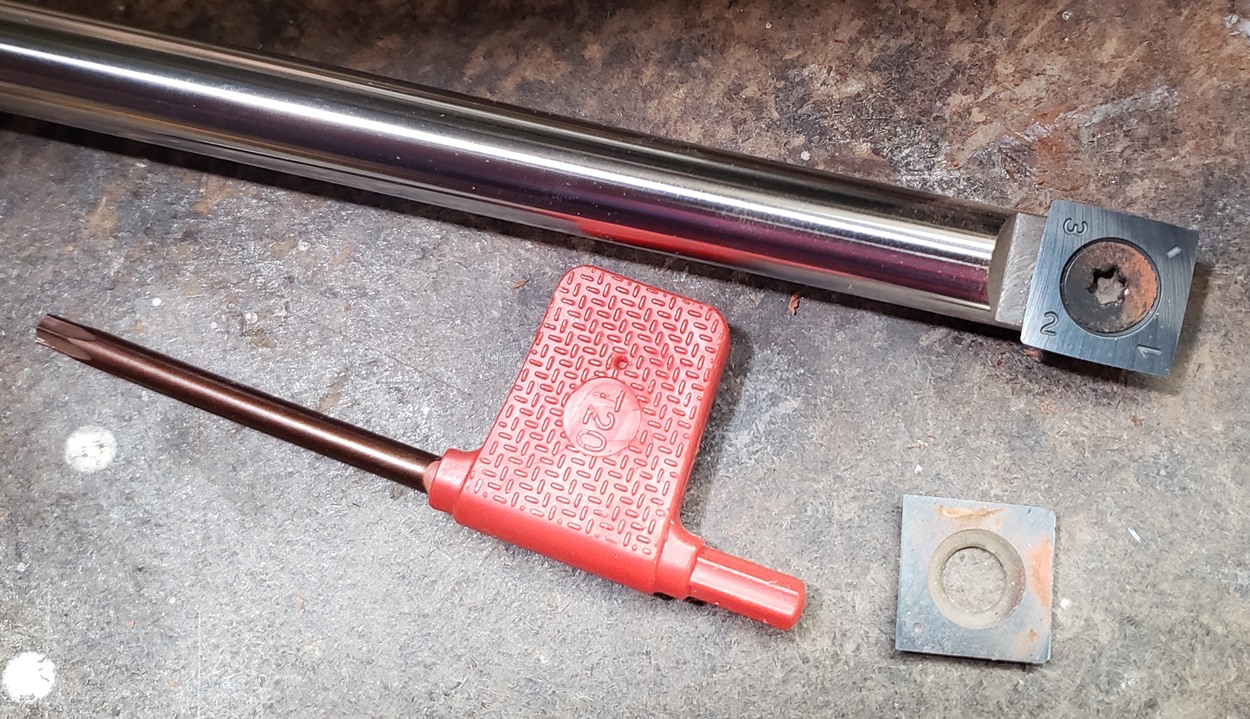

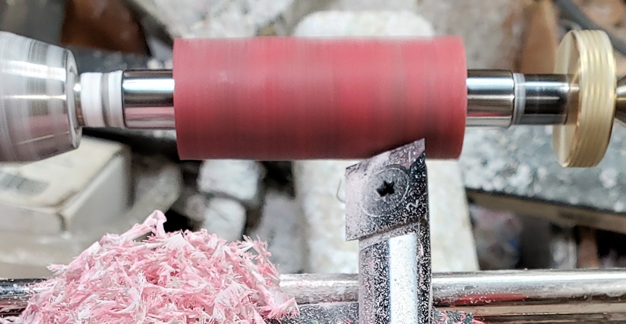

A round carbide with small cuts. Hold the carbide on a bit of an angle and do shear cuts. You can also use a spindle maker gouge if you have one. Just take your time with it. I use wet or dry sand paper starting with 150 grit up to 800 or 1000. Then use Micro Mesh starting with the coarsest up to the finest. The use some plastic polish and it will really shine.

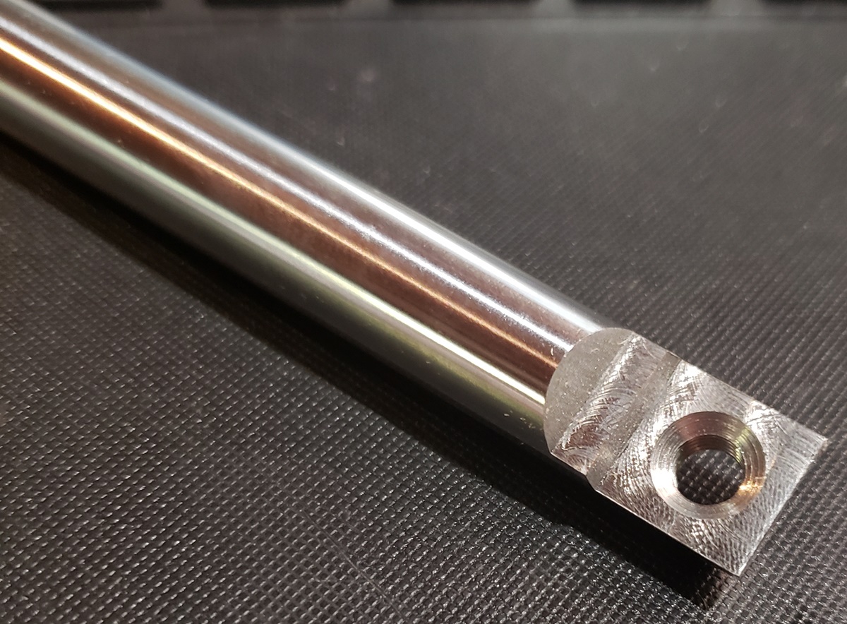

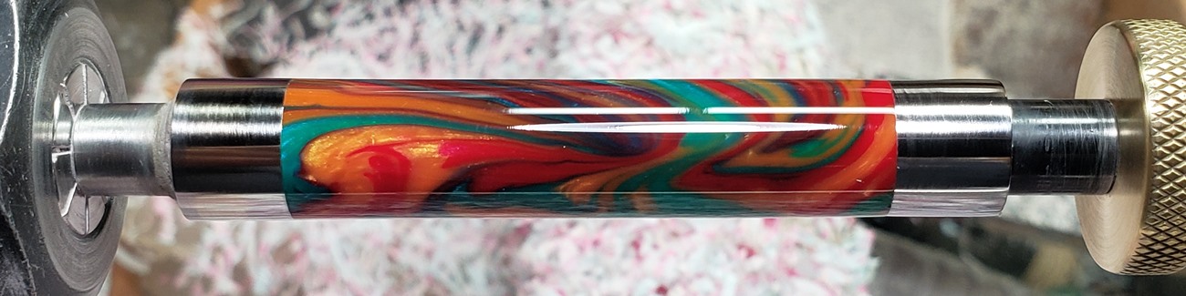

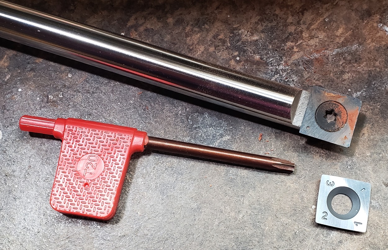

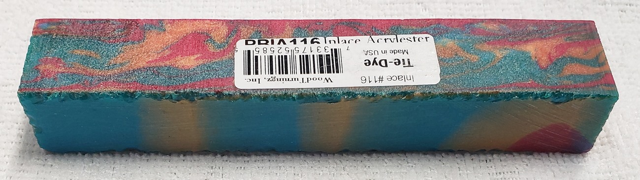

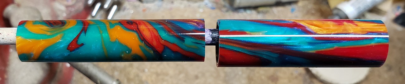

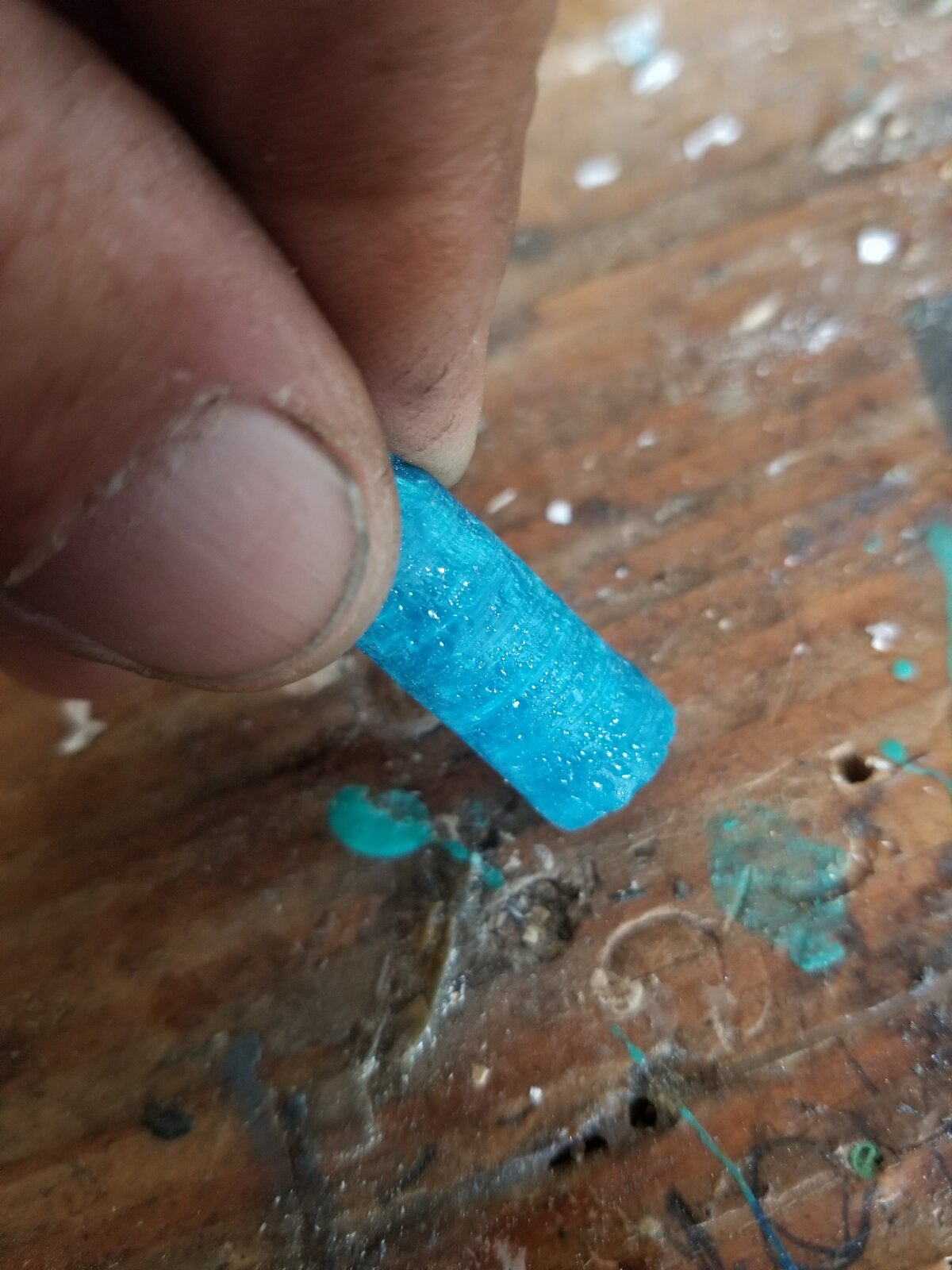

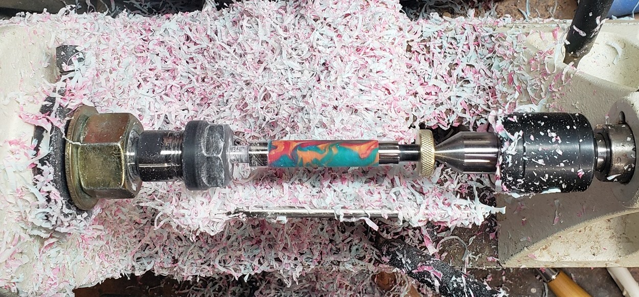

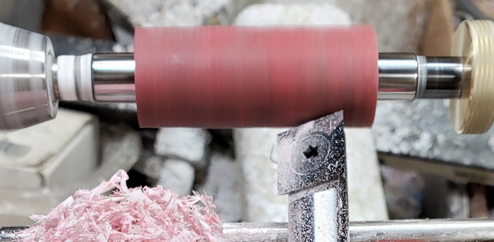

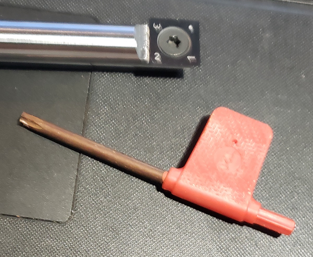

I used to hate turning inlace acrylester when I was using HSS chisels. I had all the problems you mentioned and more. But since I started using a carbide chisel with shearing cuts, I've had great success. I prefer a square carbide cutter with a radiused edge, but have used square cutters with no radius and gotten the same results. I tried negative rake cutters, and they do work better when the edge is held parallel to the blank, but have found they're not necessary when using shearing cuts. My chisel shaft is round, so I can rotate the cutter to whatever angle cuts the best. It's worth it, there are some truly spectacular inlace blanks.

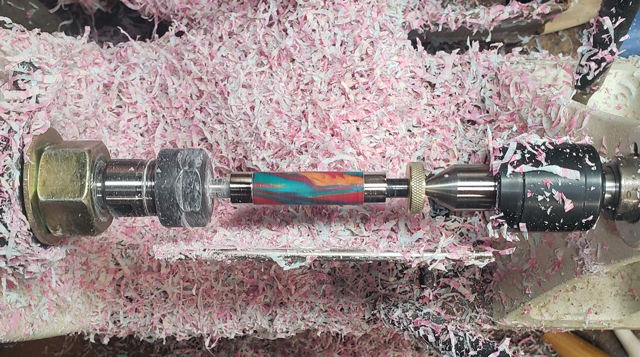

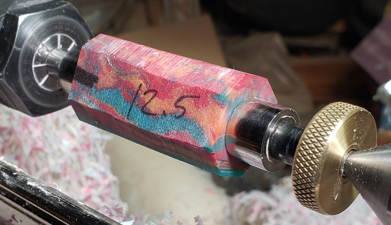

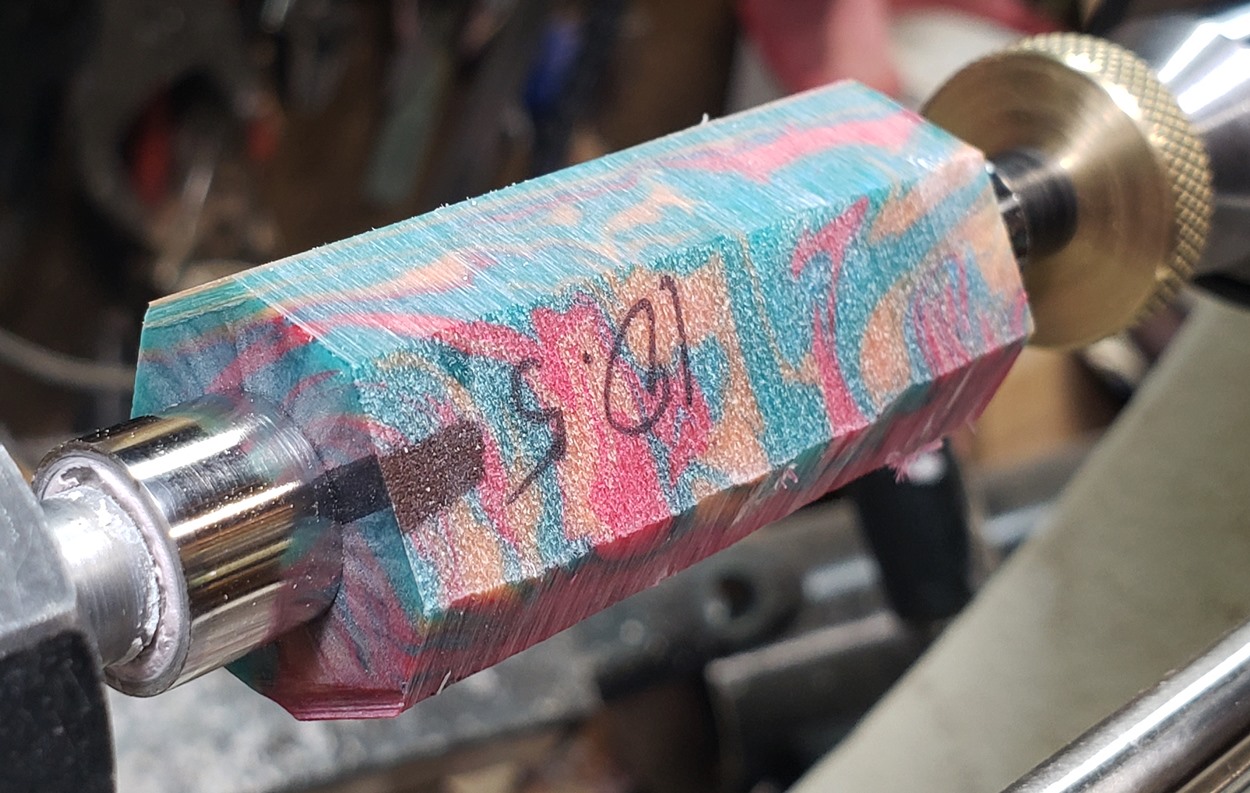

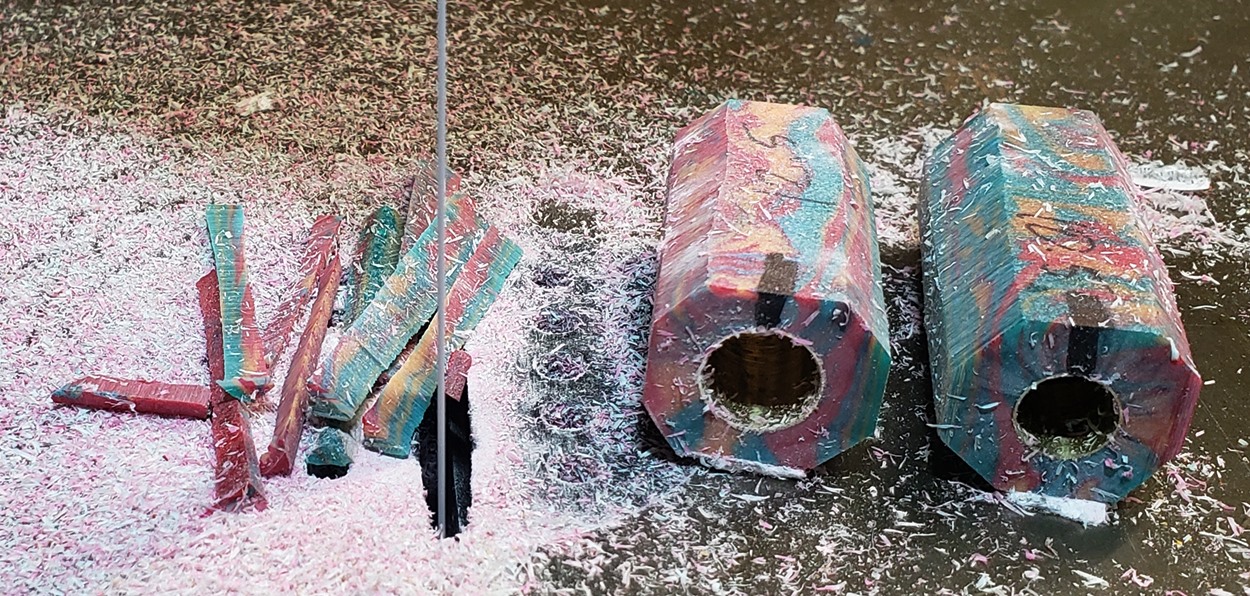

I forgot to mention one other thing that helps, me at least. I "knock the corners off" with the bandsaw before I start turning the blanks. I find this helps with the initial "roughing".

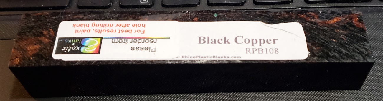

Then in between are a whole host of other plastic blanks. One of my favorites is Rhino Plastic blanks. Like Inlace Acrylester they are made using a polyester resin; however, this formulation is less brittle and considerably less "chippy" than Inlace Acrylester. Although it is still up on the brittle end of things, it is easier to turn than Inlace Acrylester and still produces stunning results. Rhino blanks can be purchased from Ed at ExoticBlanks, and Bear Tooth Woods. I think Penn State even sells some combo packs.
So, to reiterate, I recommend trying out some Alumilite blanks and then graduating to Rhino Plastic before tackling Inlace Acrylester.

Another plus with Rhino blanks is they're larger at 7/8" square. Perfect for larger pens.

I really like the stuff. i knock the corners off and use a home made cutter on a metal lathe that looks just like the one shown earlier.
i use this cutter for all wood and plastic finish cuts.
Another plus for Rhino is the quality to price ratio. High quality - low price. Ed at Exotic Blanks usually features a few Rhino blanks for only $2.50 per blank and almost all of the rest are only $3.00. - Dave

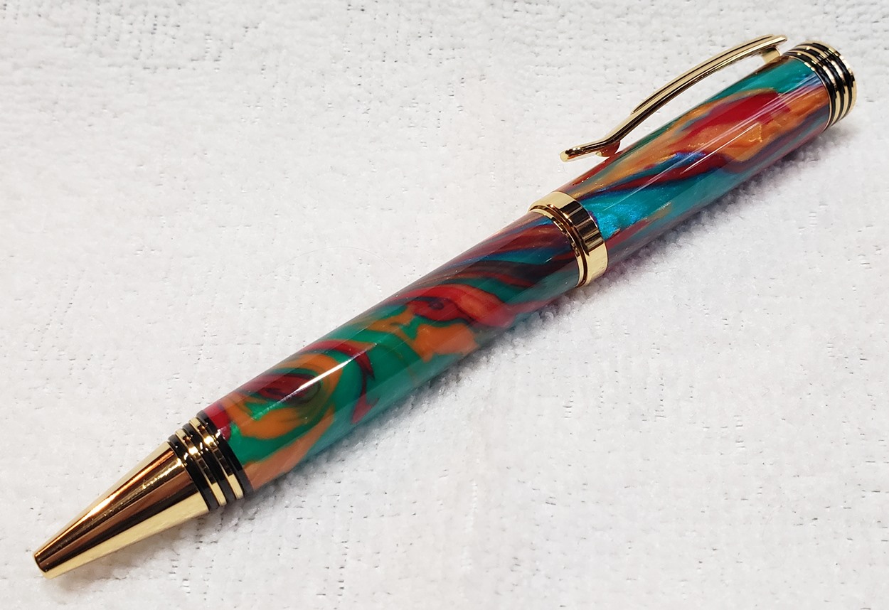

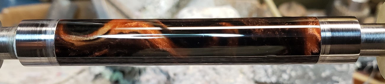

Thank you so much for taking the time and effort to post photographs!! That finished pen is stunning beautiful match of the blanks and hardware.

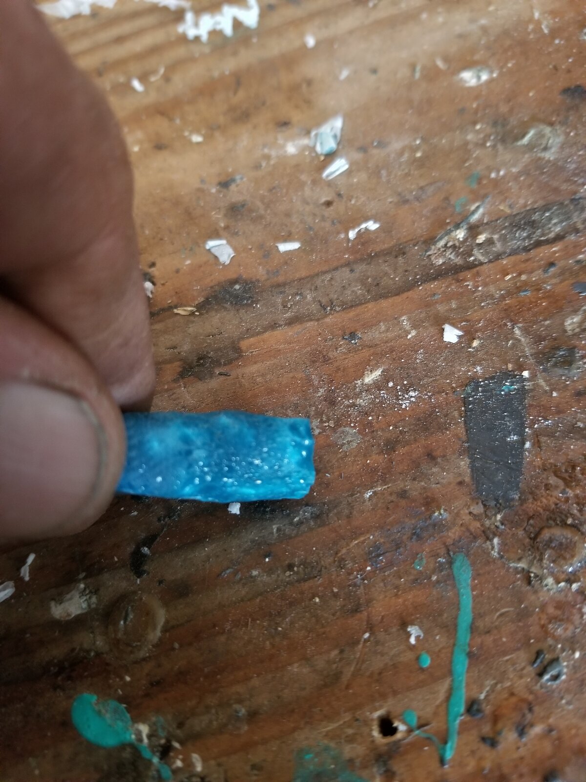

I tried this stuff and made a mess. Blank broke and as for now will not use it again until I get carbide cutters.

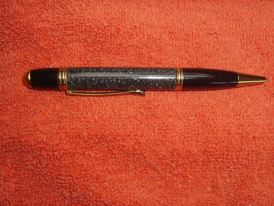

My first two inlace acrylester pen blanks blew up on the lathe. I stuck with it and now I get reliable results with inlace acrylester. It can yield beautiful pens with little practice. Once you get the hang of it, you will scratch your head and ask, "Why did I think this was so challenging?"
My Secret to Success with Inlace Acrylester:
Before turning, I put the blank in a ratchet clamp with the corner edge exposed. I use the ratchet clamp as a handle to round the corner edge on the pen blank. It doesn't have to be pretty, just round off the sharp corner. Roll the blank as you round it, and pay attention to the front/back symmetry as well. It doesn't have to be perfect. Rotate the blank and reclamp, rounding each edge in turn.
CAUTION: The fine dust that results from this step is incredibly messy and has static cling is like no other. I always perform this task outside with a dust mask and have learned to set up the shop vac to capture as much dust as possible. At first, I used a hand belt sander clamped upside-down in a Workmate workbench in the backyard, until I got a benchtop belt sander. Be careful.
I use carbide and HSS steel (skew, roughing gouge, and spindle gouge). I keep working on my HSS skills, but when the going gets tough with the inlace acrylester, I reach for the carbide - round and square radius tips do best for me. It takes me three times as long to do an inlace acrylester pen as it does for wood - but I am slow, careful, and patient.
Keep the lathe speed as high as it goes, your tools sharp, and take light cuts ... but everyone always says that for every pen question I see here. Be patient; practice makes perfect!
