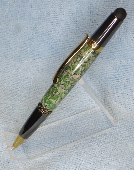

I love turning Inlace Acrylester blanks but they can be a PITA. I use a sharp skew and take very light cuts. It can also be helpful to trim off the edges by sanding or carefully cutting them off on a band saw.
Sorry, don't have any picts of pens made with them.

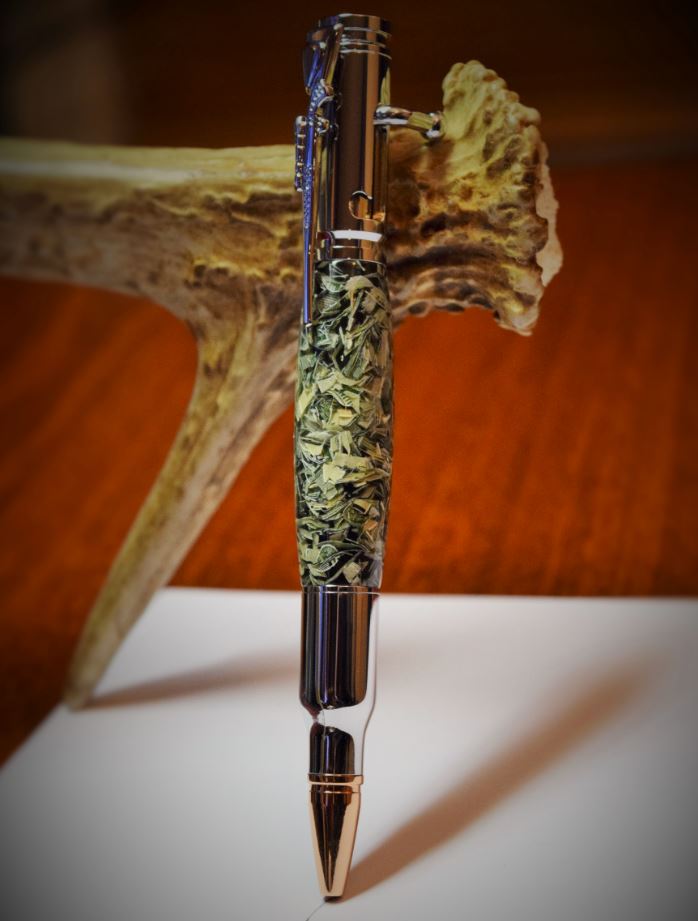

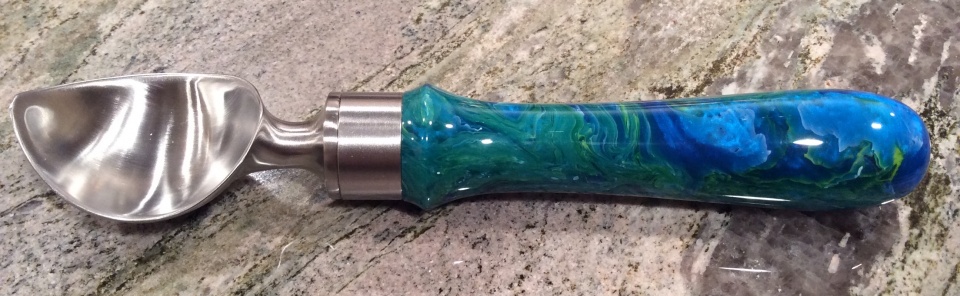

Well, it's not a pen but it is Inlace Acrylester!
Yes, very light cuts with a start tool. Bevel support will help prevent the tool taking too big a bite. Plan on sanding in to size if still getting chipping.

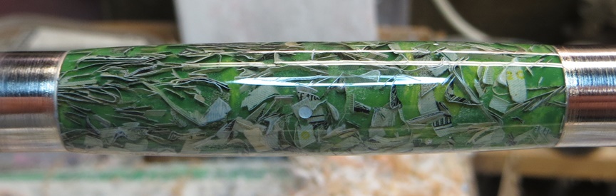

I turned one recently and it had quite a few bubbles in it. The bubbles filled pretty easily with CA and were hard to find afterwards. I actually had it polished up and found another bubble and had to go back and fill it. Other than that, typical of inlace acrylester - if you apply a lot of pressure it can chip out...and something about the way it doesn't want to cut sometimes baits me into applying to much pressure.

oh...and forgot to mention you will be able to see the tube through this blank - so consider reverse painting.
I turned one of those blanks several years ago, and found that the density of shredded currency was lacking. I reverse painted the drilled hole, but I still saw way more of the paint than I wanted to. Since I only did one, take that for what it's worth. YMMV.

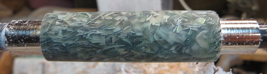

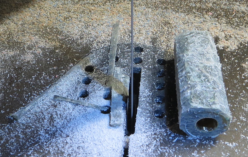

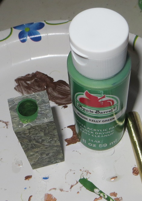

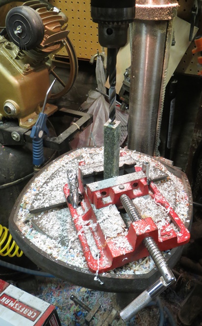

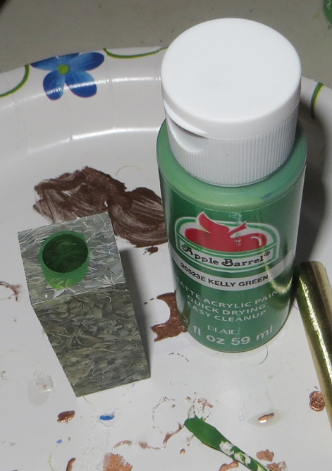

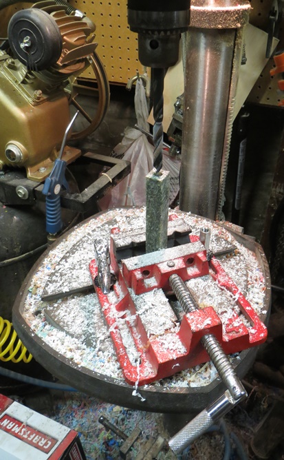

I got the blank in the mail yesterday, and started turning it today. Drilling it was no problem. I back painted the blank with kelly green acrylic paint, and colored the epoxy with the same paint. I also trimmed the corners with the bandsaw, to give myself a headstart.

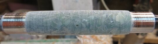

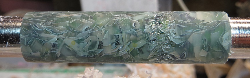

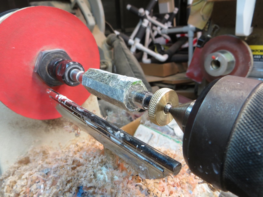

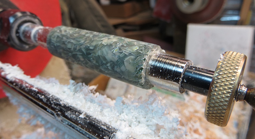

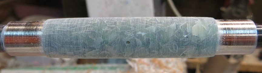

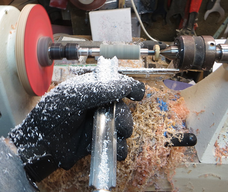

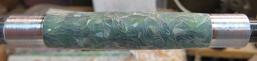

I tried several different chisels, including a 1" skew, 3/4" forged spindle gouge, and a 1/2" fingernail gouge. But the one I had the best success with was a 1" roughing gouge. I sharpened it several times during turning, and found that it cut best for me with it rotated slightly to the left. I don't know why. I did get some chipping here and there, but nothing too bad. I took my time, and channeled my inner patience. Yes, I still wear the glove. LOL

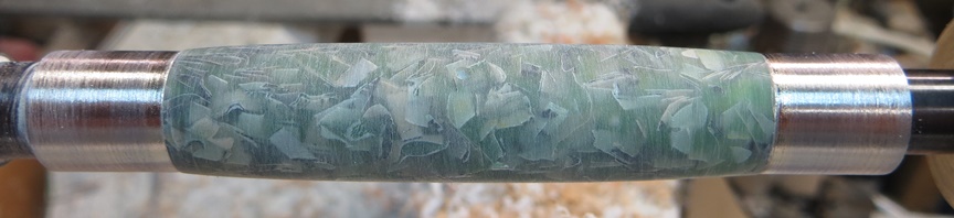

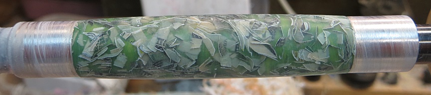

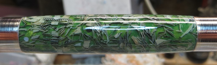

Once I got it turned close to the final diameter, I switched to the "sandpaper skew". I started with 100 and 150 grit dry to shape it, and then went to 320 and 400 wet. 320 and 400 wet is part of my normal polishing process. The last photo is after the wet sanding.

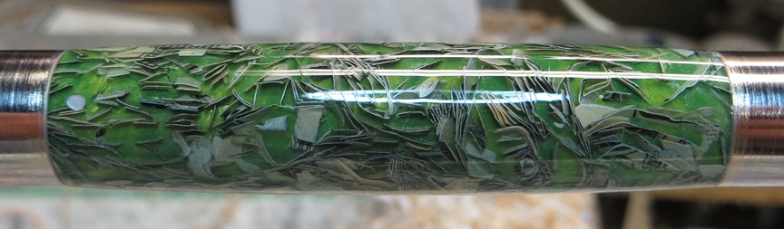

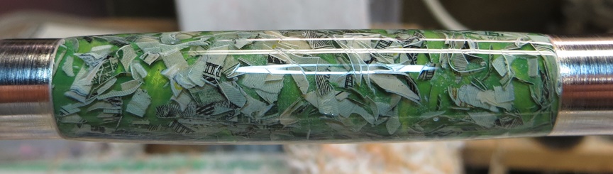

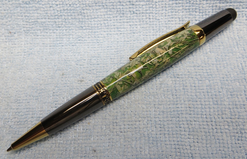

After wet sanding, I went through all 9 grades of Micro Mesh wet, then polished it with Meguiars PlastX plastic polish. There were a couple of small voids in it, but they disappeared during sanding. It polished out really nice. But you can see that the money shreds did get thin, and it's a good thing I reverse painted and colored the epoxy.

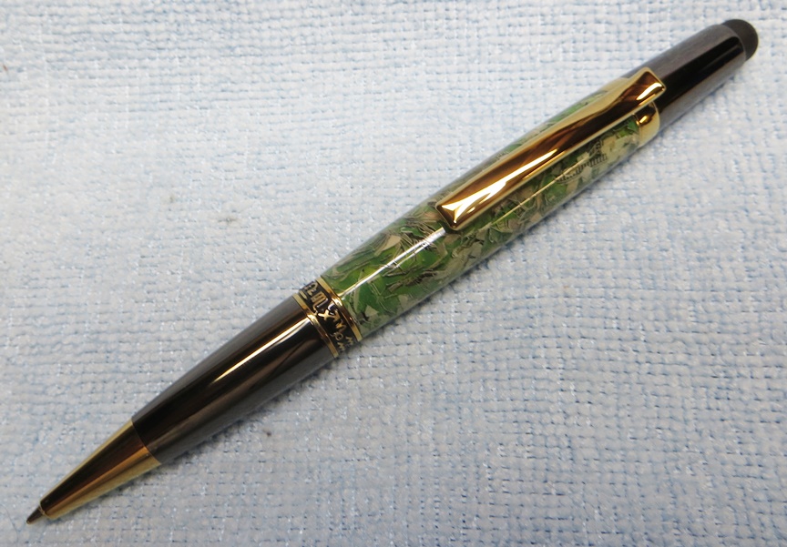

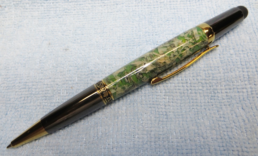

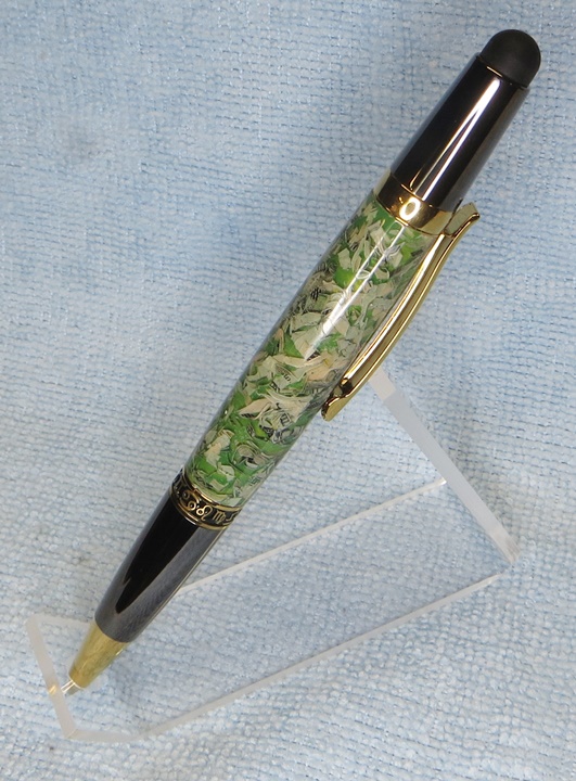

Overall, I'm very happy with how it turned out. It took me about three times longer than normal to turn the blank. Hanna will be ecstatic. She wanted a "money pen" really bad, but I told her I couldn't turn acrylester. Do I feel a sense of satisfaction and accomplishment? Most definitely. Do I like how the pen looks? Obviously. Would I turn another money blank? Hell no! LOL
I gave the pen to Hanna yesterday. She was beyond overjoyed! I knew she'd be happy, but I didn't think she'd be as happy as she was. She was totally surprised, she thought I wouldn't be able to make it (and I didn't either). It was worth all the effort.
