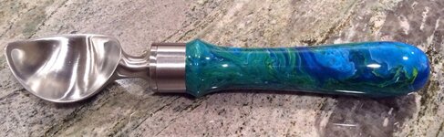

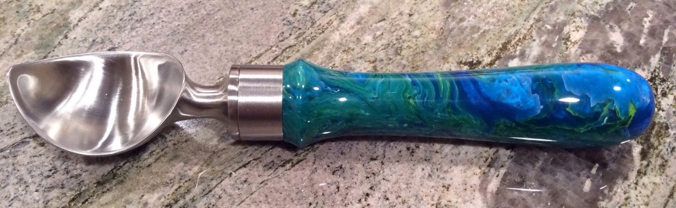

Here is a pic of an inlace ice cream scoop I did over the holidays.
Beautiful!
