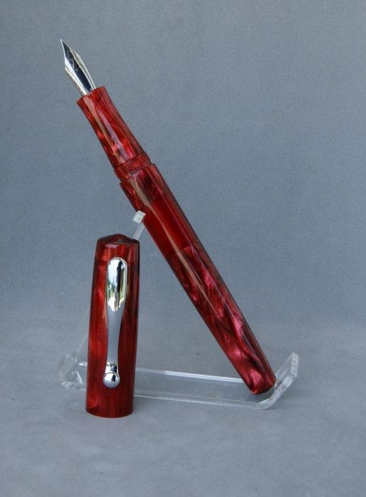

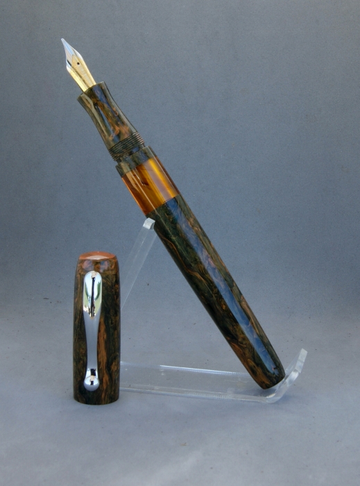

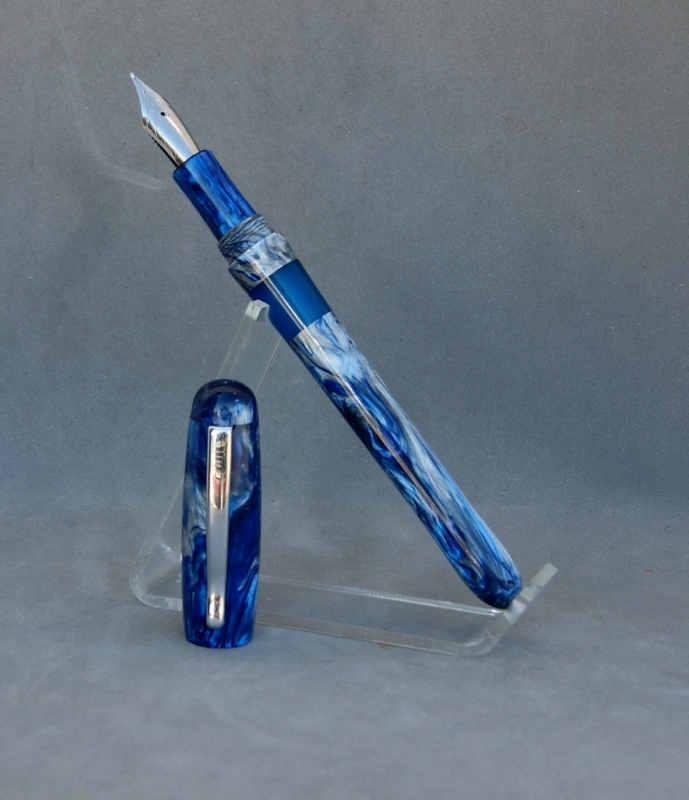

I thread mine together and glue in place with epoxy (prior to drilling!). Bear in mind your drill hole sizes and pick the appropriate threads so you'll leave ample wall thickness. I personally like to use 11mm threads. The reason for drilling when it's all glued together is so all the interior holes line up. I learned that the hard way after I couldn't get my converter to fit inside and didn't know why.
