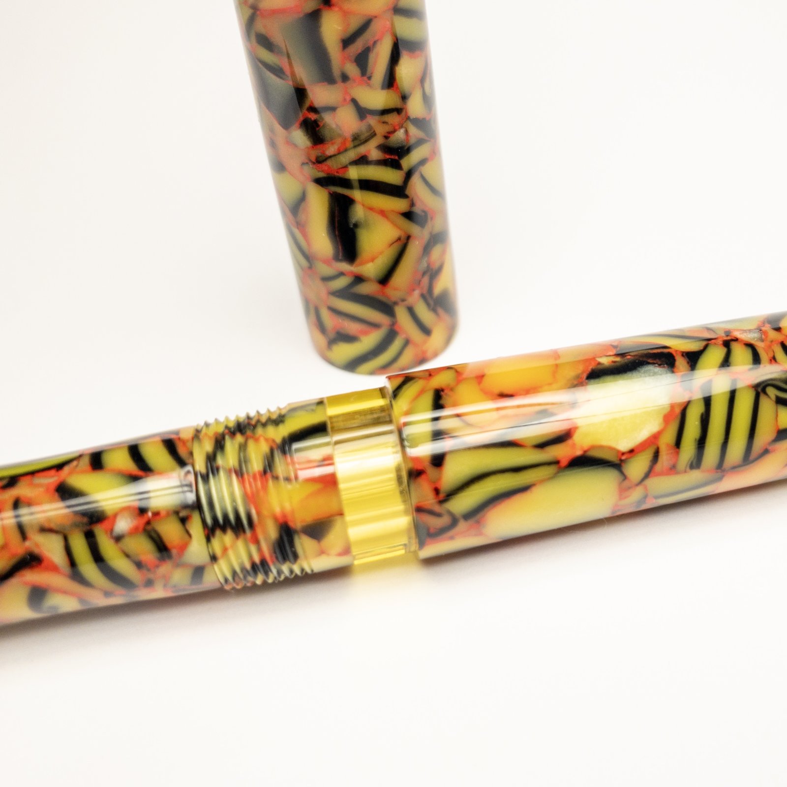

One thing I have been working on is an ink window. I really like how this one turned out. I like it when the ink window is hidden behind the cap but can present some challenges sometimes with having enough material to work with. I think I got it figured out. This pen is fitted with a lacquered black #6 bock nib. Thanks for looking.

Man, that looks like it was really hard to do! Spectacular work, very inspiring.
Did you convince Mazzuchelli to make you some custom acetate in pen blank size? Love that blank.

Very well done Jon!
I think I can see the window going over the front part of the colored resin, right? But I cannot see the glue...

The pens definitely do look better without them but it is so much easier not having to unscrew the body when you want to see how much ink you have in the pen or of you are almost out. Thanks for your comment friend.

I made the ink window by making tenons that were threaded on both sides. So it hides everything under the opaque material. here is a better picture of the ink window.

Really great work, Jon !!! . Your precision is very impressive !!
What are the specs for the threads on the end of the ink window, please ? . Thanks in advance.
