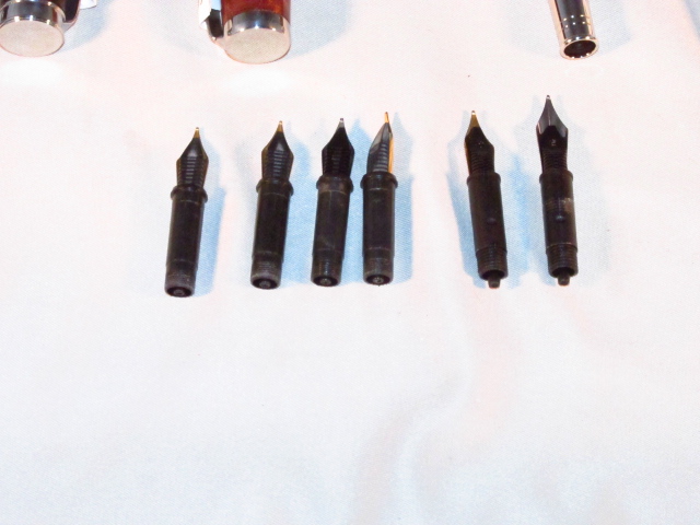

Attached is a picture of several feeds of fountain pens I have completed. On the left are four identical feeds from two Optimus Desires, a Raven and an Eagle. On the left are two from a Jr. Gent II and a Magnetic Vertex. Notice the extended nipples on the two on the right. The threading on the two styles is also different, making them non-interchangable.
I am somewhat mystified by this because I include a converter with every FP I sell, and I have sold several Optimus, Raven, and Eagle FPs in the past, with this never having been an issue. It's an issue because I lost a sale this past Saturday at the Knoxville market because the customer wanted a converter to go with the Optimus he wanted to buy, but I couldn't get one to fit.
I am going to direct Constant to this thread so he can look into it. In the meantime does anyone out there know if there are feeds available that will accept a converter and are compatible with Optimus, Raven and Eagle. Alternatively, are there different brand converters out there that are compatible with Optimus, etc. Many thanks to all for your inputs.

I have never been acclaimed as the sharpest knife in the drawer or fastest swimmer in the pool. This thread I initiated is a good indicator why. I talked to Constant a couple of hours ago (fantastic gentleman by the way), and as our conversation progressed, my dim bulb began to glow more brightly. I was trying to fit a Schaefer converter into a Schmidt nib feed. Duh!! Hopefully my embarrassment will be of value to other members here. BTW Schmidt converters are on my shopping list.
