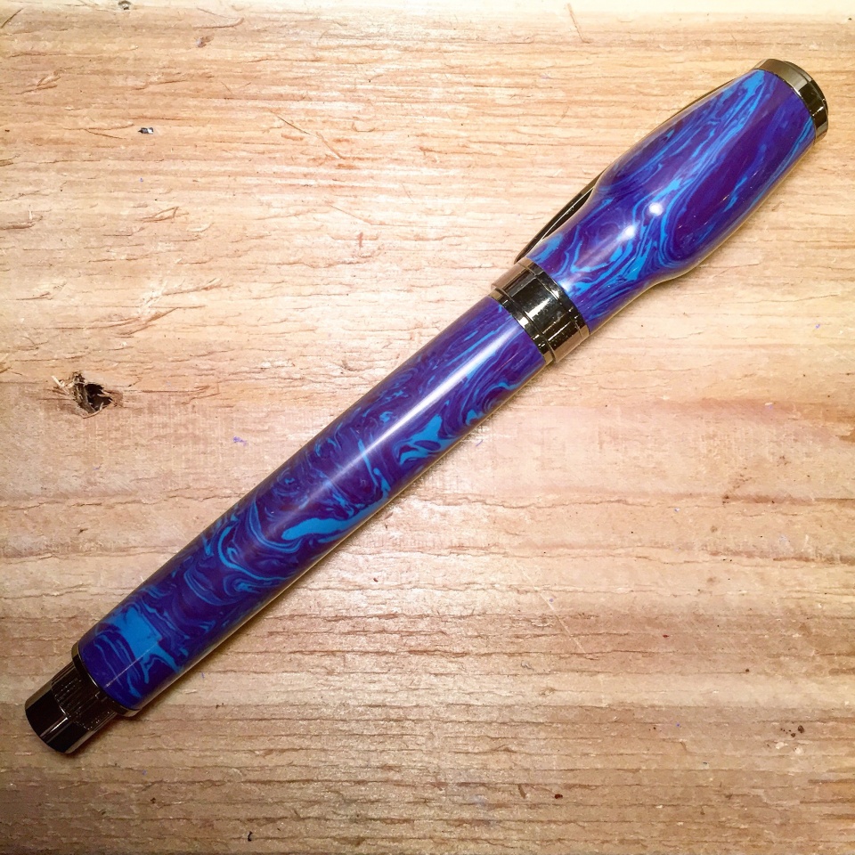

Turned this one out tonight. It is an Indigo Night Amalgum-mutt blank with a gunmetal Graduate Magnetic Rollerball kit. I made this to donate for an IG/FB auction where the proceeds will go to the Fallen Dallas Police Officers. Still trying to find the best way to finish these amalgum-mutt blanks. I really want a brighter sheen. My typical sand through 12,000 grit micro-mesh at 500rpm and the using some plastic polish just doesn't seem to get the sheen like other acrylics. Suggestions? Should I put a few coats of thin CA glue on it and buff that out? Thanks!

Hmmm--it does sorta look like a matte finish. I use your recipe for all my acrylics (a buffing wheel rather than plastic polish being the exception) and they all come out great. I don't know why your idea of CA wouldn't work (kind of a pain, though).

Provided that your finish is scratch free, Lee.
The Thin CA won't hurt, just means that you will need to give the upper Grades of Micro Mesh another go.

Try wet sanding through 12000 Micro-mesh at FULL speed. That is all I do on these blanks. Plastic polish and buffer will add to the shine but I rarely need to do this step.
Eugene.
