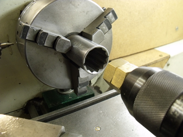

So here is a quick way of drilling 12 indents around your faceplate flange.
I simply used a large socket in the headstock chuck and a matching nut ( or bolthead ) in the tailstock chuck. The socket has 12 possible positions for the nut to engage in, so use one at a time to drill the flange with a centre drill. I think it's rare that anyone would need more than 12 indents. I use mostly 3.or 6
Nuts and sockets aren't exactly precision parts and naturally you will need to allow for the backlash slop. This is easy to do. You could clamp something to one of the jaws, like a pair of visegrips or a small G clamp or better still, the old school way of tying a string around the chuck with a weight hanging on it. The point is that the slop is always taken up in the same direction.

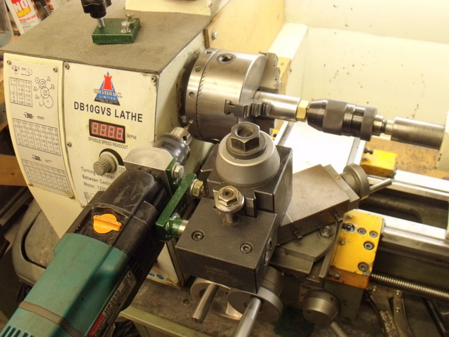

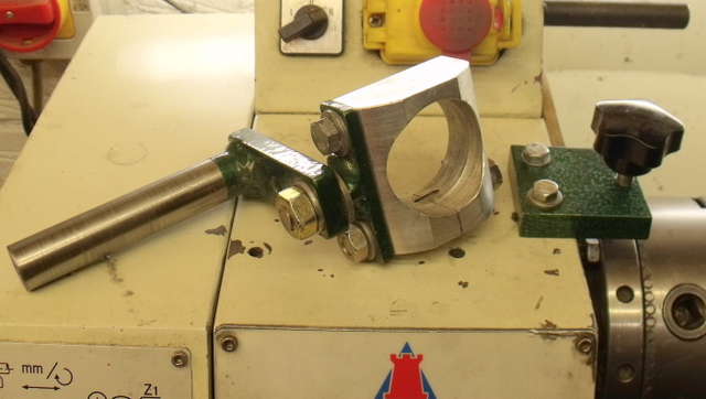

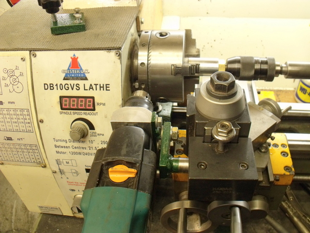

In the pics you will see two items painted mostly green. One is obviously the clamp to use when doing index work and the other is a clamp to hold the drill in the toolpost. I made mine and it is articulated and can hold a router too. You can buy these holders from places like LMS.
The carraige is locked in position and the cross slide used to advance the drill.

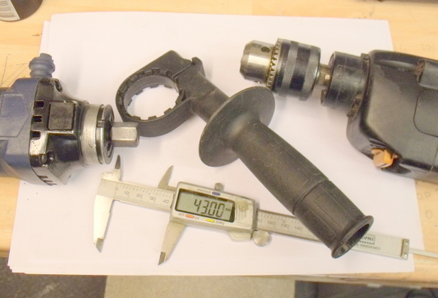

Well...after a bit of digging around, I found that 43mm diameter is a standard size amongst the biker fraternity. Google 43mm Fork Clamps and you get many options. This one looks good and I may even get one or two.
In fact, on the Ebay page, there is almost every conceivable diameter you could think of, incase your tool isn't 43mm..
I can't find a bigger version of the Proxxon clamp unfortunately...sorry
It even has threaded holes to bolt a bar that can be fixed in the toolpost.
Another option, but not my favourite is to use the plastic handle that comes with the drill. Easily modded to work but hey, it's plastic....:wink:
