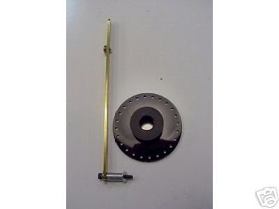

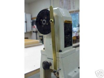

I have an indexer for my Jet Mini that I got off Ebay last year but have not used it yet. It basically is an arm that hooks into an existing bolt hole on the bottom of the Jet mini and then has a delrin disc that screws into the headstock wheel and provides indexing capabilities. I can photograph it and post if needed. Not sure who produced this.

Here is the picture. The Ebay usere was jrbeall from bealltool.com and don't know if they ever made these commercially available.
<br />
<br />
I'm gonna have to get mine out and try some inlay with it.

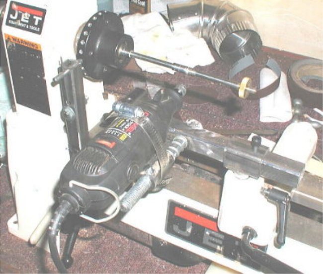

this first one is being made using the face plate that came with the lathe. I have drilled index holes in it and am making a bracket with a spring loaded pin. Also a part that will fit the tool rest hole and hold a drill.

Update! Got the first proto type 'bout done. Learned a couple of things in the proccess. I had to turn the face plate around because it crowded the end of the mandrel. Will also have to make the rods and guides on the tool 'slide' a little closer tolerances, too much play for my liking, but a good start. A drill was too big, so went with the Dremel.

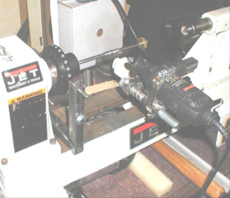

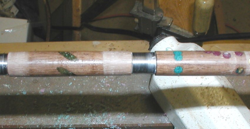

Paul in OKC
Jul 26, 2004
3,094
Oklahoma City, OK, USA.
Another update. Got to play with the indexer a little a couple of nights ago. Here's a pic. There is still some tinkering to do. Biggest issue is working space. Gets a little cramped. This pic also shows what happens when you miss count your holes[:D] thee are a couple of more pics in my gadgets folder in the photo area. Thanks for looking.
