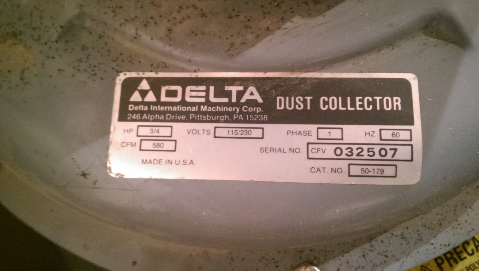

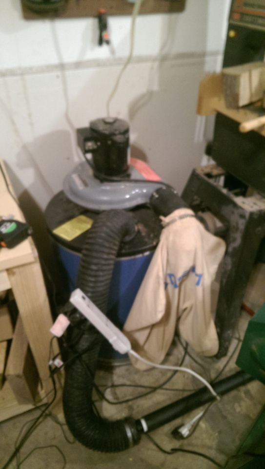

I was just given a Delta dust collector. See pictures.
1. is there a safer / better bag I can get? Both the rockler and woodcraft locally did not have any micron filter bags. I'm trying to improve the dust and air quality.
2. do other people with a dust collector like this use a dust collection hood from the store or buy one and how do you attach the hose to your Lathe?
3.do most people with a dust collection system like mine move the dust collector around the shop as needed or do they hook it up to a system that runs throughout the shop?

I don't know that system but, the bag if washed properly will work like new...!
I don't think the unit is powerful enough to be set in one place and have all the hoses going through various other location in your shop, you may get better results by using it close to each machine you need to use, you are only going to work with one machine at the time so, for a small system like that, you get better results that way...!

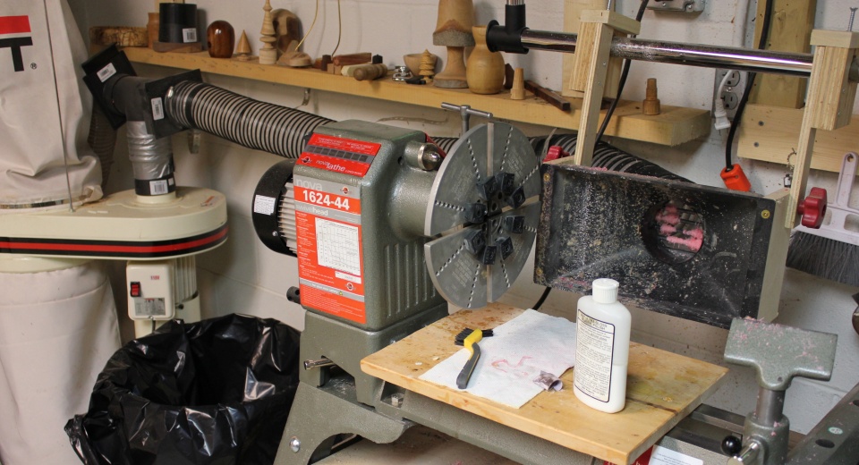

Hi Ethan.

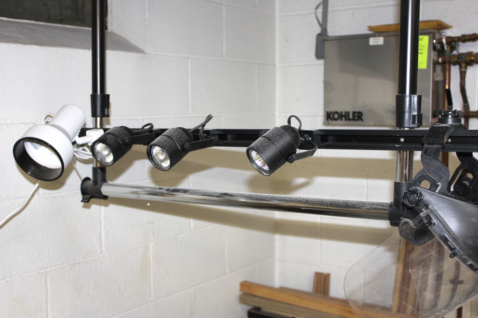

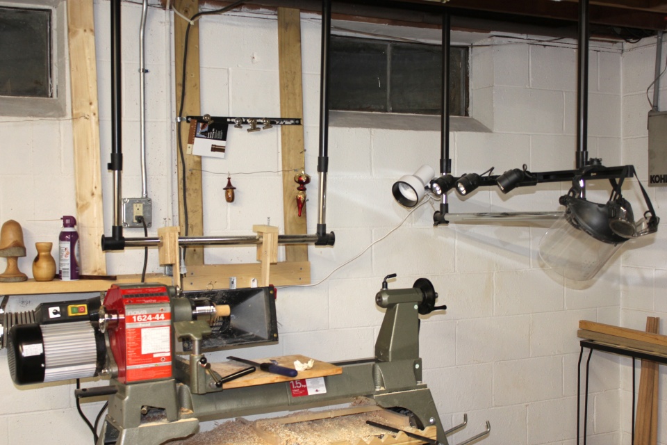

I made my lathe "hood" myself. It is actually suspended from the ceiling and I can adjust it up/down, left right, angle, etc... The rack was a cheap (new) coat rack I bought from ALDI's ($9.99).

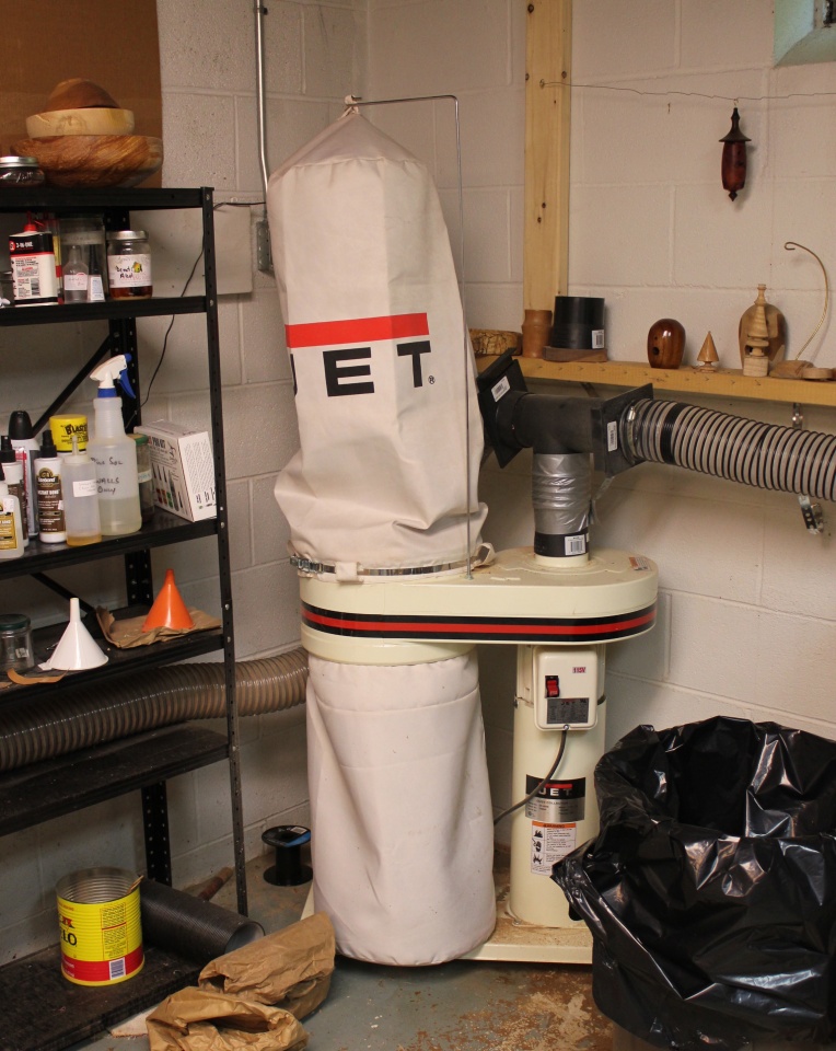

I also think your unit will not be powerful enough. I bought my Jet ( I think it's 1 HP, and wish I had bought the larger (1.5 HP). I use in between 2 lathes, with ports. So it may be losing suction as it is 5 ' away.
Busted window; sounds familiar. I put one of the "full Window" fans in mine to vent the entire basement just like George said). But I may do what you're thinking and use it for a more efficient use.
I also made a second rack for adjustable lights.

This is mine. Magnets on the base hold it in place and a 4" adapter connects to the dust collector hose. I may make another one slightly narrower. the floor piece will stop a bit further back, and the right side will stop an inch further back.
