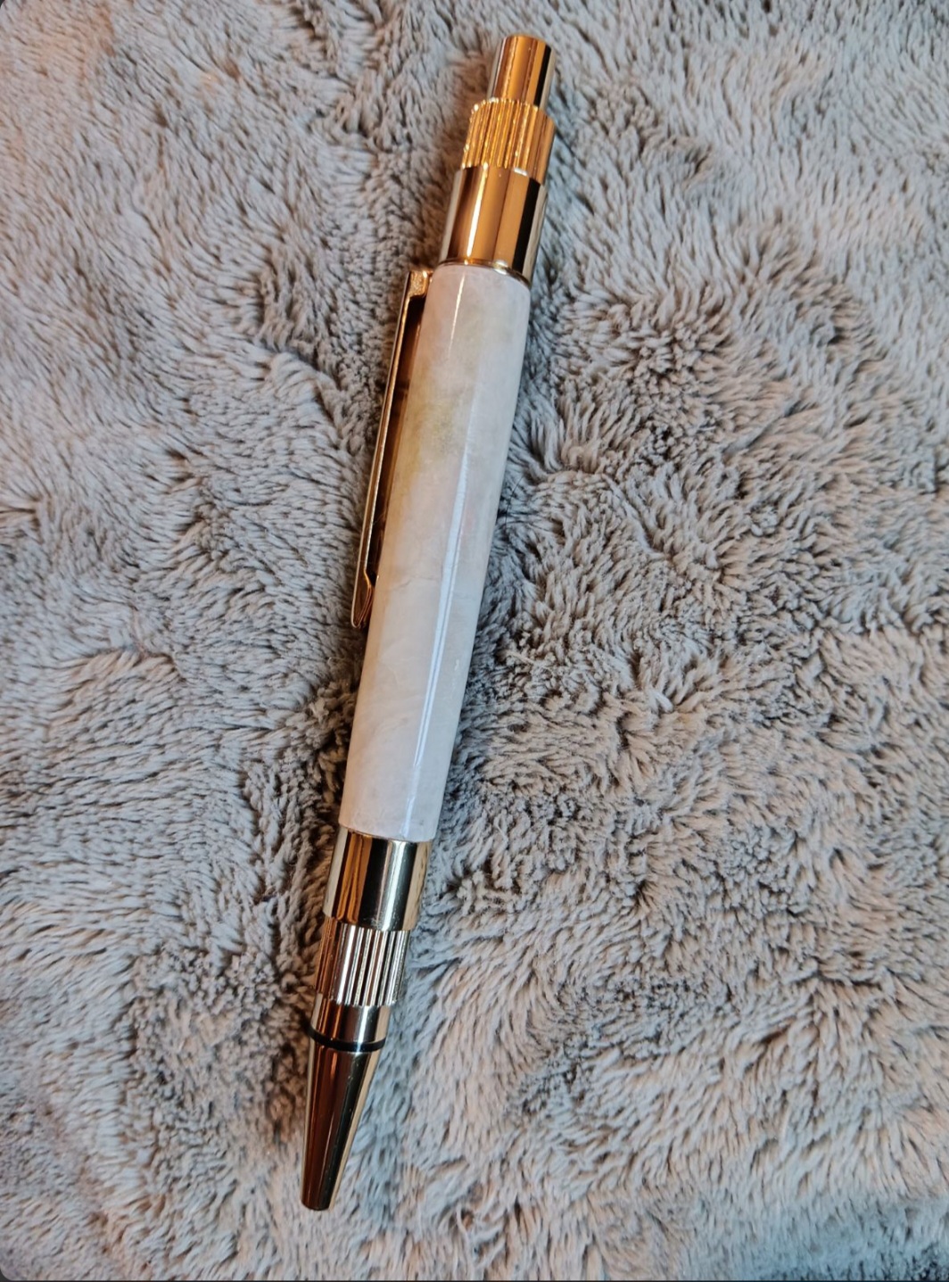

I think i had a great picture, but I failed to advance as well. I actually did find the alabaster too.
I think the newer pics with more light look better for sure and it looks shinie, while the darker ones show off more of the grain. I found the ones I think I will do well in I do terrible, and the terrible ones end up winning.

I like yours as well! Mine was tied for last place.
You were only tied for last place in your group. Mine was last overall with a whopping 7 votes(šŸ˜¢). To be fair my photos were not great and the pen was underwhelming compared to the others. I had done some other small turnings with some of this wood and the grain colors really popped in those. Was disappointed that there was not much character/color in the pen.

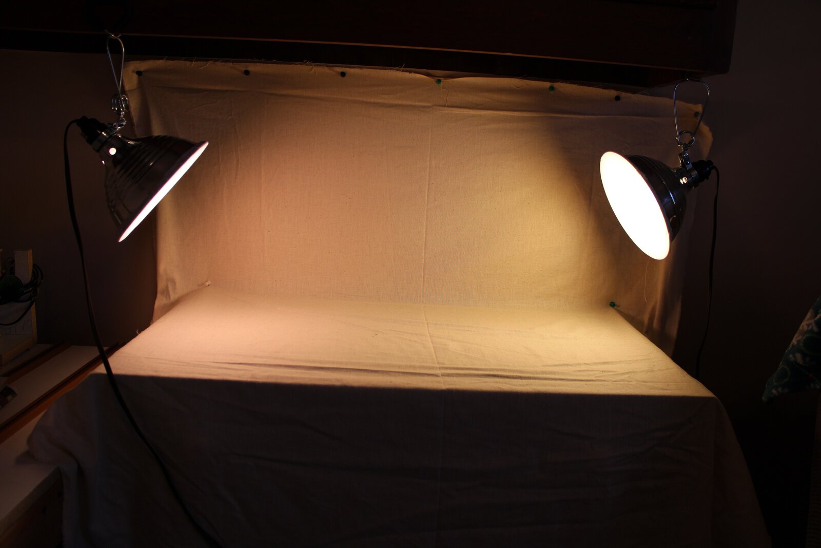

I got into photography about 5-1/2 years ago. Here's what I use for pens and flies. Two clamp on lights from Harbor Freight, curly Q bulbs and cloth diffusers made by my wife. I can move the lights on the doors or frames for the best effects and eliminate glare.

The new Bulbs I bought are really bright and create hard shadows when shined directly at subject. We have a white ceiling in the room where I take my photos so I point the lights at the ceiling and bounce the light down to illuminate the area I am photographing. This give plenty of light and creates soft shadows.
I can move the lights around to get the effect I like.
