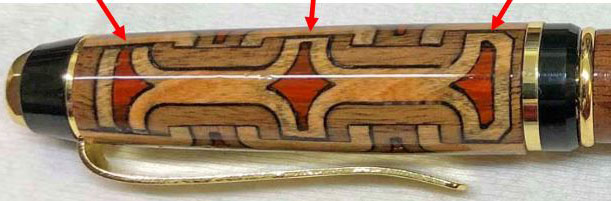

First, a picture of the other pen that points out the distortion from the taper.
Note how the Cherry border around the Padauk inlays start ok at the center band, get narrower in the center, and then are virtually gone at the cap end.

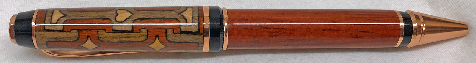

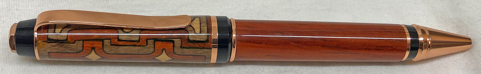

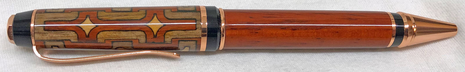

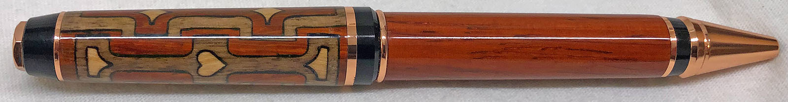

These are the pictures of the 2nd pen with a blank that was adjusted to compensate for the taper.
Note the borders around the Cherry inlays are more uniform all the way from the cap end to the centerband.
