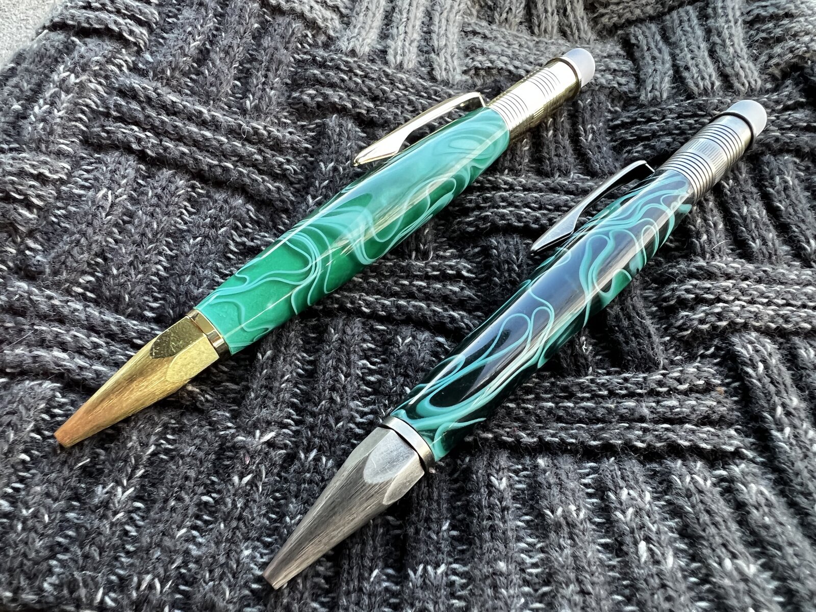

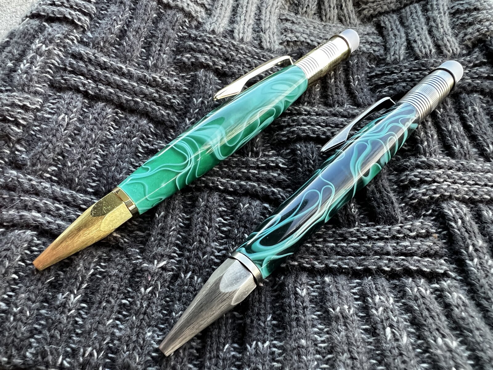

These two pencils are made from the same blank. I painted the interior drill hole with a thin layer of basic rattle can spray paint (one white and one black).
Many beautiful acrylic blanks are translucent. If you paint the interior of you can massively affect the look. If you don't, the brass tube may very well show through. This can be a desired look, but more often than not it will detract from the blank.
Why not just paint the tube? Because there will be a layer of epoxy/glue between the tube and the blank that may end up being visible.
Anywho, I thought this visual would be helpful to newer turners (like myself). I first saw an example of the effect on a yellow blank in a Youtube video of a demo done by Mark Dreyer. That guy is awesome.

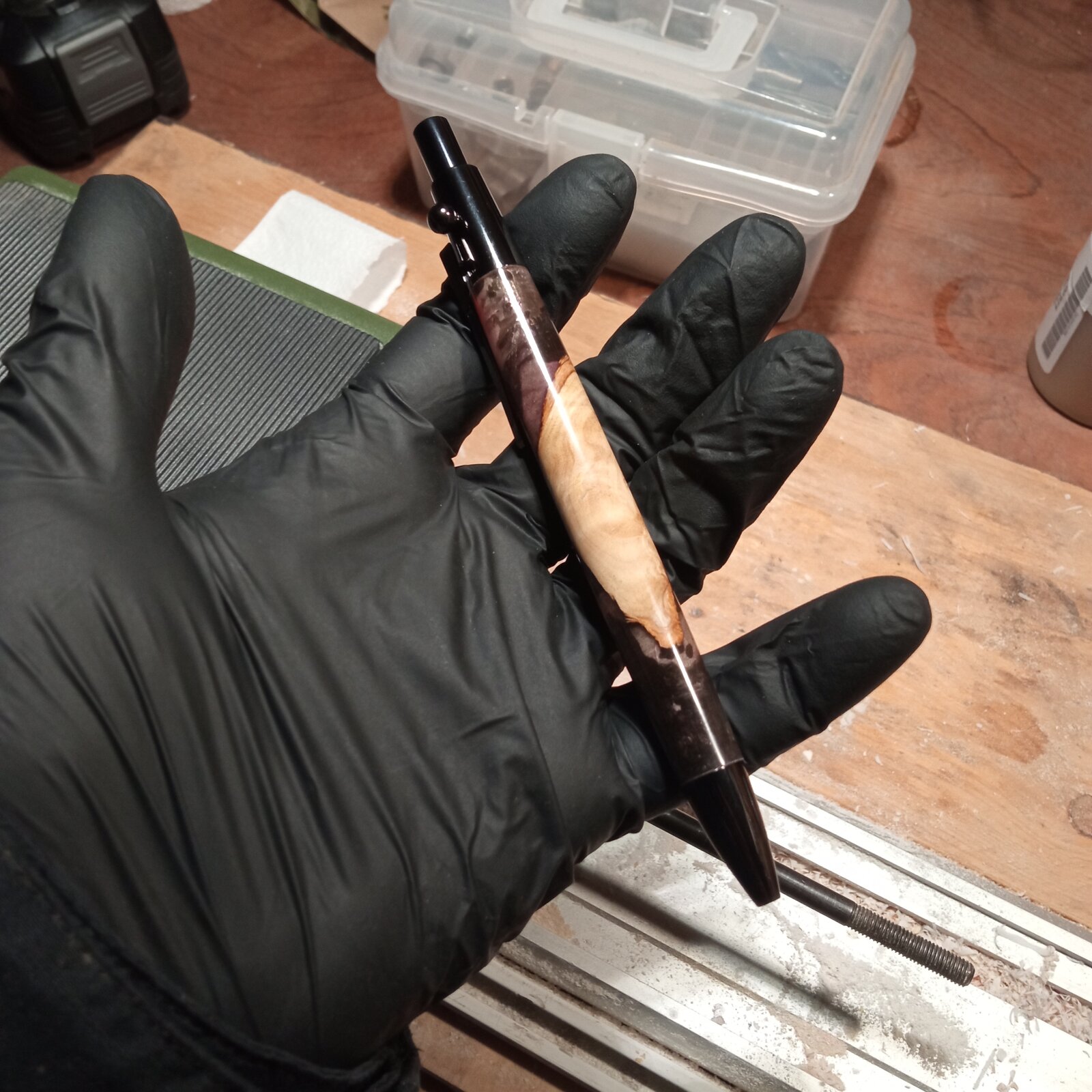

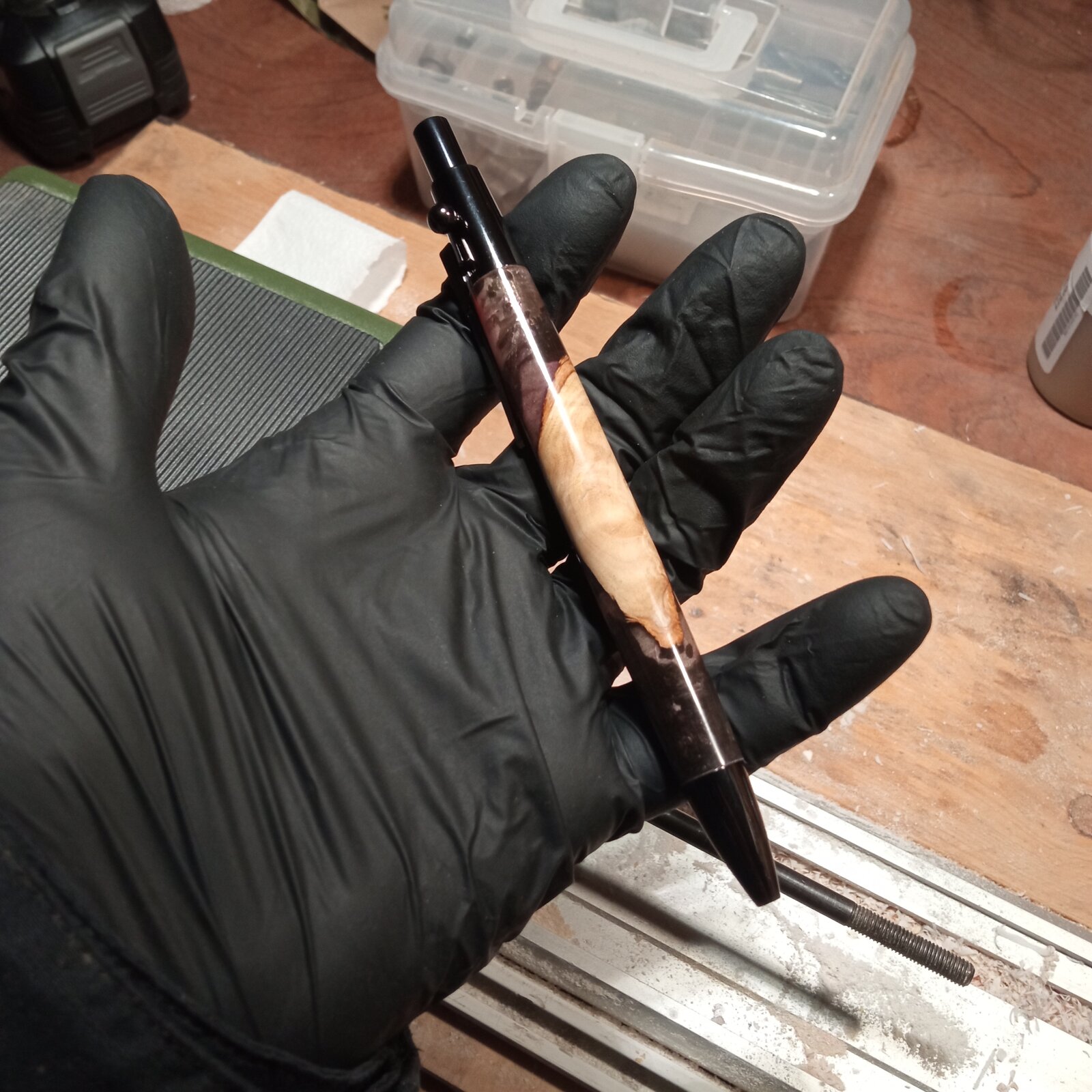

I wish i knew that a month ago or so. The pen on the left has a painted black tube and the pen on the right has a painted white hole, as well as the tube. The left pen is a disaster as the epoxy glue is visible which makes the hybrid pattern look awful. The right pen is much better although i did not achieve the pattern i was looking form. Note that the white coat is more visible at the ends where the epoxy is thinner. The epoxy has a light blue pigment that works well with the white undercoat. If the undercoat or the epoxy had a more dark colour (like the black pen on the op) a whole different pen would result.
Just a note for us beginners, cheers everybody.

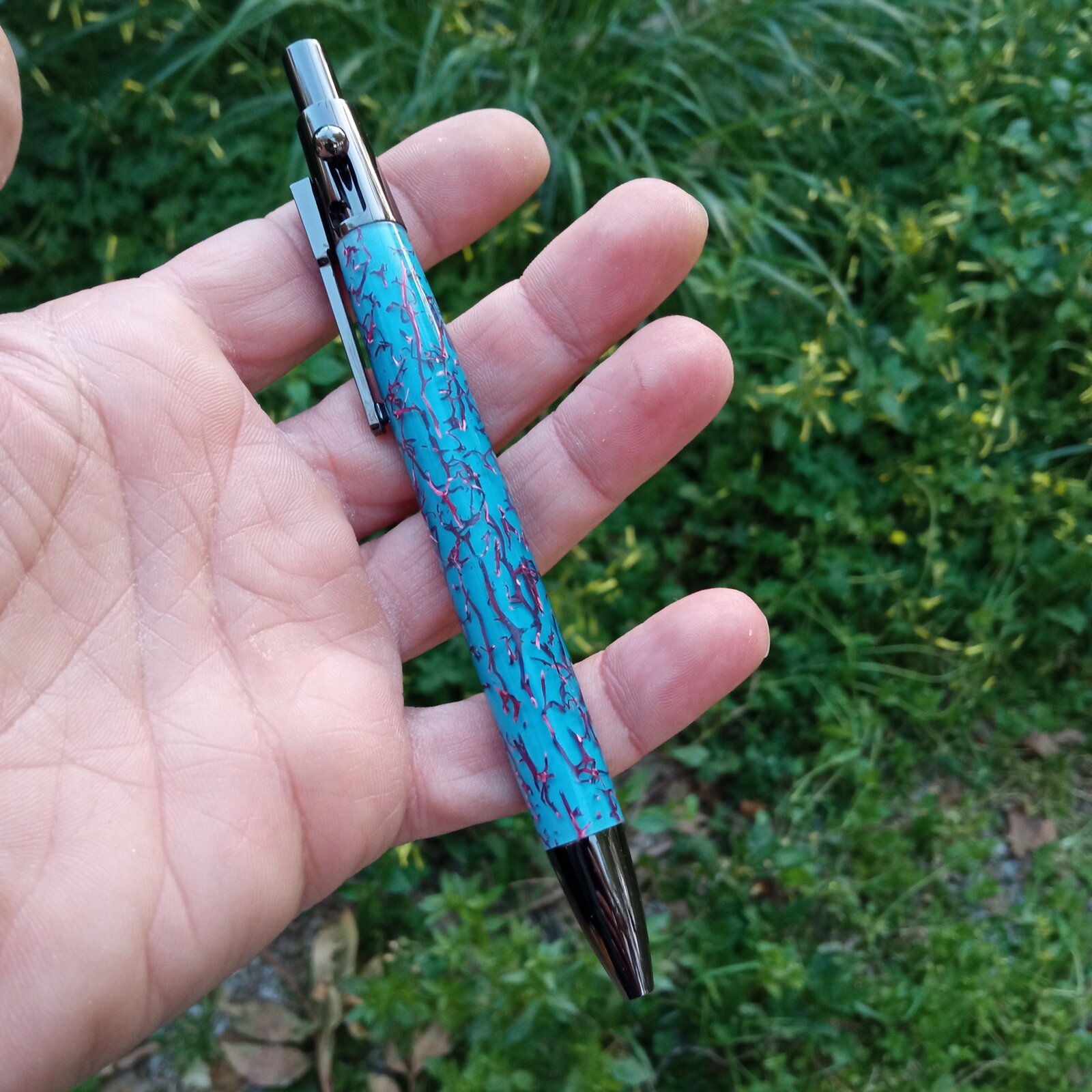

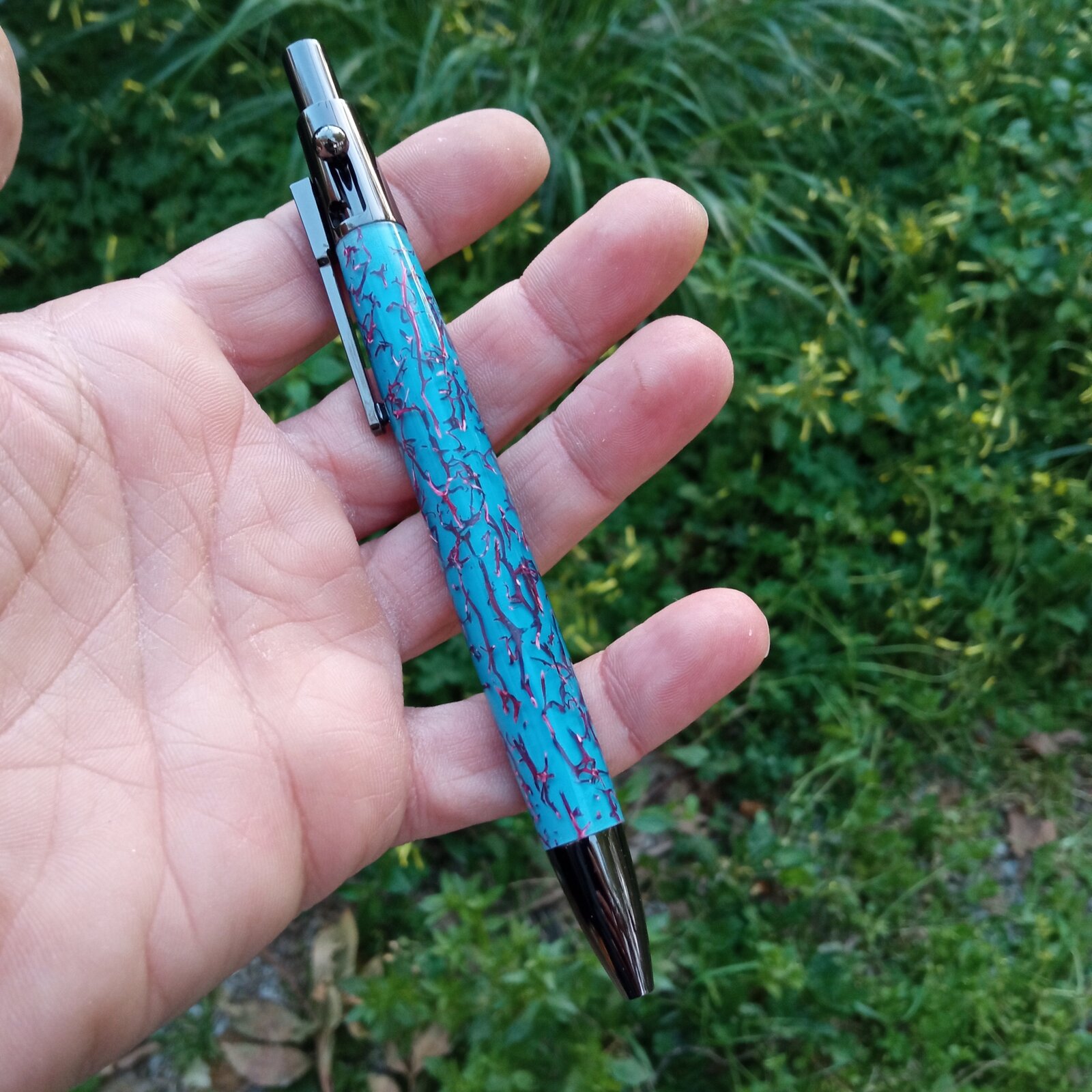

As Hank eluded to in this thread I did show an example of different colors used on a blank. Here is another example I did several years ago. Same blank. One on the left is painted in black and the one on the right is white. Have done this a few times over the years. Painting the blank is best to get full effect. As someone brought up getting glue between blank and tube really is ugly. Works well. S
pray is easiest but small brush or q-tip works too.
