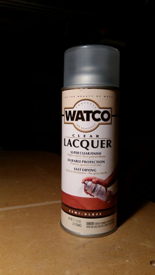

The guy in the paint dept. at Lowes said they just got this in. You all may already be aware of it but I wasn't and I'm at Lowes so much they are concerned I will have my mail forwarder to them. I'm using the semi-gloss spray on a large plaque I'm making for a lady lawyer and so far it looks pretty good. It comes in gloss for sure and flat I think. Dry time could be an issue for pens, about an hour under good conditions, and the fumes will cause flashbacks to the 60s for us older folks and a recent trip to Denver for the younger ones so have lots of fresh air available. Anyone else have experience with this stuff?

Drys fast but needs to cure for a week or so before using a buffer. Lowes stopped selling Deft lacquer and started carrying the WATCO brand. When I use lacquer I use it in a can and thin it with lacquer thinner...50-50. (half lacquer and and half thinner). I apply several coats with a soft cloth.

I've never use it, but from what I've heard it's good stuff -- but as has been said, and is probably true of all lacquers, needs time to cure before any rough handling (buffing). I'm currently using both the rattle can (Krylon) and / or 50/50 Deft with good results.

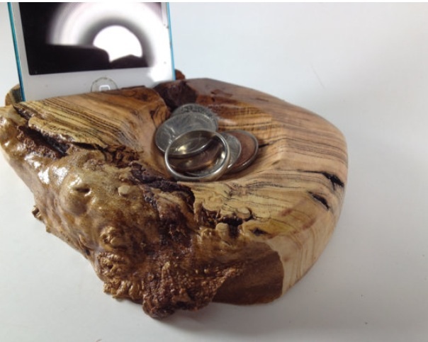

I've gone thru about a dozen cans so far....our local Lowes switched brands about a month ago to this....though it is no different than the old brand. I love it for my burl pieces/desk sets(see pic). I use 6-10 coats. It covers all the holes and divots well. It dries fast(vs dipping), and there is a strong odor. I'm not so sure I would ever use it on pens in place of CA....just too small a piece to get a perfect finish.
