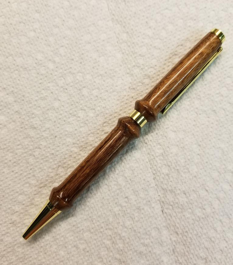

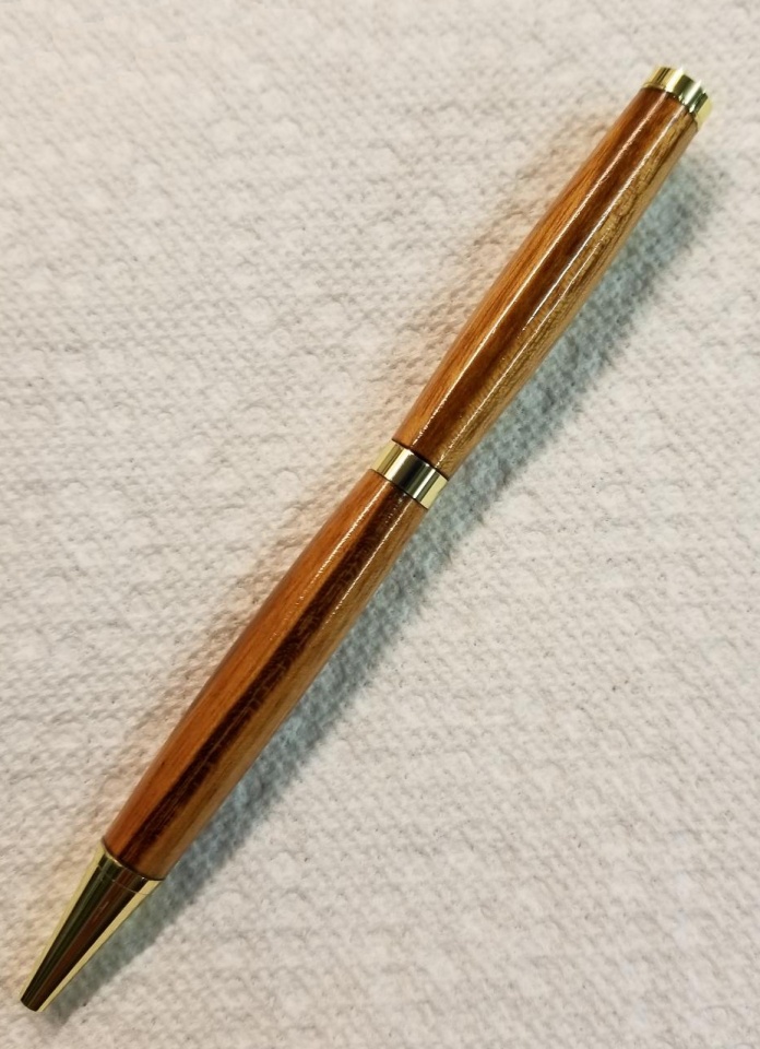

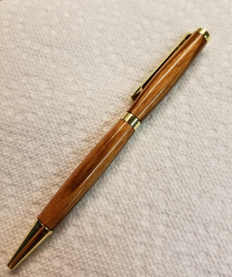

So I tried one today. Lol I turned 3 pens today. This one shown is 1 of the 3. I dropped my bottle of WTF last night and it exploded across the floor. So I turned these pens and was just gonna put them up until I got my 2 new bottles in from the bay. Of course, they are slimlines as that's all I do right now. A couple have some hills and valleys so I didn't mess with them. But I did do a nice slim slimline. So this was my first experiment with CA glue for finishing. I put 2 coats of thin and 4 coats of med. I did use activator between each coat. I then MM from 4000 to 12000. I then put a McGuires plastic polish on it and buffed it out. Don't look too bad. The pictures aren't showing the shine as much as I'd like. So I may use this from time to time but I still like my WTF finish. What ya think?
Thanks for looking, Bobby

Very nice and I like that you kept the shapes slim. That was the way that kit was intended to be presented thus "slimline" The CA finish is a tried and true finish and yes it has its faults as do every finish on the market. many times operator errors are the cause. They do make odorless CA so if that is what bothers you you can resort to that and get good results. Weather buffing out on a buffer or MM it can work out to a beautiful shine or you can dull it down as much as you prefer. That is the beauty of that finish. Good luck as you grow in this hobby.
Thanks John! My smeller doesn't work like it used to so the ca doesn't bother me at all. I've done a couple slims with slimlines but I still like changing up the shapes once in a while. Makes it fun for me!

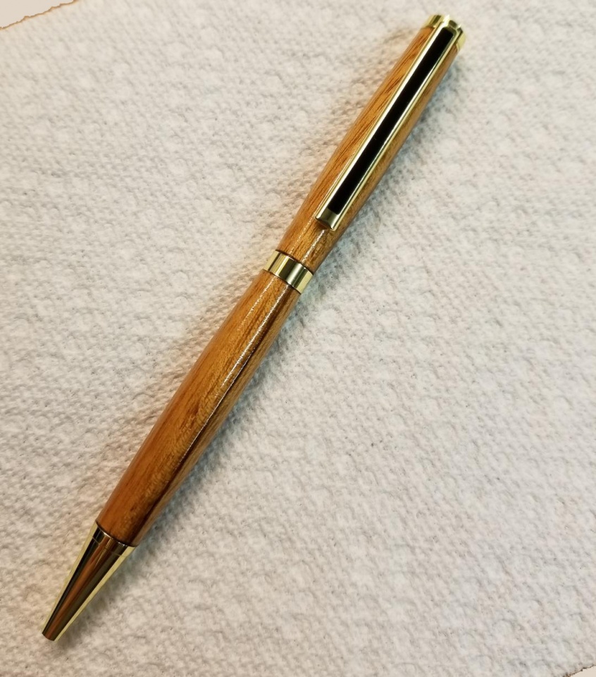

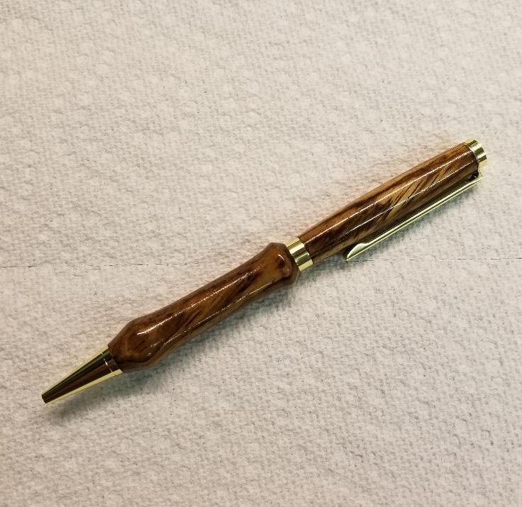

Well I know these next 2 will disappoint John, but here are the other 2 I turned today. The 1st on is Morado Wood and the 2nd one is Zebra wood. I decided to do a ca finish on them too. I think I'm getting hooked. Lol

They do not disappoint at all. They are very nicely done. Many people add different shapes to pens and some out of necessity because easier for the person to use if they have problems. The key is you are doing your own thing and you will define your tastes with the product you produce. No one here can tell you what is right or wrong because there is no right or wrong. Comfort level in a pen can play a role though when designing. I am in the camp of bushing to bushing is my preference. I let the blank and kit define the pen.
Keep up the great work. :smile:

Thanks John! I hope you know I was just pulling your leg. Lol I have a few straight line slimlines but everytime I show a friend what I'm doing, they love the odd designs that I add to some of them.
Thanks for sharing your pics and process. You will find what works best for you and to your liking. Thanks again.

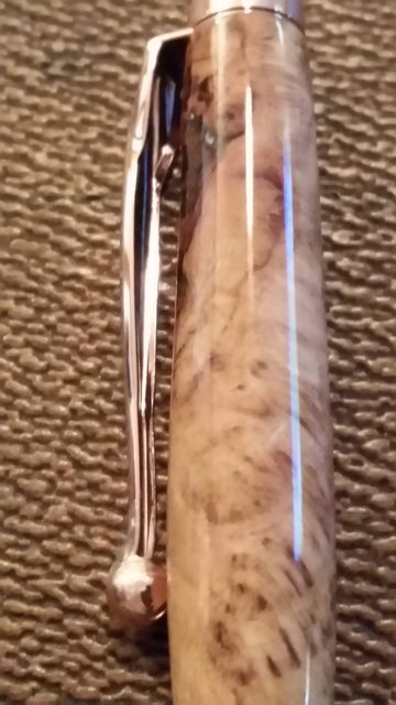

. . . . I then put a McGuires plastic polish on it and buffed it out. Don't look too bad. The pictures aren't showing the shine as much as I'd like.
"Pictures showing the shine": There are several reasons for shine showing up or not:
- Camera, Camera angle, type of light, diffuser on light, distance etc. This is something to concentrate on down the road a bit. Making pens is the important thing for now. Great pens!
Yea I hear ya Lee! I photograph coins and have a pretty decent camera setup, I just don't pull it out to take the pen pics. Lol
