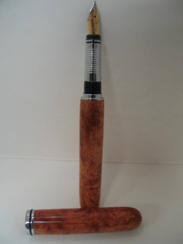

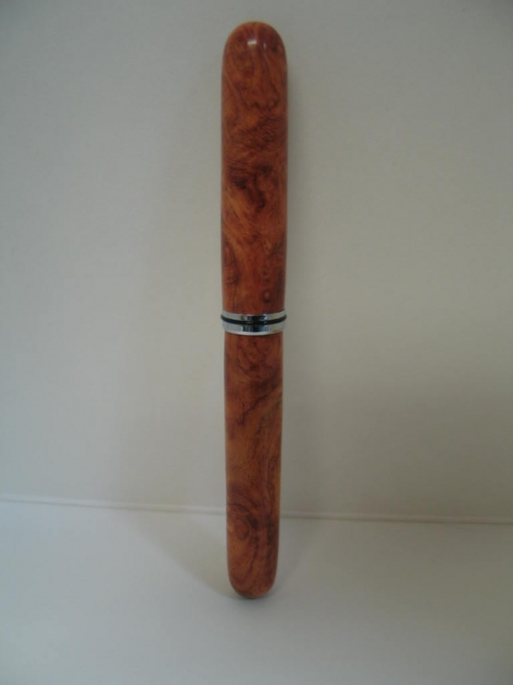

I made my 1st double close end fountain pen(Jr Gent1), not my best work but very nice IMHO.
The issue is I cannot get the pen to lay down ink on the first stroke after it is capped for a few hours. I've adjusted many times and results are the same. So Being it is not a removable nib, I changed out the entire front section from a known working pen. After a while the result is the same, maybe it need a good cleaning. After a good cleaning and making sure it is writing again, same results. I'm running out of indeas Please HELP:confused:

The pen is a double colse end made from Amboyna
Looks nice.
Ok, so my guess is the open end of the cap has got a brass tube glued into it, and the threaded coupler pressed into the tube end.
Down the far end of that tube you've got exposed wood. I think if you seal it things will improve.
That is a Heritance nib, it is from my known good pen. I screw it onto the closed end pen for testing(it's a whole front section and not just the nib), only to have it stop working after a few hours.

Ding Dind Ding Ding We have a winner!!!!!!!! I used the cap from another pen and screw it on for two days and it's still working:smile:. My guess is the unsealed portion from inside the close end cap is somehow evaporating or absorbing the moisture form the ink and preventing it from writing on first contact with the paper.
Now I just need to somehow seal the inside of the cap without buggering up the threads or making a entire mess inside. I'm thinking dripping medium CA and rotating around to spread the glue.
