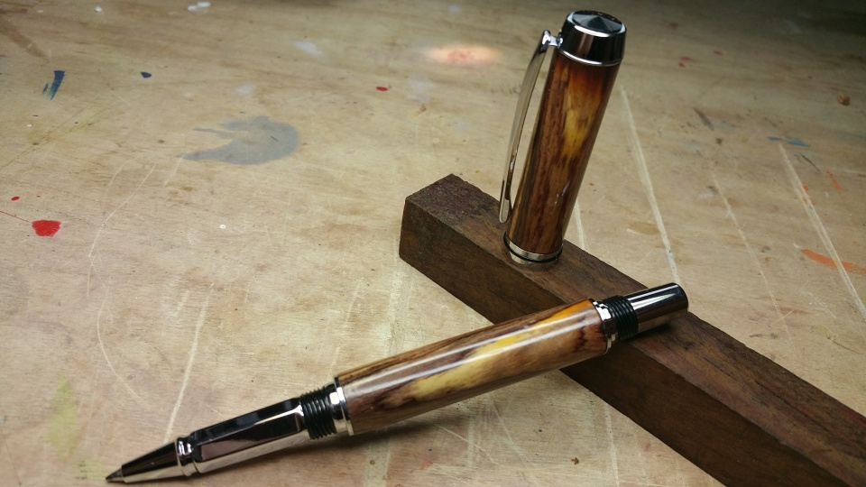

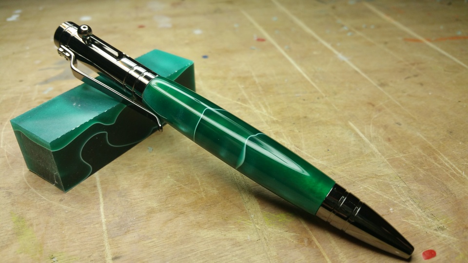

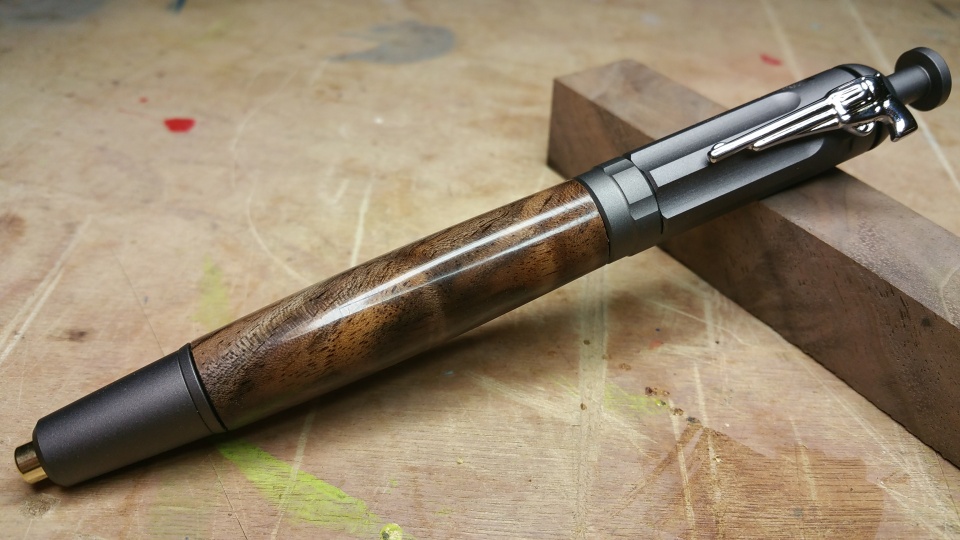

After dozens of kits (and hundreds of dollars), I finally arrived at a few pens that I'm pleased enough with to show everyone. I'd also welcome any suggestions for improvement on these. I tend to be my own worst critic, but all recommendations are welcome.
-Lever Action Tek pen in green acrylic
-Revolver in walnut burl
-Navigator rollerball in cocobolo
-Mark

They all look great Mark !! I don't see where you need any improvement, it's now time to step up to the next level. Segmenting, kit less, etc. Jim S
Those are perfect. Do you finish them with ca. If yes as you know it's a hard finish to master and yours looks perfect.

Fantastico!!
I love all of them, but my favorite is the third one, left to right. All Gorgeous! Great job!! A+++++:smile:
