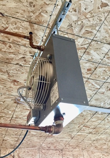

I heat my 635 sq ft shop with a small radiator heated by the demand hot water heater for our house. It switches from shop heat to hot water when needed and then back for the shop. The shop is comfortable even when it is -40C/F outside. The system could also work with an in-floor system too.
Here are a couple small pictures.

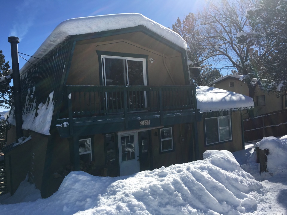

We got 30+ inches of snow in one day during the week between Christmas and New Years. Roads into Ruidoso were closed for a day (the day I was wanting to go back to the cabin) so I had to wait a day to check it out. I got stuck once and ran into 2 other stuck vehicles on the next 2 roads I tried to get in on, and finally managed to get to the cabin on my 4th try.
I may have seen that much snow at one time before, but if I have, I don't remember it. It was incredible, and I have to say that I know I have never had to shovel that much snow ever before in my life. I had to shovel the driveway out just so I could get my truck off the road.

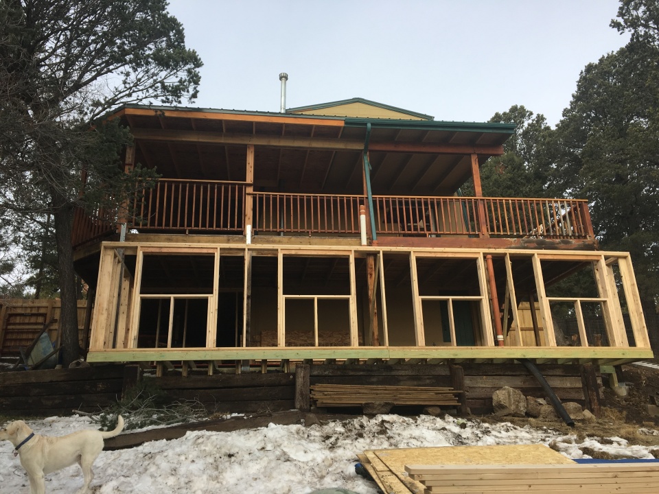

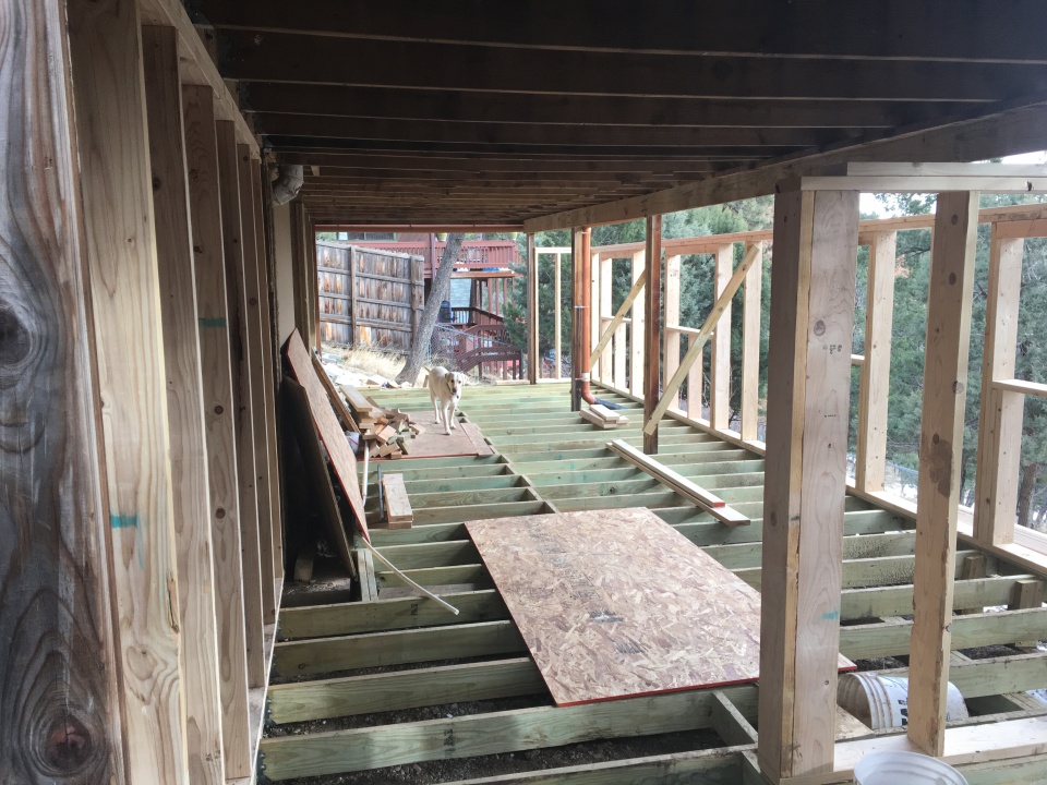

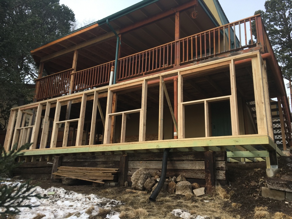

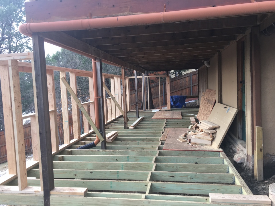

Needless to say, the snow put my shop construction work on hold for a while. Finally got some better weather and most of the snow melted after about a week and we got some more work done. I forgot to get pics the last day, but we got the walls up and sealed but still need the metal roof and siding, then the floor will go in.
I had to get back to civilization again and work on a couple of special orders that came in after Christmas. It may be a week before I can get back up to the cabin again because I have 11 pens to turn, 6 of them laser etched and 2 cigar band pens. Only one easy one. But it is a good problem to have...the shop project can wait.
Anyway, here are some pictures of the new shop construction.
