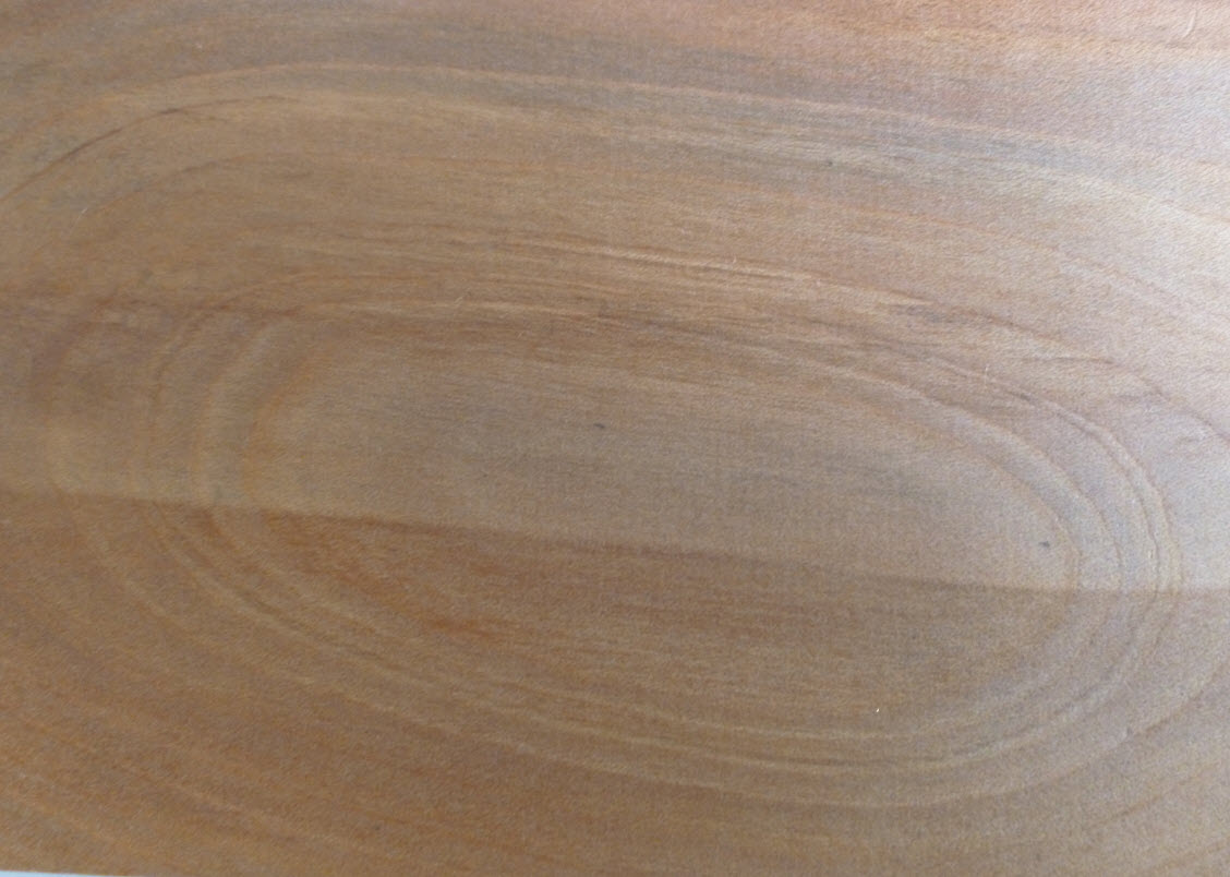

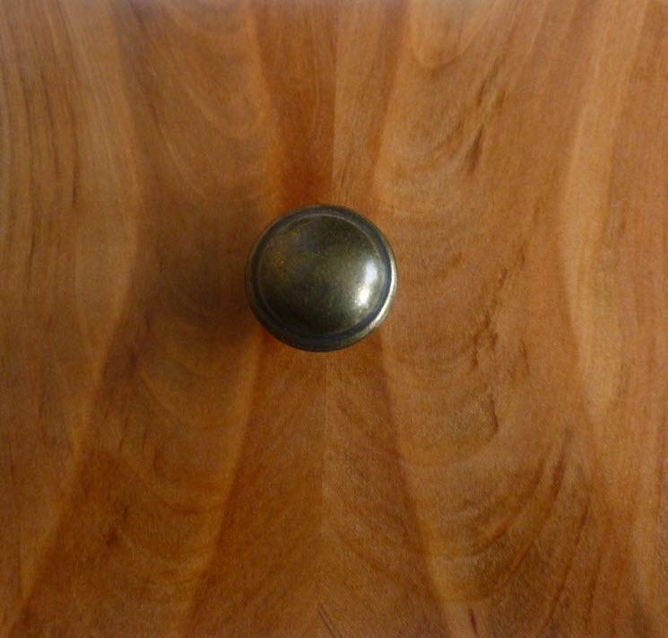

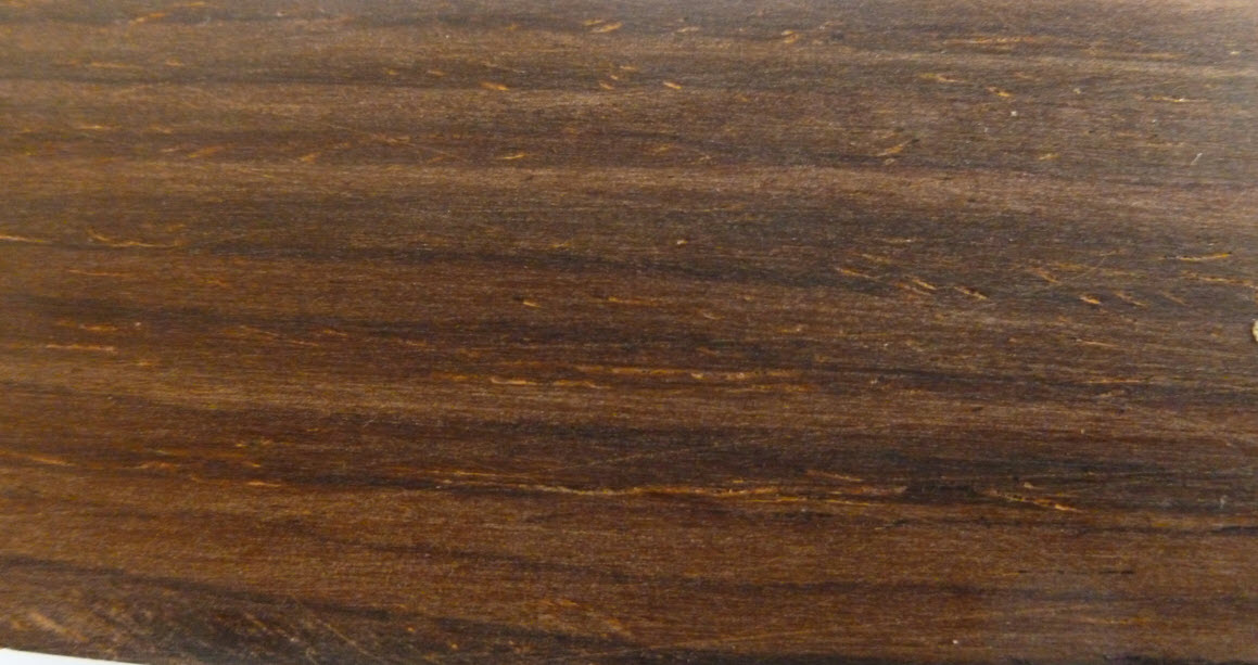

So my ask of you is "can you identify the darker wood in the attached photo?" It will make 4 blanks. I know what the lighter wood is because I cut it from a log. As you can see I made a box lid from it. I am trying to think where I can use the other piece in pen turning (5" x 2.5" X 0.25"). A shout out to anyone who can identify the species of the box lid.

Impossible to tell from your pic. Ask your neighbor. I'm sure he would be happy to tell you. Woodworkers love to talk about wood!
I can understand that pics aren't always accurate in color for example but it is quite dark. I did ask him but he said that he didn't know :(. He has so much wood that I think he forgets where some came from. I don't know where he gets half of his wood. I know all the well-known local suppliers and I have never seen most of what he has. I guess he must buy online. I meant to say that the wood is very hard and quite heavy but not heavy enough to be lignum vitae. I wonder if it's a kind of ebony. Maybe I will ask him again and see if he remembers.
I don't see any resemblance of any pictures above to what I know of Lignum Vitae, . . . which you mentioned, perhaps suggesting that wood might come up as somebody's suggestion. . . I know that LV is rather heavy, and can have a range of colours. . . Most of the LV I have seen has a slightly greenish tinge.
Thanks Mal. I have some LV and I agree it doesn't look like that.
Maybe Chechen? Does it seem to have some reddish streaks around the growth rings? Do you by chance have a UV light to check for phosphorescent properties? End grain can help ID it, too. Definitely agree with checking the wood database site.
Thanks. I checked the wood DB and Chechen looks like a pretty good natch.
I was thinking Chechen or Jatoba. I've obtained a lot of it over the years from hardwood floor guys. Jatoba has the dark streaks and heaviness.
