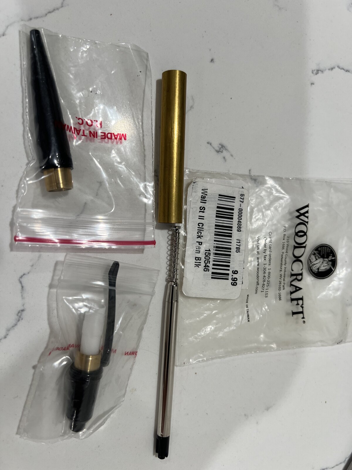

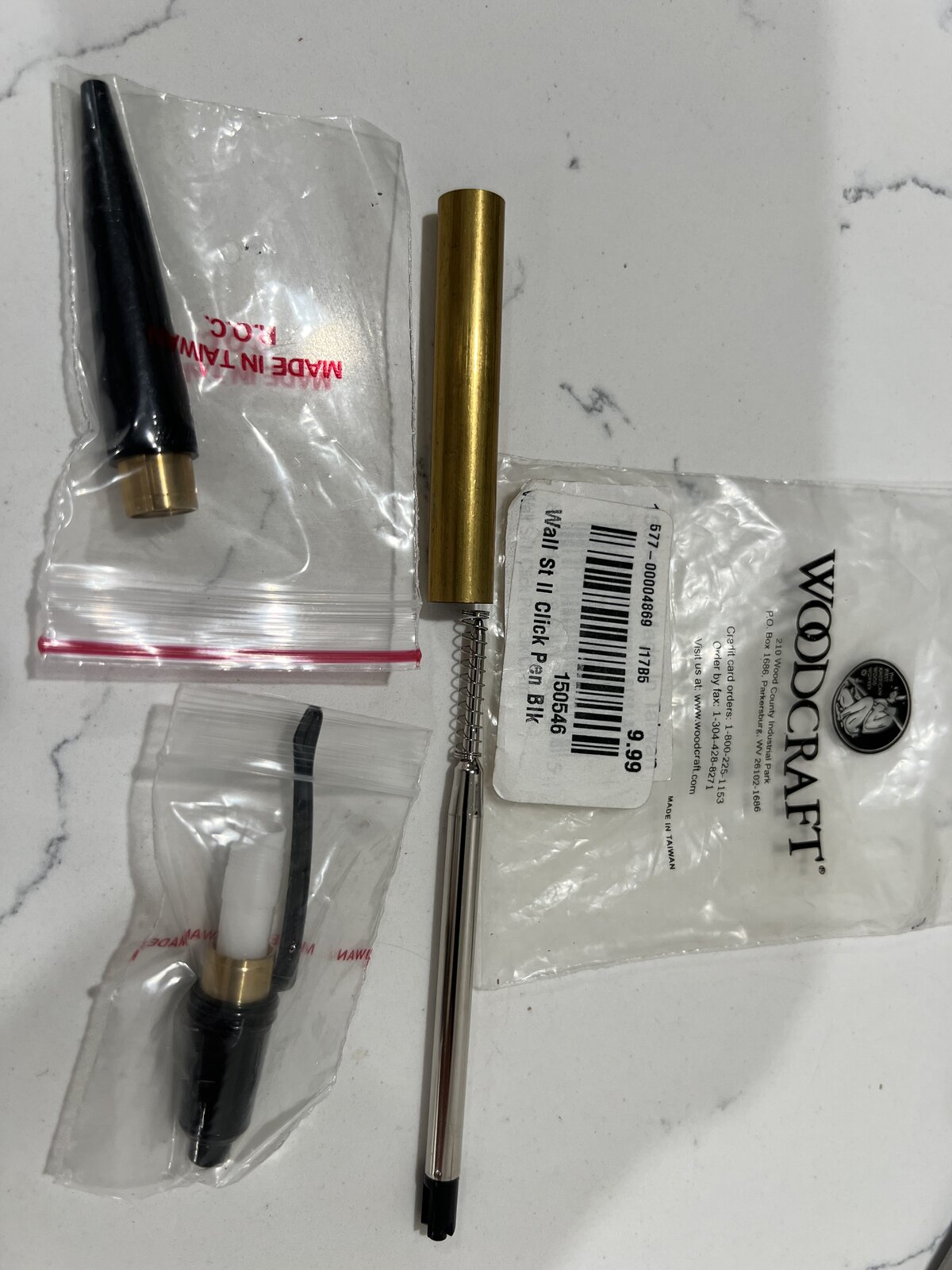

For example here is a picture of one that I wouldn't know what bushings to use
Thank you
Sammy

Sierra click pen. Woodcraft sells Berea Hardwood kits. The instructions will be on the Berea website.
If the Woodcraft label will peel off there should be a Berea label behind it.
Don

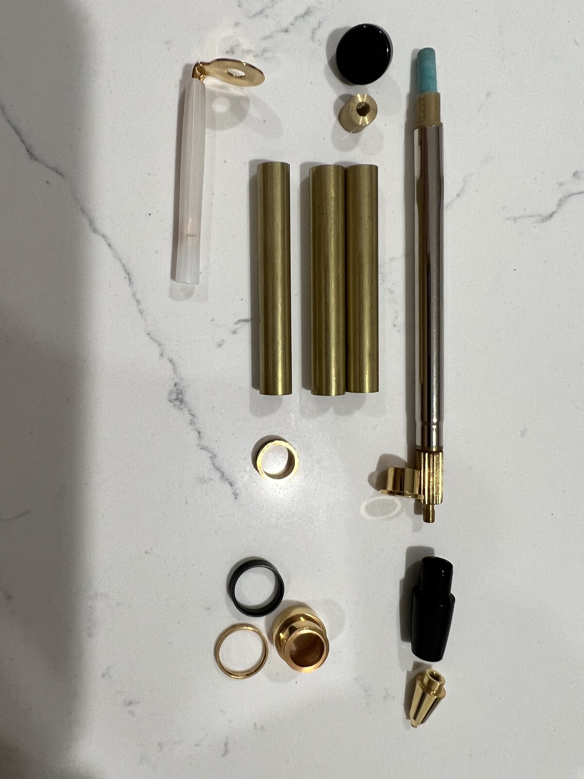

I have 3 Parker Pencil kits (picture)
I couldn't find any mention of part number at woodcraft or penn.
I am looking for bushings number or size and assembly instructions.
I got the API reference app but I can't figure out how to use it.
I would appreciate some help
If you can lay out the parts in the places they go when assembled, you could turn between centres and would not then need any bushes.

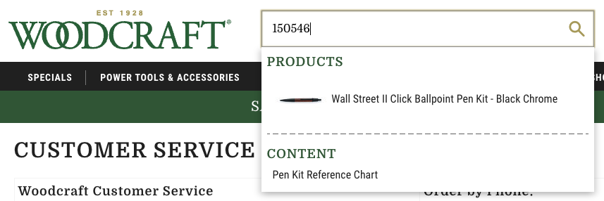

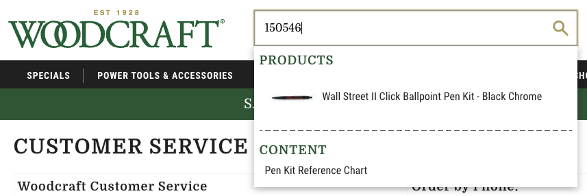

I'm having a very similar issue. I had a fair amount of luck on the Woodcraft site. They have a Pen Kit Reference page that is very comprehensive (includes drill bit size, product code for bushings, product code for the instructions, ...). Mostly, you can put the product code into their search bar and it will find it.
See attachment for example. Using just the product code, you get the pen kit page (which will include instruction and bushing info) and a link to the Pen Kit Reference doc.
Even really old kits seem to be in the Reference doc. Sometimes the link to the instructions is no longer active. ;-)

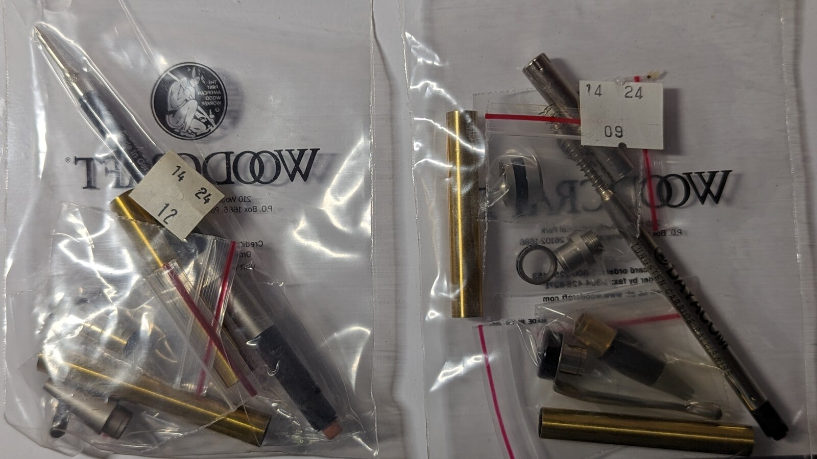

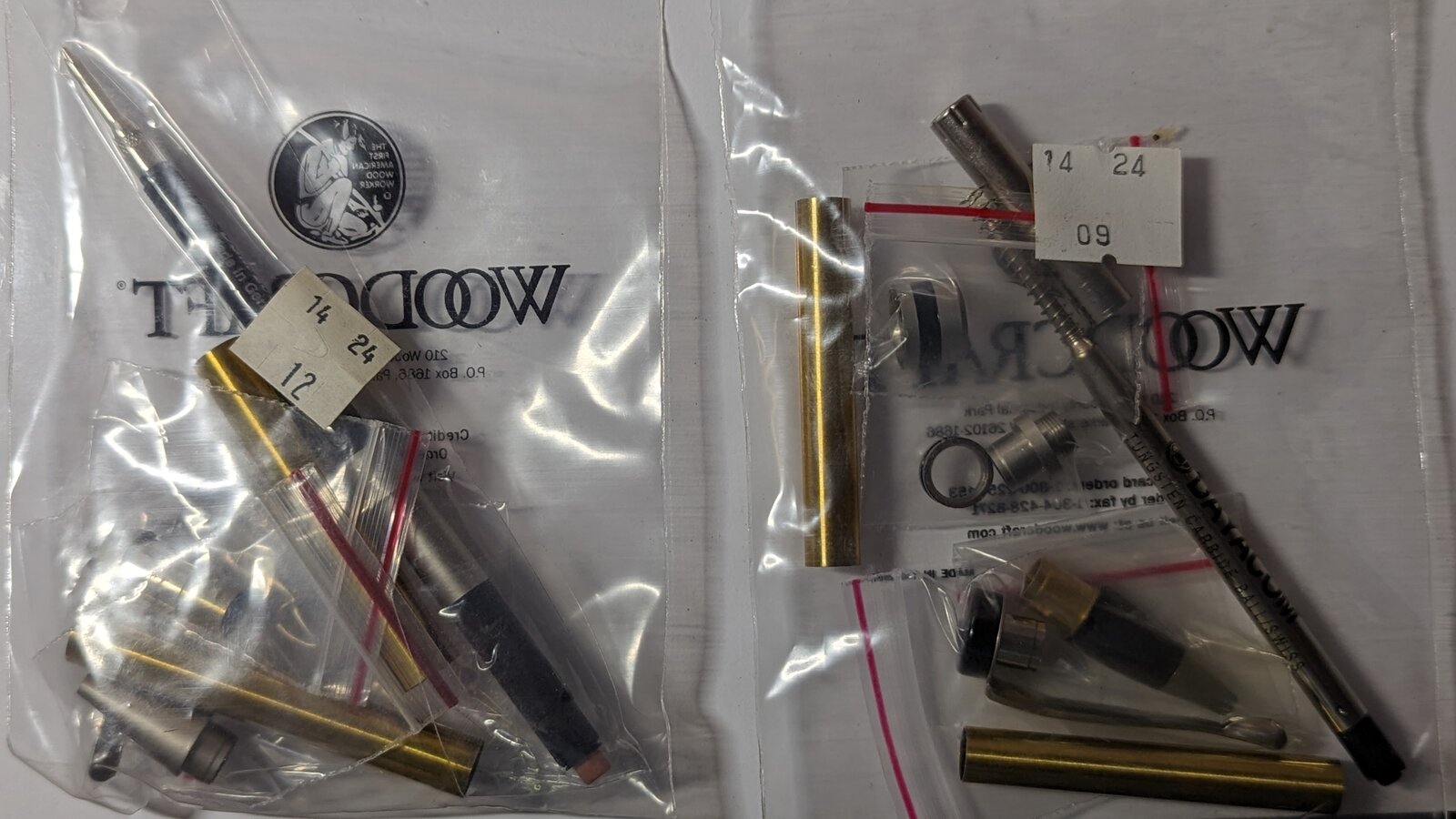

I also have some kits that don't carry a proper number, just a sticker that someone at the store/company _may_ be able to decode. I emailed this picture to our local WoodCraft and he had no idea (based on the codes). He suggested I bring them in and we could figure it out...
Millarde,
Thank you for the advice. I have many similar to your picture. I did go on the Woodcraft site and saw that reference document. I am trying to make sense of all that :)
I think it is worth the time to go to that store and talk to them.
I appreciate your help.
Sammy
