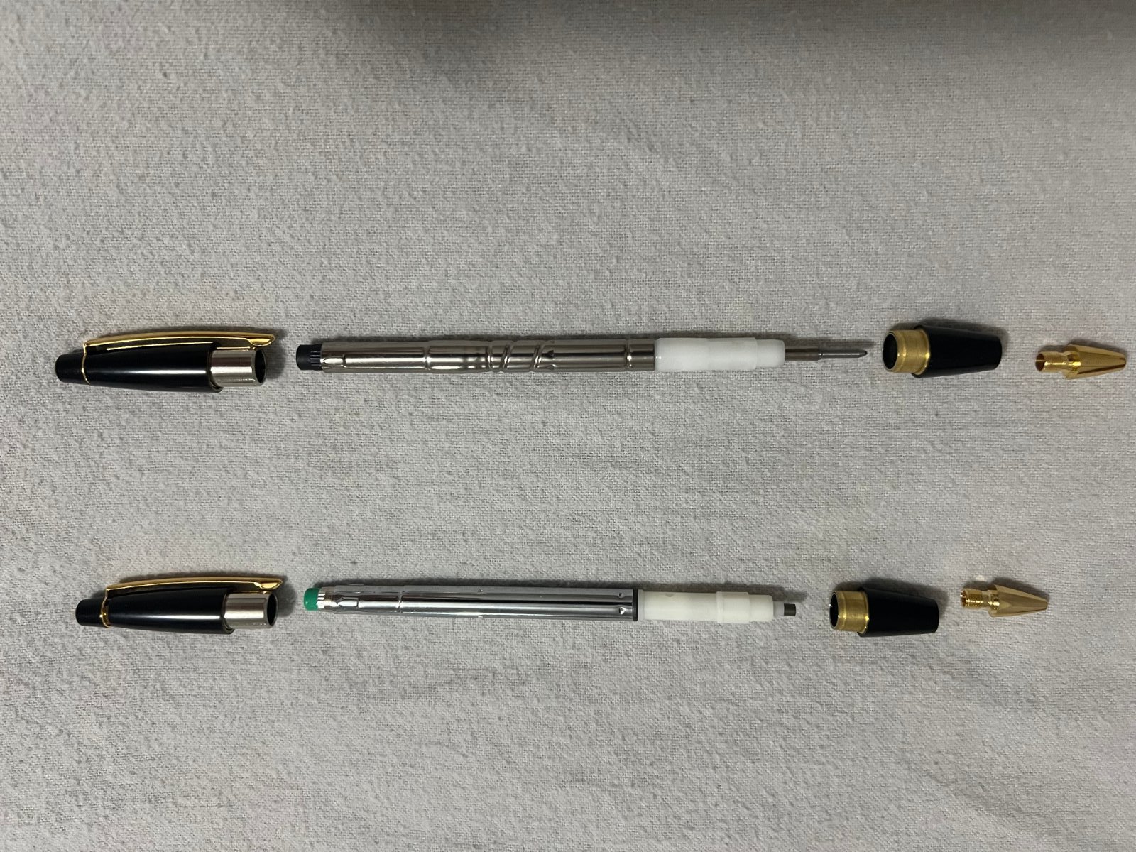

Hello fellows :)
I haven't posted in very long time. I have been so busy with the family and our 1st grand kid Noah :)
Please would someone help me by identifying these kits? I think I am only missing the tubes but have no idea what they are.
These are very old Woodcraft kits that are no longer available (I think).
Please help me if you can.
I would really appreciate it :)
Sammy

The only thing I can tell you it looks like it was a single tube combo kit pen and pencil. One is a pen the other is the pencil. If it was a woodcraft kit here is a link to all woodcraft kits of all kinds. I tried looking for combo kits but had no luck. If you do searches on them most do not come up any more. Good luck. I suggest if you want to try just do a caliber measurement thing on components and figure out the tube size and length needed. Other wise they belong in the lost and found box and I have a large box of those. LOL.
https://www.woodcraft.com/blogs/woodturning/pen-kit-reference-chart

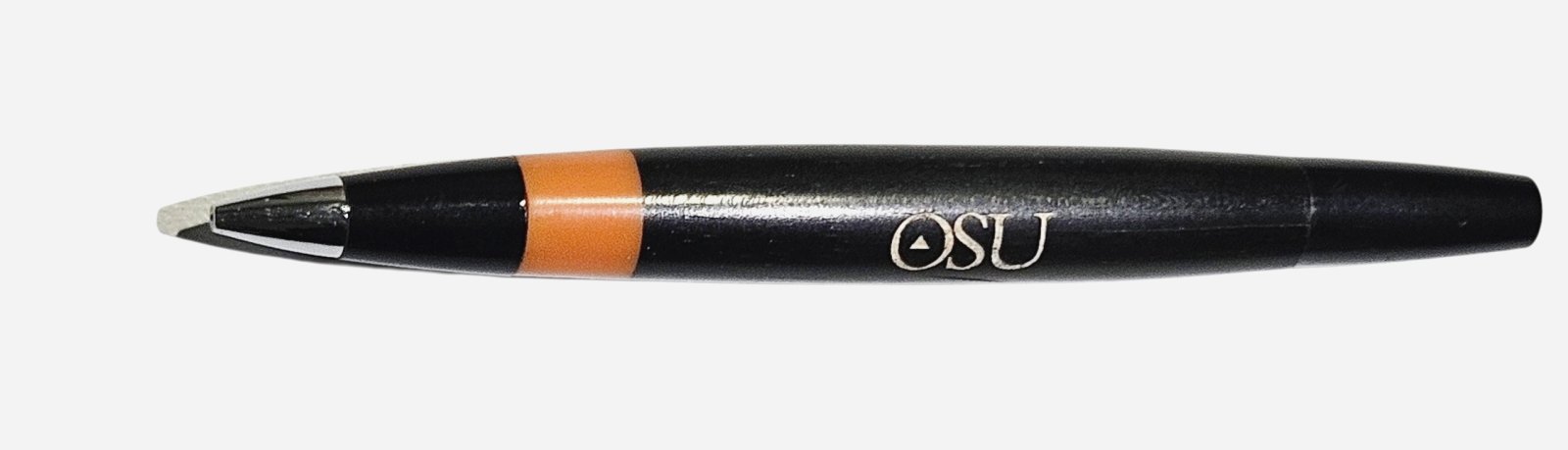

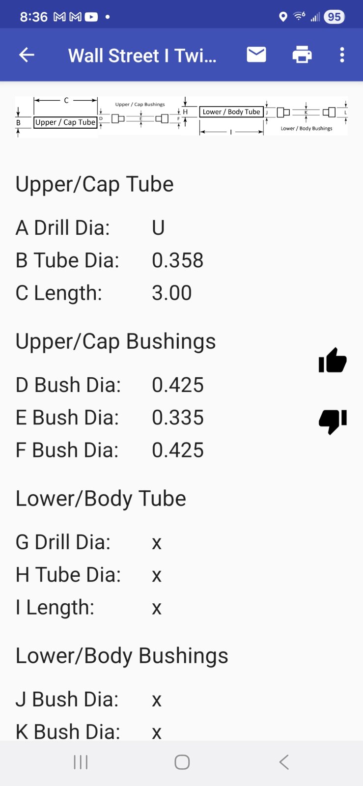

Keith and Rob are correct. Wall Street I. Here is a picture. The orange is part of the barrell. Loved this pen. Lost clip and the cap that held it on. I can contact the owner and get the barrell length if you need it.
