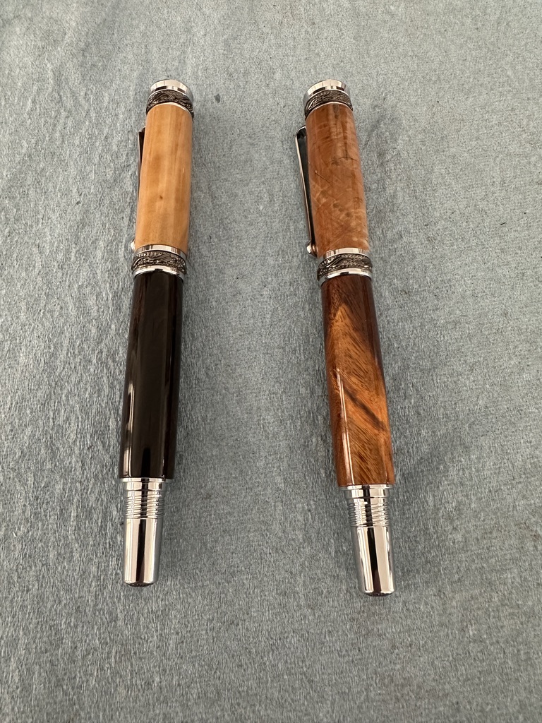

I'm trying to identify the wood on the pen to the right, lower half.

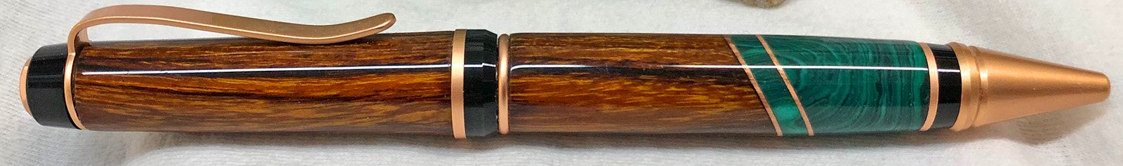

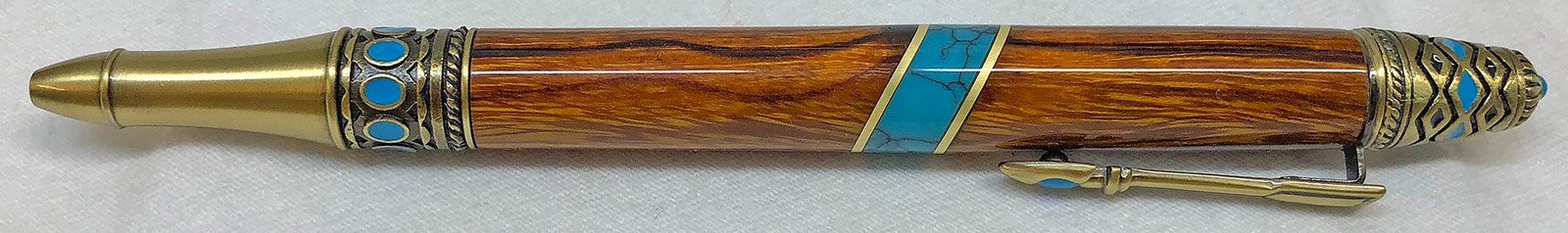

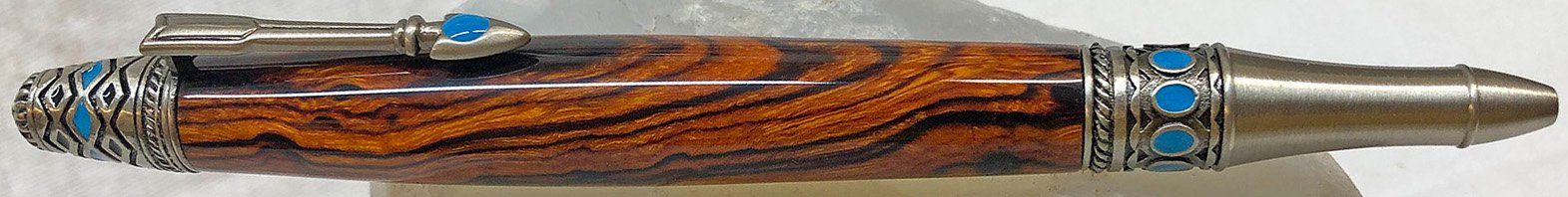

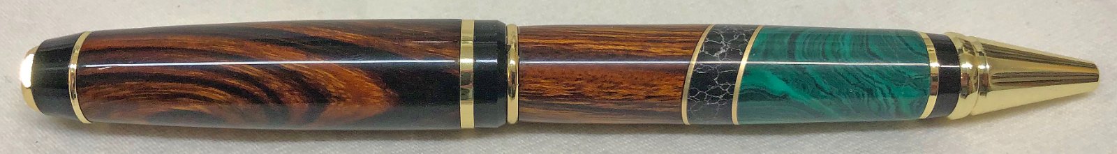

The design of these segmented blanks is outstanding. Makes me want to try mixing more TrueStone with brass and exotic woods.
Sorry, I really didn't intend on stealing this thread. The segmenting was very simple, just diagonal slices. I scuffed the metal really good before gluing and I glued with epoxy letting it cure a couple of days before drilling. I use 90-degree point angle drill bits that are usually used for soft plastics, hard acrylics, and thin sheet metals to help prevent cracking or shearing when the bit penetrates the different material layers. - Dave
Have no hesitation of adding photos and context! It is appreciated and gives inspiration for as you said - simple segmentation; that looks superb. Your few words of process is concise and complete. Often simple is better than complex. Be well!
