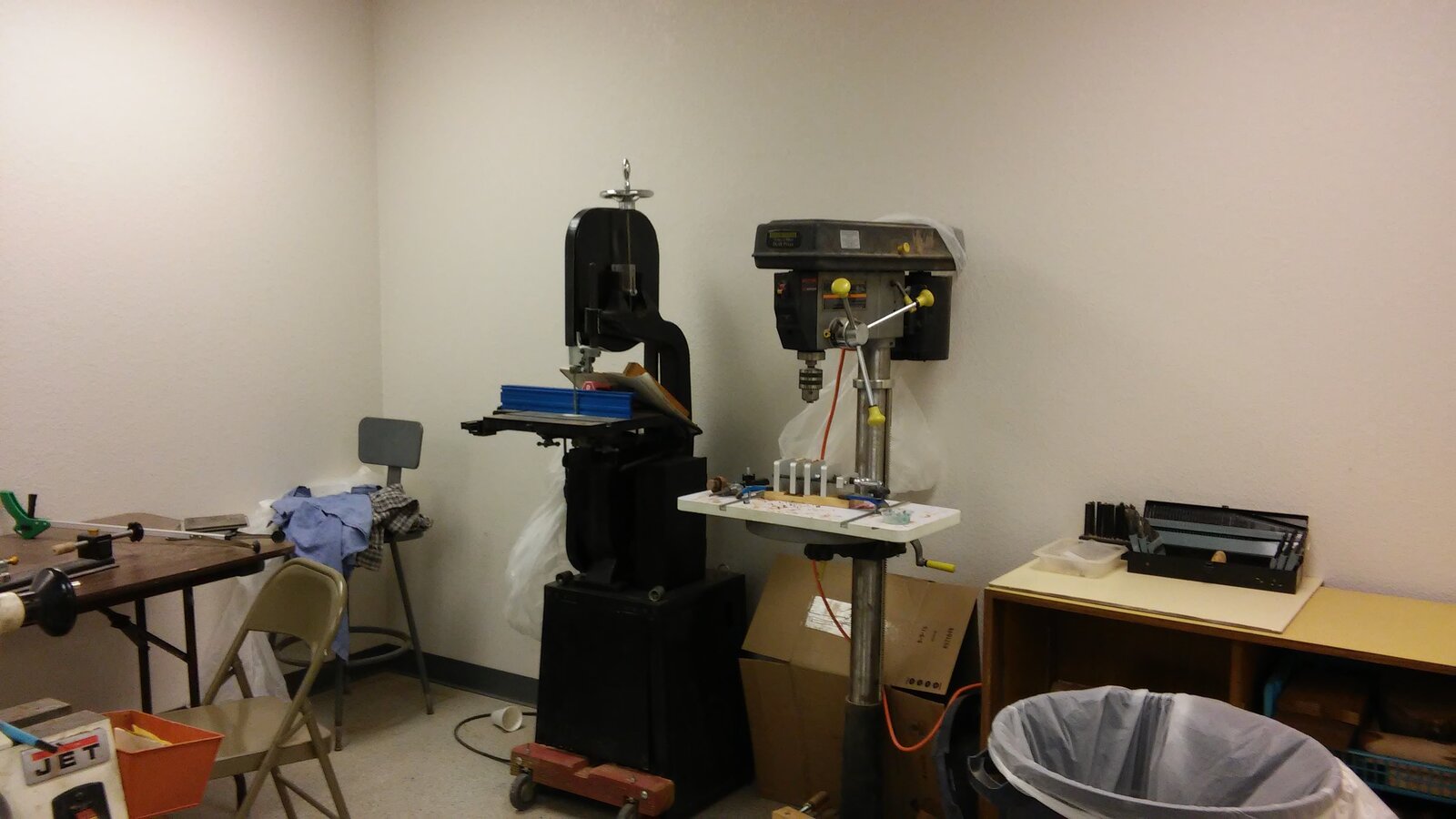

I used to have a rig like this that rolled my lathe out on the driveway. I used bigger wheels and it was wider. https://www.popularwoodworking.com/projects/wheelbarrow-planer-stand/
Both my jointer and bandsaws are on stands like that. My handles are pipes that slide into brackets bolted to the stand so they can come off and be out of the way when the tool is in use. It is especially handy at the blind center because we have to move the bandsaw during rainy season because we have a roof leak over where it normally sits. You can see where the pipes slide through the
holders on the top of the stand. The pipes have caps on one end, and slide in from the front, and lift and roll from the back. The wheels would be too small for what you want to do, however.
The jointer uses the same type of pipes. I have to roll it out onto the driveway to use it to get enough room for long boards. (Same with the thickness planer, which is on a 4 wheel HF base....it's not very heavy.)
