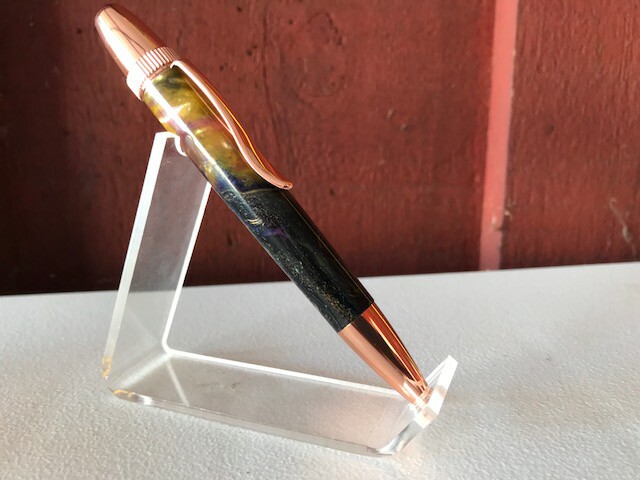

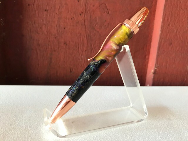

This is a cross post, from show off your pens, but thought it would be good to post here as well.
I received my blanks from George this week, and turned this beauty yesterday.
Working with this blank was very easy. I am not an overly experienced turner, as I have only been turning for about a year, but I do turn a lot of Rhino plastic, which seems to be kinda brittle as opposed to other acrylic I have turned, so I have learned to take things slow, and keep my tools really sharp.
I painted the tube blue, as I didn't want to find out to late, that the acrylic part would show through.
I sharpened both of my skews, and both of my roughing gouges right before turning this blank. The acrylic portion turned like normal, run of the mill acrylic. It didn't "feel" brittle under the roughing gouge or the skew. The coconut husk kind of turned to dust under both the roughing gouge and the skew. Not in a bad way, as the blank was very solid, It just didn't ribbon, or shave off, but "dusted" off. I took gentle cuts with it, but that was because I didn't want to screw it up.
After I turned it to shape, I lightly sanded with 600 dry. The Coconut husk sands beautifully. I then wet sanded, still on the lathe from 1500, to 12k with micro mesh. I wiped it down between each pad to get the "slurry" off of it, as I didn't know how it would react. After sanding to 12k, I stopped the lathe, and took a good look. I noticed that there were a few places on the coconut husk, that didn't polish. Most of it had, but a few places it hadn't. I applied 4 coats of thin CA glue, letting it dry about 5 minutes between coats. After the 4th coat, I removed it from the lathe, and placed it on a peg to dry for about an hour. I don't use accelerator. I then put it back on the lathe and re-sanded it with my micro mesh pads from 1500 to 12k, then buffed it with a quick coat of Maquire's for a really deep shine.
George, once again, I really appreciate the "Offer" and I look forward to turning the other 3 blanks. They haven't told me what kind of pen they want to be yet, but they will when it is their time.
P.S. If I may ask, what is in your acrylic, that adds the micro glitter? I really love it.

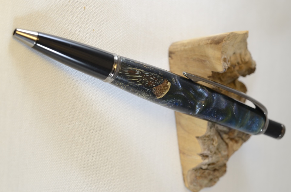

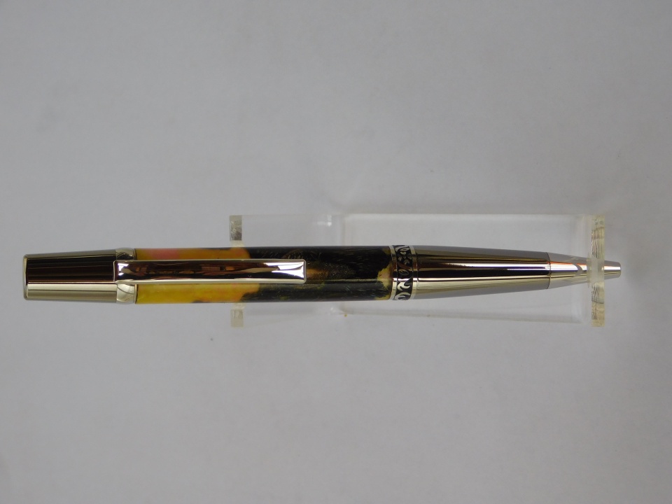

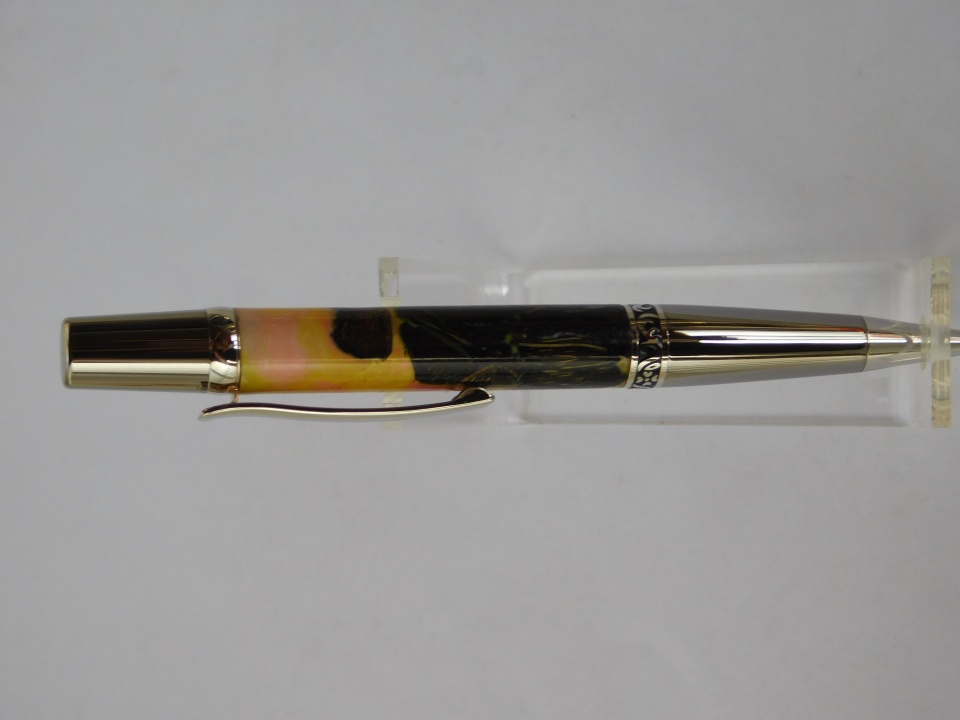

George, Here's my attempt at your blank. I did pretty much the same as Mark(Beautys Beast) did, except for painting the tube black. It cut quite easily with carbide and I had to use CA to fill in the empty spots, then continued with micromesh up to 12k. I then took Meguires plastic polish to finish. It's on a Atlas pen from Woodcraft. I'm having a tough time taking a picture well enough to do this blank justice. The colors and the glitter effects of the Pearlex are absolutely beautiful. I'm going to continue trying to get some better pictures to post for you, I'm just going to have to find the right lighting and setup to hopefully at least give it a chance of showing its true color and brilliance.
Here's my attempt at your blank George. I used a white painted tube, turned with a sharp gouge(as I use for every material I've turned so far) and finished with 6 coats of thin ca, mm'ed to 12k and a couple coats of ren wax. The only thing I noticed was the difference in the density of the husk and the acrylic, which I expected. Thank you very much for the opportunity and count me in anytime!:biggrin: Don't know why the pics flipped when I added them..:mad: I DID warn you I'm not a photographer:)
Even without bigger pics I can see that you've done a beautiful job with it, I can see some sticking effects on the coconut husk from stabilizing it blue, the resin contrast is also pretty.

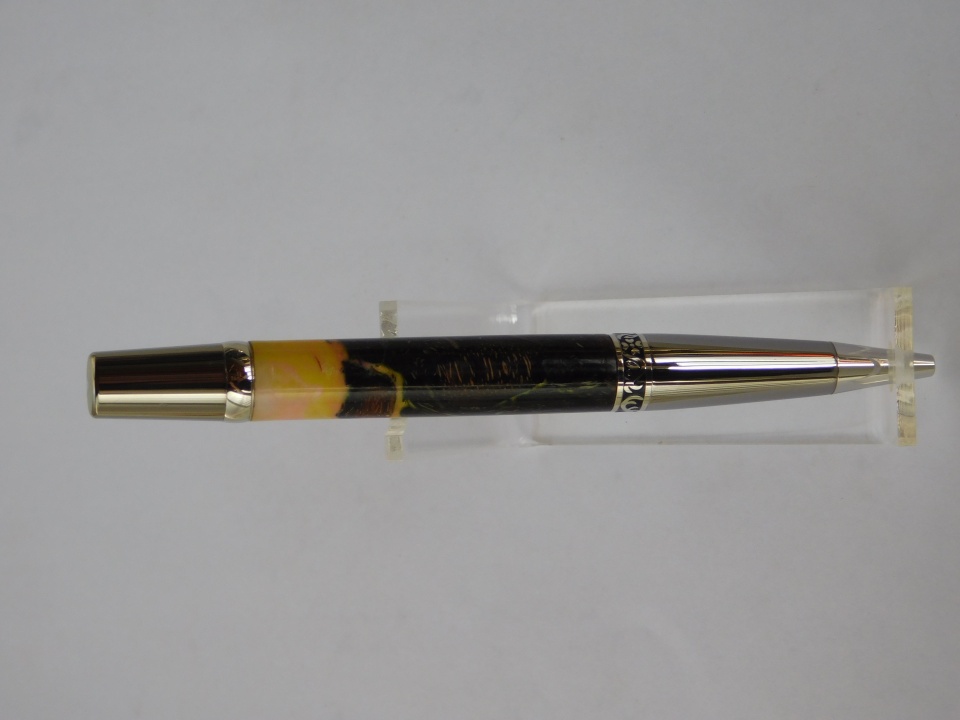

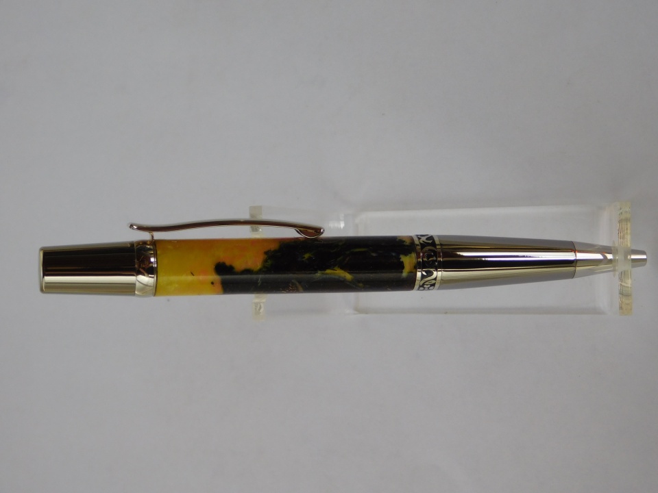

Neither am I so I know how it goes.
Is great to see 100% success rate so far, and I hope that I will see 10 pens made of this material, is also pleasant that the workability experience has been within expectation there is, everybody seems to get it done without many issues.
I appreciate your participation in this "offer" and I like what you've done with it, thank you...!

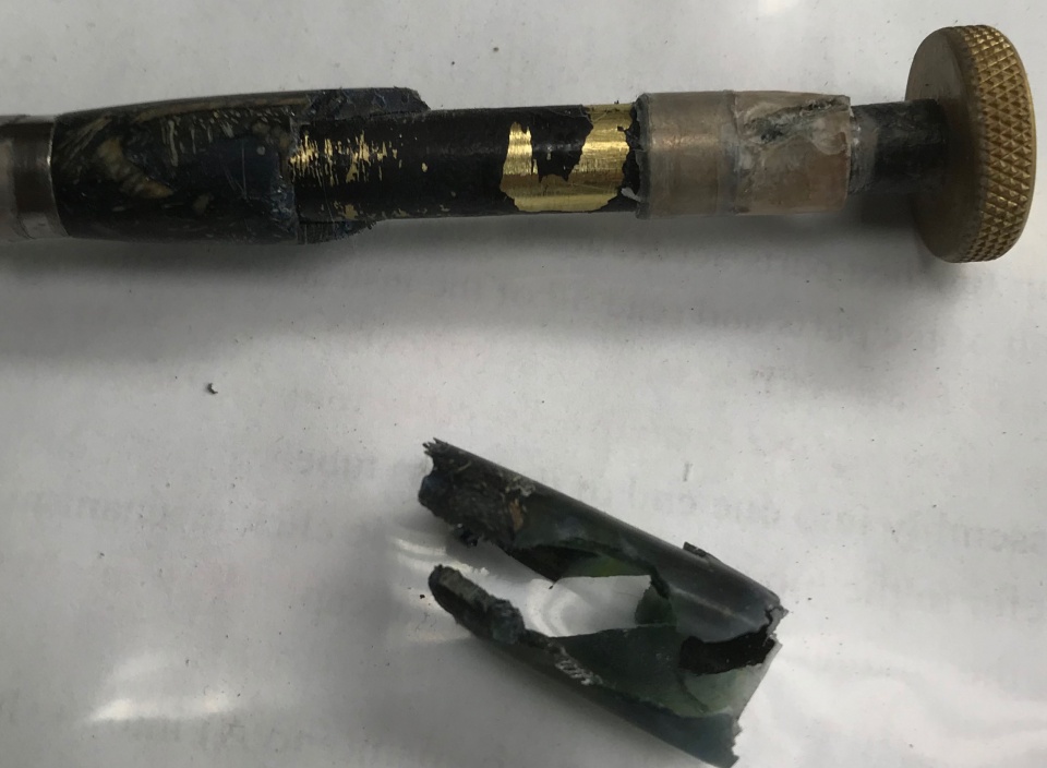

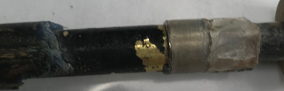

So, as promised, I turned the blank that George had in his offer. I painted the tube flat black and picked the hardware, which was a Le Rio Major with a satin finish. I didn't have a issues drilling the blank nor turning it. I used medium CA to fill a void or two. Started sanding with 180 grit and went all the way up to 600 grit. The blank really looking good. I then used a three step finish which looked impressive. Take a gander..........The issue was that I got greedy and was attempting to get a real nice sheen to it. At the end, I held a sock to it and it got to hot and melted the blank and fell off of the tubing.....So sorry George, I definitely would like another attempt.
Is a shame when that happens and like any other hybrid blank, there is always the possibility that it doesn't make it to the end, there are so many reasons why as you all know so, what I'm trying to say is that I wasn't sure if we would endup with all 10 of the coconut husk pens successfully finished and that doesn't bother me much, is said but, life goes on, turn another pen to help to forget the failure, like I said is not the end of the world and I'm sure, you can have more of these blanks anythine you feel like it.
I'm thankful for your attempt never the less, forget about it, life is too short to worry about such small things...!:biggrin::wink:

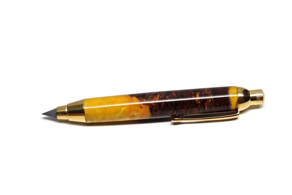

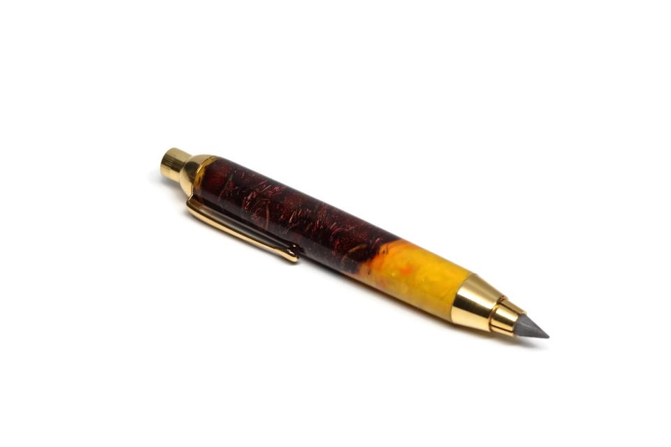

Someone say something about slow??? In my defense I had a 28 pen order to turn in less than 14 days... Good news, I did it!

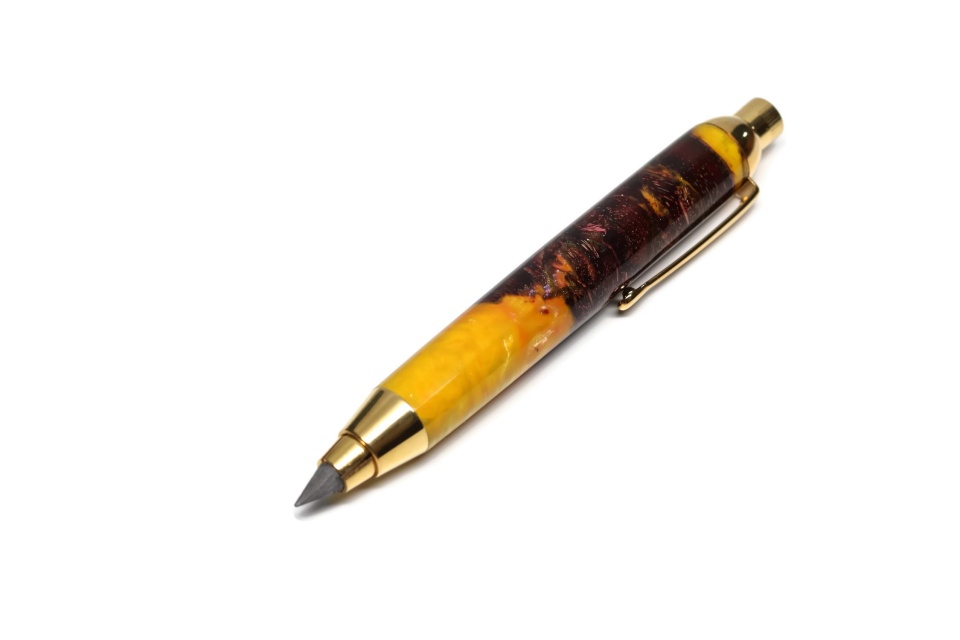

So, here's the shop pencil I made from the palm blank. My only problem was George was supposed to send me something challenging and instead he sent this well put together and incredibly easy to turn hybrid blank. I will say there was one part of the palm that was DENSE to the point where I rotated my carbide to a fresh part. Wasn't hard to turn, it was just tough stuff! Did my usual CA finish like I would for a wood pen. There really weren't any holes to fill in the material so was mostly just to shine it up all pretty like for photos.
I've got one more hybrid to turn from that package George and I'm trying to figure out what kit to do it with. My goal is to have it done for you here in the next week at most. That big order put me way behind on my own casting and commitments like this. My apologies!
Wow, very pretty pencil fit and finish there is only one thing that you are incorrect about and that is what that blank actually is, is not Palm as you mentioned but Coconut crushed Husk, you may be confused because I said that, this material was the closest thing I could find to the Palm root I used for a little while but was unable to find any more while this Coconut material is produced commercially and sold at various location, the problem is how to handle it when you take it home and try to stabilise it...!:mad:
Anyway, I'm pleased that you found very easy to handle this type blank, I did also mentioned at one time that even though I'm know for making some blanks that are very difficult to handle, I stated that, these blanks were not in that category and that was a surprise to me, as the Palm root ones are a challenge.

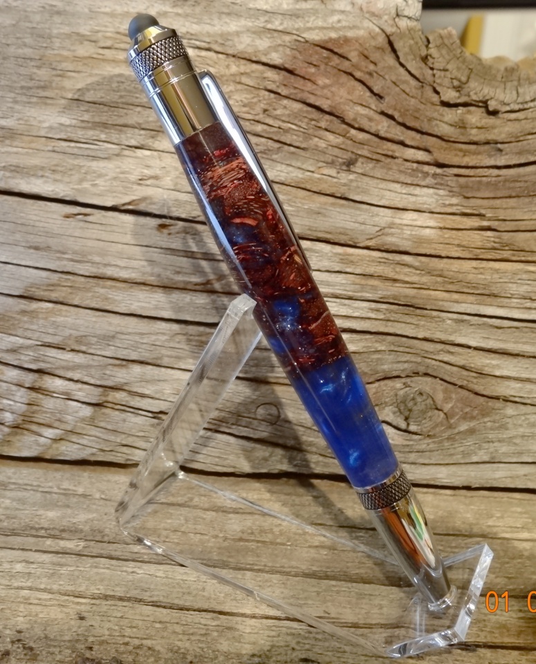

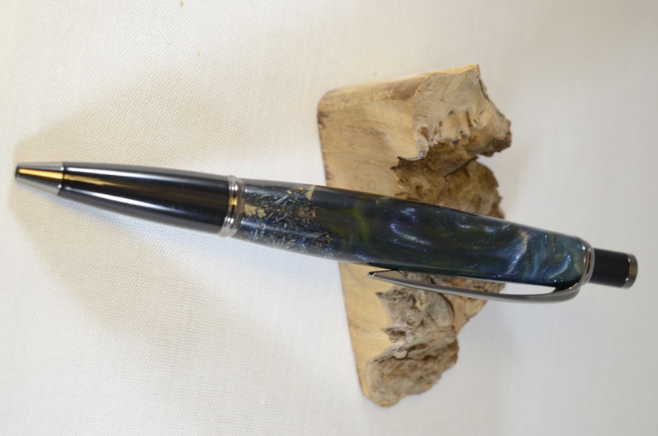

Sorry for the delay. I got sidetracked between work and the holidays...Blank has been cut, drilled and back painted. It should be ready to spin tonight.
I have received an email from Noot17 (Eric) explaining that his pen was done but we haven't yet worked out how to download pics into his album so he attached a couple in that email, he said;
"Turning this was fairly easy, and finishing wasn't bad either."
Eric
Vertex Click with the Coconut Husk Hybrid Blank
I chose to put the smoky coconut husk hybrid blank on a gun metal Vertex Click pen. The blank was easy to turn and finish. There are orange-copper highlights in the husk. The top one shows them the best.
Thank you for the opportunity.
