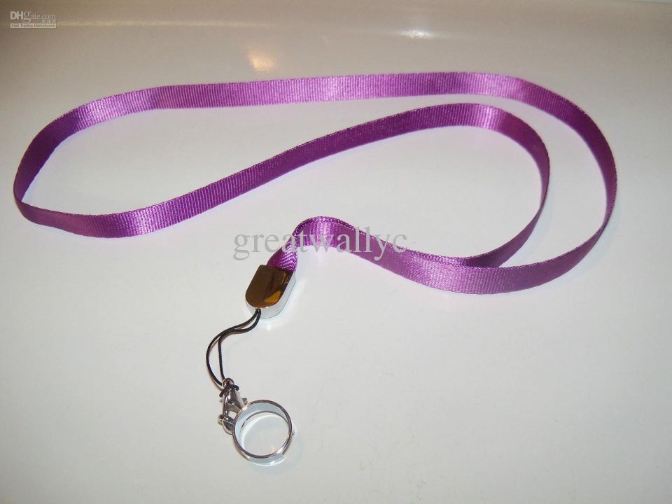

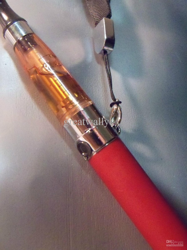

How about this? You can attach a regular pen to it thru the hole.
