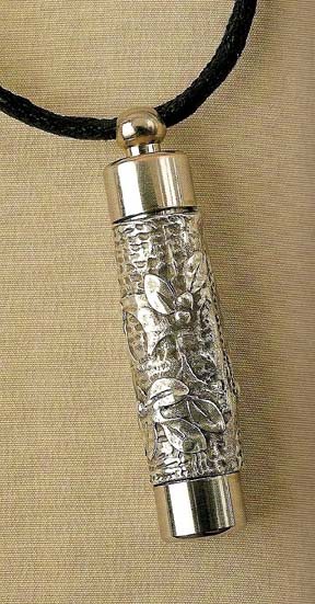

I agree with starting with PMC is a good idea. Its not cheap, but fairly easy to use and offers many possibilities. The picture (not mine) is perfume vial made from PMC on a CSUSA kit - same brass tube as pens so you can see the possibilities. There are courses but a few books will get you started.
Silver casting only requires that you be able to make a mold in wax of what you are trying to make. Yes you can get all the equipment necessary to cast the silver yourself, but I have seen some pretty amazing work that was done in wax and sent to a professional caster. You may have to do some finishing, but it is very possible if you have the desire. Even if you don't get the complete set-up, I would recommend a class so you will know how to prepare the wax for casting.
I think it is worth the effort if you really want to take your pens to a new level. It's not the only way, but certainly a very good one IMO.

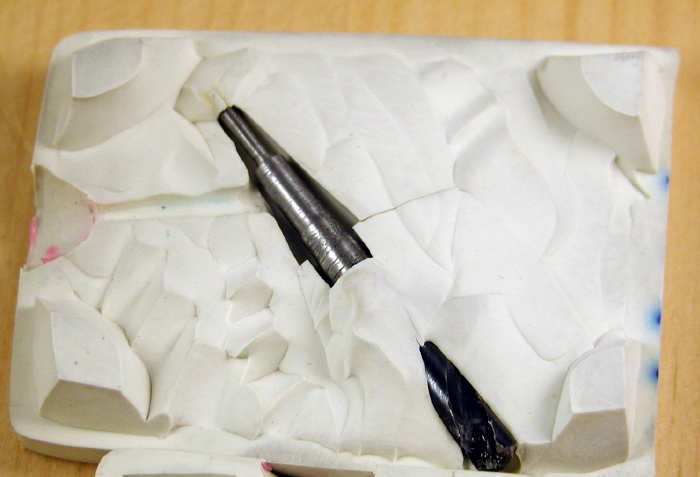

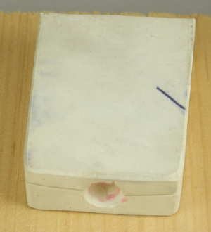

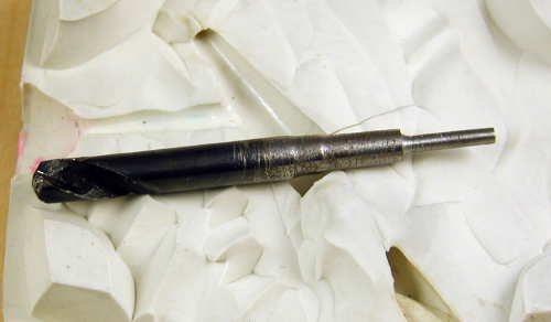

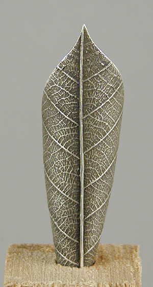

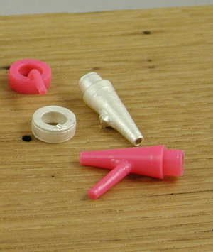

The PMC silver clay might not be the best thing for the nib because of the shrinkage. I've been playing around with it for a couple of months. It would be better to find a casting company that can cast parts for you. There are a few steps to having a custom nib that will work. First the casting company will not make a core for the nib, you have to. The core is the empty space in the nib. My first one was not quite right so I will fix it. That was the first mold that cost $25. The second mold the core should be right, they will make some wax patterns that I will dip in wax to make it a little thicker and have a designs and patterns in them. I'll take the best ones and have master molds made from them that I will have cast when I need them. Cost for the silver and to have them cast it will be about the same price as the PMC Silver Clay. A little over a dollar a gram. There will be a little time involved cleaning and polishing but the cost should be around $10 to $12 for the nib. I'm not sure if any of this make scenes to you but if your really interested in having your own silver parts made, you can contact me. There may be a chance I will sell sterling parts next summer. Just the nibs and center bands. These will be for cross type desk pens.
