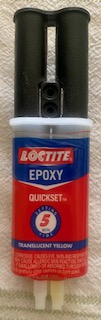

I like to use Loctite 5 min epoxy. I find it near paint isle at Menards and my local hardware store. It can be a little thick, especially this time of year. What I do is thin it down with warmth. I use a shop clamp light over it for a few minutes prior to use but you can also run hot water over the container prior to use. It mixes and works much easier when warmer and because it is in a plunger type dispenser its easy to get close to equal parts to mix. It also mixes well with paint if you want to color your epoxy before use. I prefer it over CA because it's more flexible and the bond won't break when turning. Paint is always an issue with me also. I've lost several clear cast blanks due to dissolved paint. Hope your project works out. Good luck
Thanks John - all the loctite I saw was black - will check out other stores
