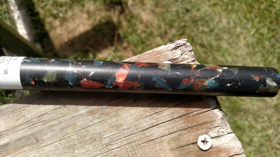

I am not sure what material this is but I presume it is similar to a plexiglass. And I believe it is the same material used on the mesh and water clear acrylics. It has a unique smell to it.
I can not get it to take the threads for a Jowo nib section. My process is good and tools are as well. I made a two sections with my cast acrylic after wasting four sections with this material. I had good threads when using acrylics.
Thanks for any help.
In what way "take the threads"? Do you mean it stripped the threads at the same time as it cut them? Or it wouldn't cut at all?
Were you able to successfully thread the tenon that screws into the barrel? (That's a good test because the threads are visible, so you can see if the material is crumbling away instead of holding threads.)
btw, if it's "Inlace Acrylester" I gave up; the threads crumbled and shattered. I contacted Woodturningz and talked with somebody there who clearly had made pens, he said the material isn't really intended for threading.
It's not Inlace, this can actually be worked, although delicate is the key. I got it from Richard Greenwald.
It does thread very easily for the larger threads but for the finer stuff, I'm not having any luck. The tap will screw in and pull itself in and out easily. I can't feel the thread stripping out either.
I know it will take fine threads because Edison uses blanks made from the same material for #5 and $6 nibs.
Mike

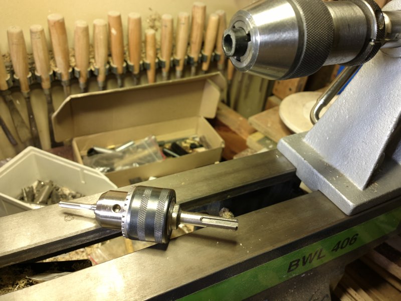

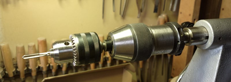

I had similar problem with some materials even when I tried method described by Duncsuss. The final solution which works for me is chuck in chuck devise (please see pictures).
There is PE tube in the chuck sitting in tailstock which serves as a bearing for the chuck with tap. This allows very delicate and smooth operation when threading.
