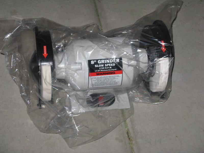

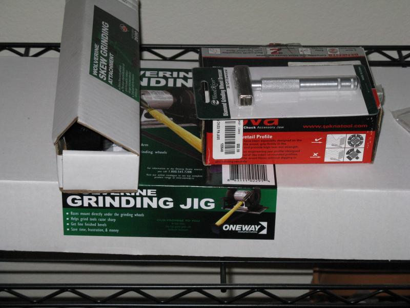

I stopped at Woodcraft on the way home and got a slow speed grinder, wolverine jig, skew attachment and a NOVA Pin Jaw kit.

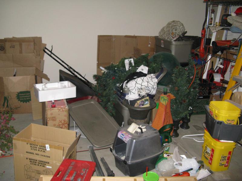

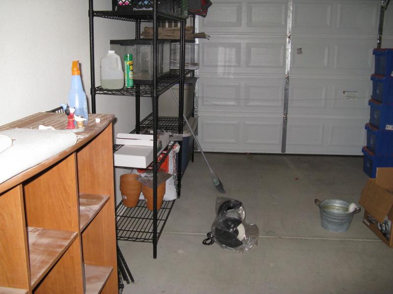

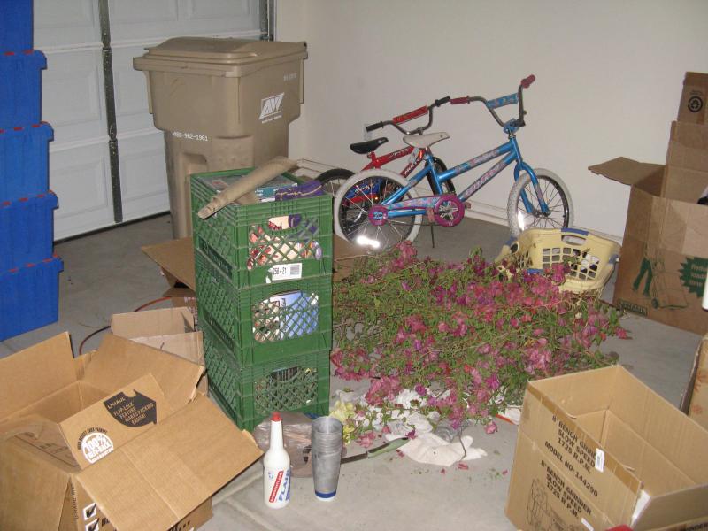

Here are some pictures of my garage right now...its been like this since we bought the house 3 years ago. Time to clean it out! ...and some pics off my loot for the night.
