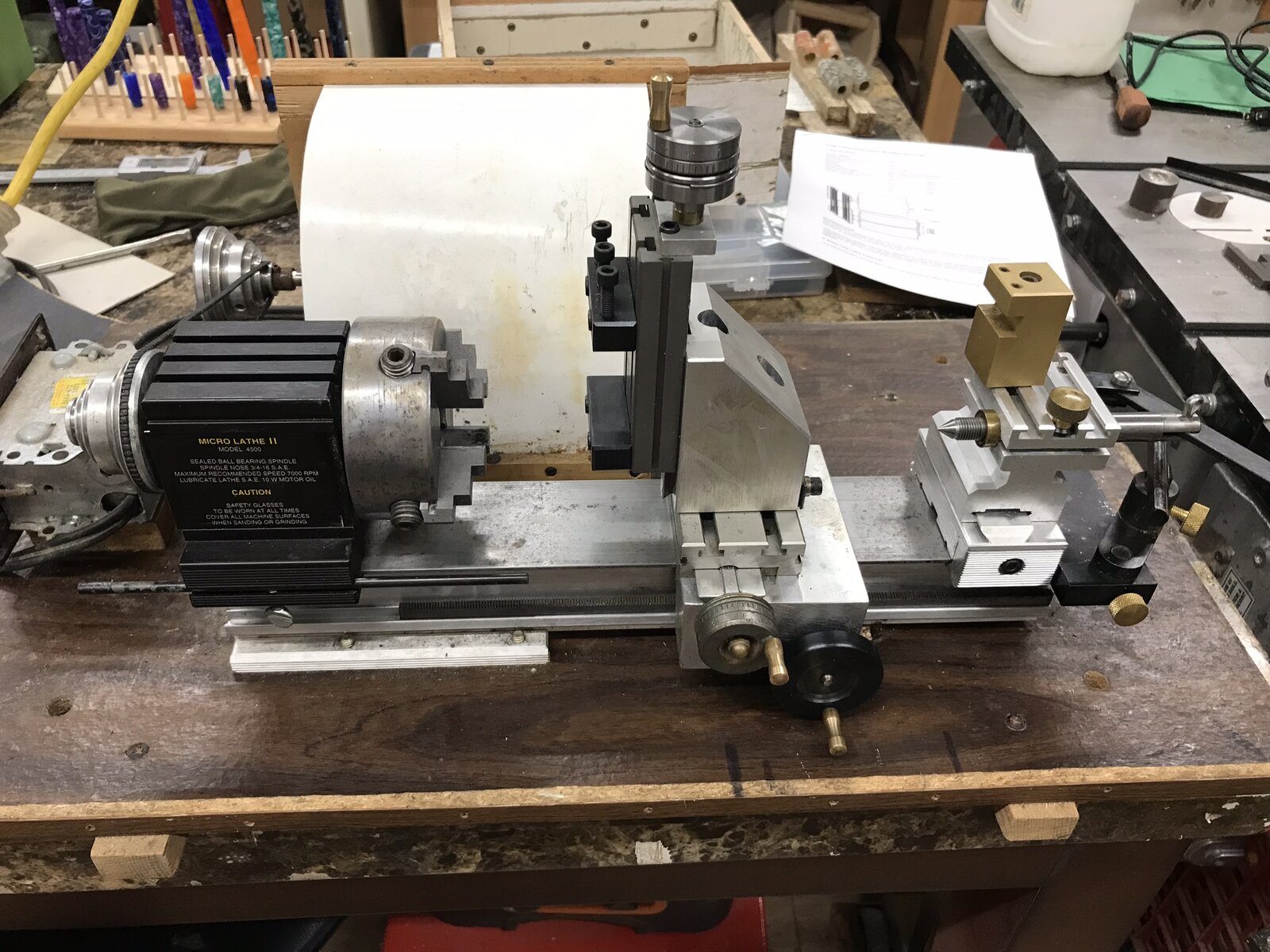

I just picked up this Taig lathe at a local auction. It was in a bit of rough shape, but I got it fairly well cleaned up. It came with milling attachment, that I am hoping to use on my clips.
