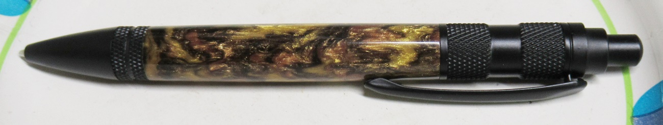

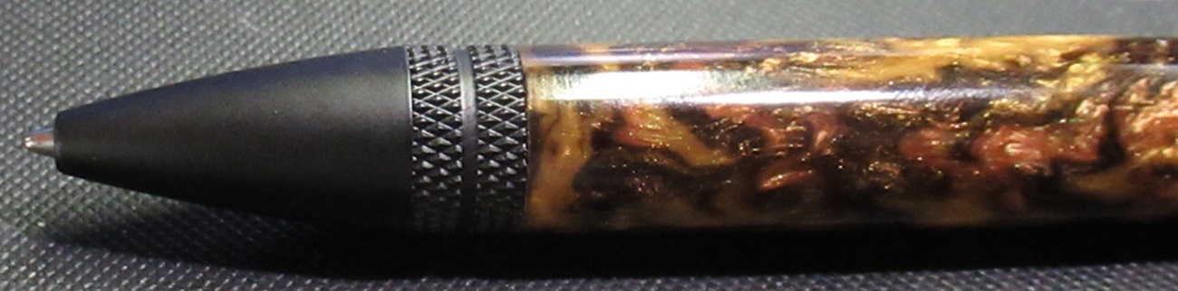

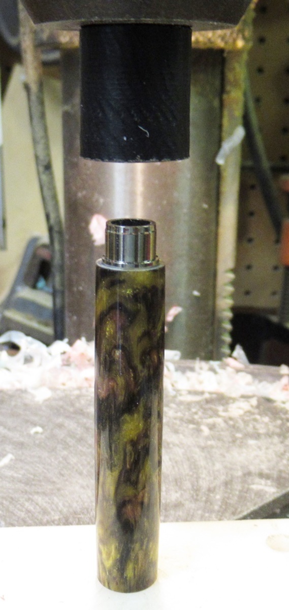

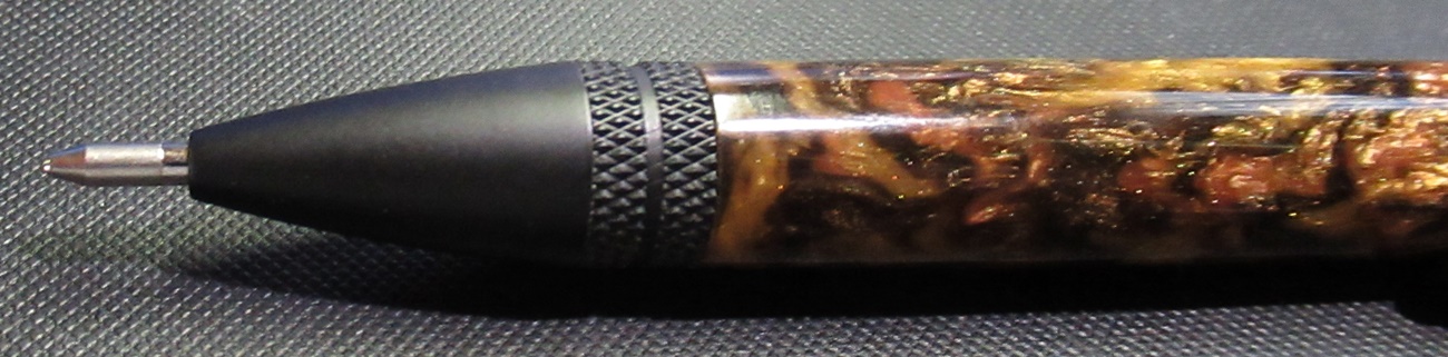

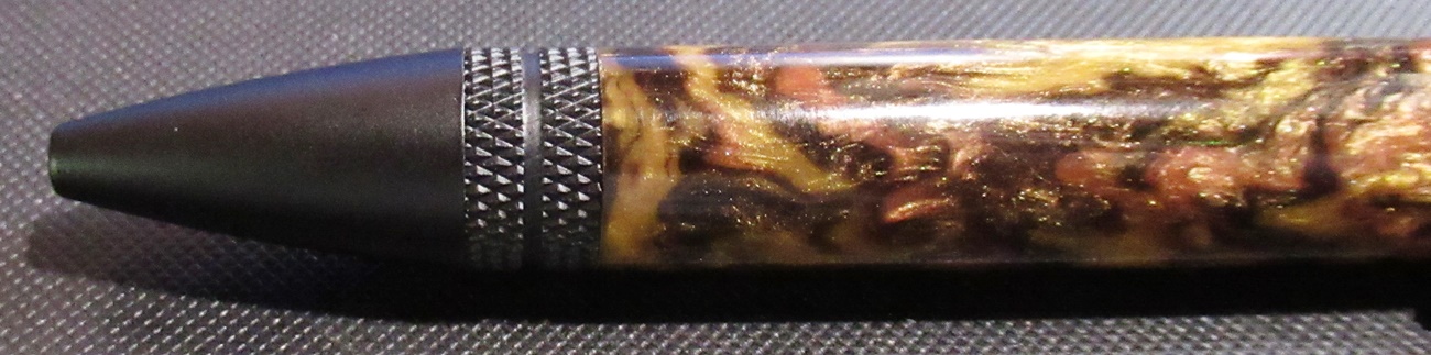

In a fit of stupidity, I assembled a Capital Click pen wrong. Somehow, I pressed the threaded coupler threads first into the end of the pen. In the process of trying to disassemble it, I somehow messed up the click mechanism. Now it doesn't retract all the way, and it extends way too far. Any ideas? I'd really like to save it.

Yes, I removed the plunger. This happened as I was trying to drive the clip/mechanism assembly out of the body. I ended up driving the transfer punch into the white plastic piece.
You can take the refill and place it in the click mechanism and lightly tap it to drive the click part back in it. I have had success with doing this.

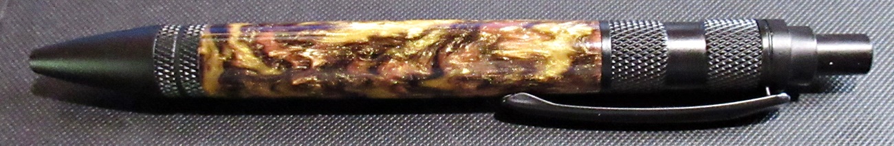

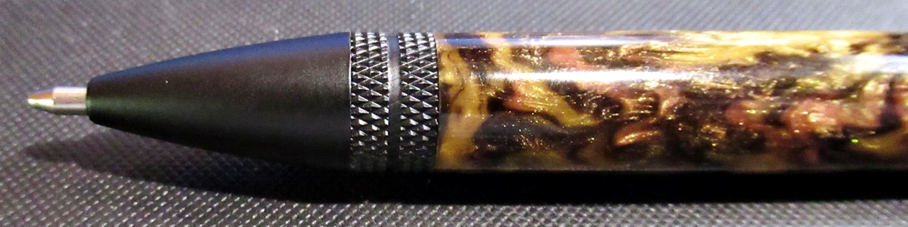

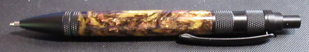

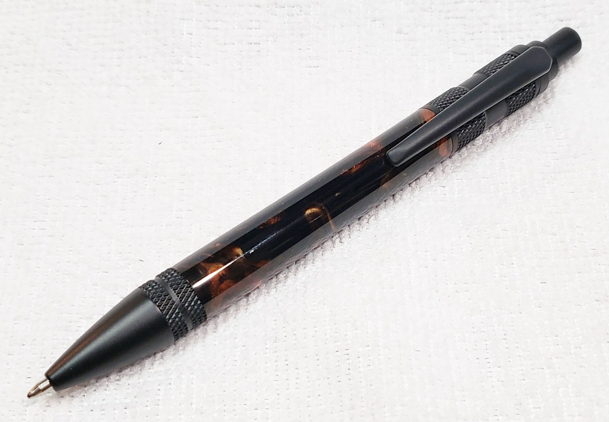

I'll be darned. It worked! I pressed hard on the tip of the refill until it clicked. Now it retracts all the way. It seems like it extends a little far, but I looked at photos of the other two Capital Click pens I've made, and they stick out a ways too. Maybe not quite as far, but close. Thank you Keith!

Good to hear that your pen has been fixed !
It is a very beautiful pen !! . I like the combination of the black hardware with the blank you chose !!
