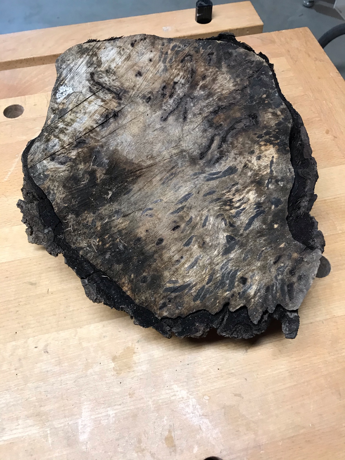

I coworker brought me a small walnut burl that he saved from a tree he lost last year. He just wants a pen made from it and then I can have the rest. Now, this is all new territory for me. All the wood I have ever used is dried and ready to go so I have a lot of questions. I will probably google some but I know there are a lot of experts right here at IAP. I would appreciate answers to the following. Should I cut it into pen blanks and let them dry as smaller pieces? Should I remove all the bark from it? Can I dry pen blanks in a regular oven?, if so how hot and for how long? Does all burl wood need to be stabilized? I don't have stabilizing equipment and I'm not wanting to go down that rabbit hole. That's enough questions for now. Thanks in advance for the help.
I would saw some blanks and let them dry quietly. You can use an oven with more cracking risks, but you will quickly know, and walnut is forgiving. You don't really need to stabilise it, but if you are afraid of anything you can always soak it in CA.
Not sure how it has dried until now but it looks like there are no obvious cracks on that face, that seems a good start. I agree with Pierre, slow drying as 1" square blanks is probably the best. If you are in a rush, oven heat is probably too much too fast and I'm guessing most blanks are likely to develop cracks. I've had good success using desiccant silica beads on semi-dry wood like you have (I used these but probably many other sources https://www.amazon.com/gp/product/B01G5NTCWW/ref=ppx_yo_dt_b_asin_title_o05_s01?ie=UTF8&psc=1), I left the 3/4"blanks in the middle of the bucket of a few weeks and used them once they stopped losing weight. It was spalted oak, not walnut burl though, so you might have a different experience.

Thank you both , I will forgo the oven and cut a few blanks and let them dry naturally. Now I know you can't give me a definitive answer as there are a lot of variables, but about how long would it take a 1 inch pen blank to dry?

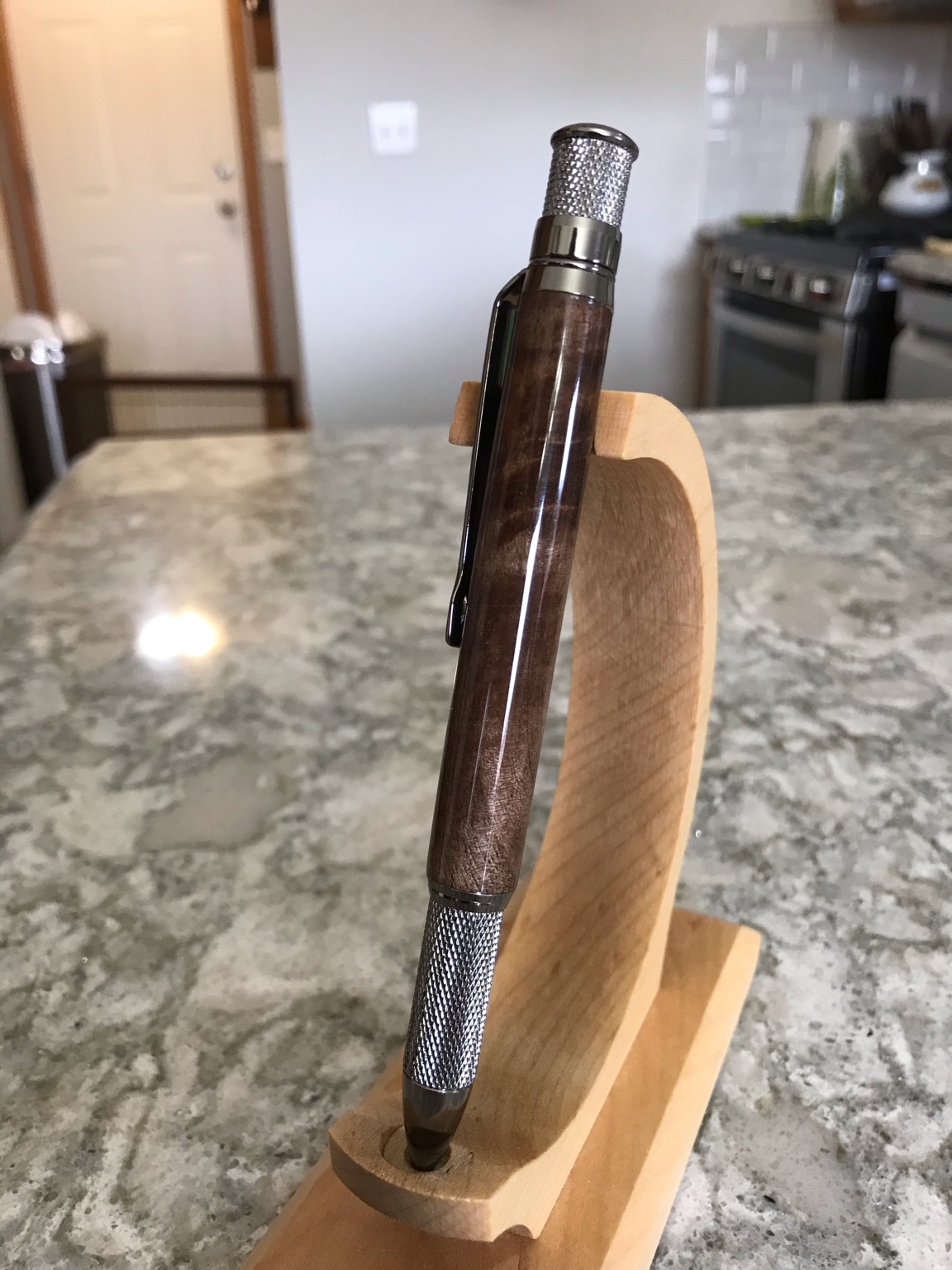

Okay here's the final result. I dried the blank in the microwave until it stopped losing weight I used 1 minute cycles at 30% power. Our microwave is 1000 watts at 100% power. It is not a highly figured burl but I'm sure my buddy will like it as he has a personal history with tree from which the burl came from. The pen is a GT Knurl with gun metal plating.
Looks great. I always find it hard to get walnut burl to really display the burl like I think it should in the final product. There always seems to be figure but not much contrast. I'm open to suggestions. Anybody? Bueller?
I like Walnut for the smokey figuring and you've captured that well Ken. I've tried melamine lacquer and that brings it out well for me anyway.
