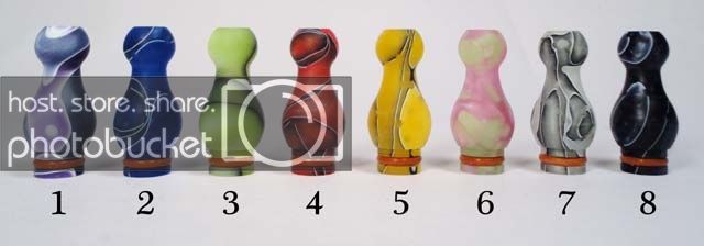

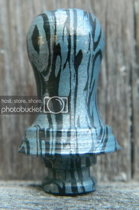

So I smoke a e-cigarette and am really starting to have fun with it. That being said... the part that you put your mouth on to inhale the water vapor is removable. there are places that are making acrylic ones and some are making wood ones.
I have been playing with them for the past week or two and I cannot for the life of me figure out how to turn these tiny little things. They have a 3mm hole in the center and are about 1" long. any help would be great!!!
I DID NOT TURN THESE AND DO NOT TAKE CREDIT... THESE ARE JUST FOR REFERENCE SO I CAN DO SOME FOR MYSELF
