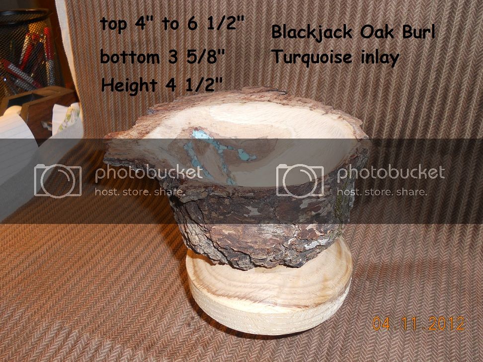

I havent turned a bowl in some time. I was out on my farm last week looking for large burls on 440 acres of trees. I found several and cut them for use. I found one very small burl that looks like a breast about the 32A size. I removed because it looked interesting.
Started out as a natural edge, very difficult to mount because of the way I cut it. Natural bark edge and body. I t5urned and carved out the center and blew the side out of it twice, replaced the wood lost with bark from another burl and repaired all natural defects with Turquoise. Can you find where I glued a piece of wood and bark about 1 3/4" long and 1" wide then covered all of the wood and exterior Turquoise with bark?
I don't have the foggiest notion of what type of finish to put on this bowl? I would like to darken the inside. What should I do to the bark? Any comments would be appreciated.

Bowl finishing....
I started all of my turning doing solely bowls, and have just recently gotten into Pens. Finally a topic I know a little something about...I've felt like a kindergartener reading posts here.
I've used three different finishes for similar Object D'Art. For the inside, since it has the turquoise inlayed, you should use a walnut oil or tung oil (test them both on the base of the bowl that not be seen or will be removed - to see which you prefer). You can then use a paraffin-type of wax over the oil if you wish, but it's not required to protect the grain.
For the outside of the Bowl, you can either leave it as is (i.e. Au naturale) or use a clear spray laquer. The concern on which to use depends on when the wood cut from the tree. If it was removed from the tree while it was still cold outside, the bark will remain on the bowl w/o any problems. If it was cut in warm months, then the bark will eventually separate from the wood. This isn't a problem per se, just something to be aware of and plan for...

To darken the bowl you can use BLO. It will darken slightly at first but continue to darken w/ age.

BLO will not darken any Oak Burl, rather it will enable it to darken naturally. Whereas Walnut or TUng oil will darken it (to differing degrees) just by itself and then nature takes over and it continues to darken.

Tung
I ended up doing it with a very small amount od fruitwood stain mixed with Tung Oil. Darkened it a small amount 9what I was looking for, and wiped and a few more coats of Tung Oil followed by steel wool to flatten the gloss.
For the bark, I left it natural except for using a CA injector for bark that looked loose. You cant see the CA and
