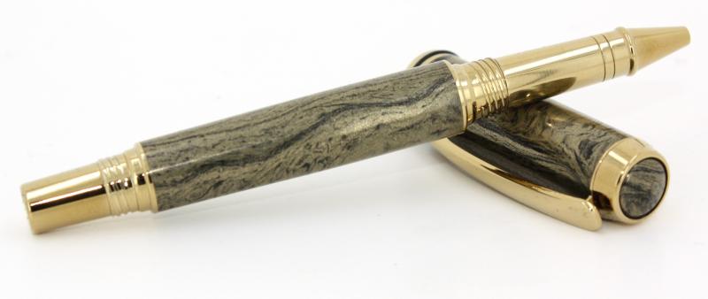

I had a lot of difficulty trying to get a good photo with a white background. Here's a comparison of one I spent a lot of time on to get a decent shot with white as the background, and although it looks good, the coloring is still off, not representing the actual look of the pen very well and the white background is still gray.

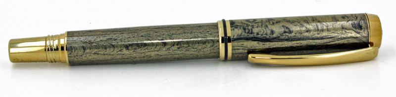

Then here is the same pen with a gray background. See how the details of the pen come out a lot more, and the gold plating really looks more like gold metal instead of gold paint, like in the above photo.
So experiment and try different backgrounds to find what works good for you. Also, definitely check out adjusting the white balance level to the type of light you're working with. It's one of the most important items you need to consider, along with bracketing to find the exposure level that works best for a given light source and correct focus.
You're off to a great start, keep playing with the settings to find the best settings for the camera and light box available to you.
