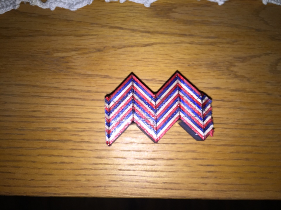

Maybe if you post a photo of the blank we can make an assumption.

Here is the blank I am talking about having drilled.
Not sure what you think you are going to get out of that pattern. Depending on what kit you use and how you shape it most of that pattern will be turned away. What are you filling the voids in with??? I agree you do need to be somewhat centered in order to keep the zigzag pattern a straight line. I have no more suggestions for you. I think it is something you will have to investigate on your own being the lathe is in front of you. Good luck.
If you look at the pen from the thread I shared in the original post, that is the pattern that came from the blank posted on page 2 of the shared thread.
The voids will be turned away.
http://www.penturners.org/forum/f13/114-piece-segmented-celtic-pens-142085/

John if you look closely at the picture again you will see two pencil lines running across the glue up. When cut on those lines a pen blank emerges. :)
:eek:Wow Pete I am going to have my glasses adjusted. I did not see that. It is like one of those puzzles, can you find the lines in this puzzle?? Thanks for pointing that out.:bulgy-eyes: I wish the OP a lot of luck. I can not help any more with the drilling. All suggestions have been outed.

LOL, JT, I just went back and viewed the picture of the blank I posted and it is DEFINITELY an optical illusion. The picture is of the side of the blank. What you don't see is the width which is the width of the Spectraply blank. The actual height of the part of the blank you see in the picture is probably over an inch from high point to high point. Should have taken a picture at more of an angle to see that. I can now see how you were confused by what you saw.:biggrin:
