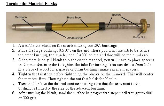

But "where" in the LIBRARY can the find the Bearing Comparison Chart? I am looking to see if I can find a match for the Electra Rollerball pen bearing #29A.

Does this help? From the instruction at Berea.
Edit: OOPS, sorry Ed. I spent so much time getting this image that I had not noticed that you already referenced the info.:redface:
Yep, looks like the "Bushing & Tube chart" hasn't been updated since the Electra came out. That would be the where, IF it were up to date.
Sorry can't be of more use, never turned one myself so don't even know how big they are other than the tube (which wouldn't be helpful here).
Grand Torino,Stretch,Dayacom Rollerball.I don't use bushings but they are all very similar.Should be really close if not the exact same.
