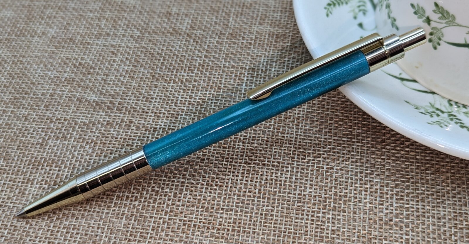

I present... the pencil. That @#$2ing son of a inbred weasel sphincter pencil. The color and thickness was set by the recipient.
  • The first blank I drilled through too fast and left a melted bubble in the middle, so in turning I cracked through to a bubble.
  • New blank ordered and it drilled/turned/polished fine.
  • On assembly I found that I'd under turned by a hair.
  • On disassembly the fit was tight and I ended up both rolling the lip of the tip and cracking the blank.
    So, I attempt to repair the blank. Do a decent job but will need to hide part of it under the clip.
  • I'd shaved off the rolled bit but used a touch of CA on the tip.
  • Which spilled out, got on my fingers, and dinged up the finish.
  • Repolish very carefully as the tip is still on the blank and I didn't want to mar the metal.
  • Assemble, now with the tip on the other end and the cap/clip covering of the slight blemish. Due to disassembly the tube had expanded and I had to use CA on the cap to get it to stick.
  • Which spilled out, got on my fingers and then on to the blank.
  • The actual pencil mechanism has a plastic collar that would not fit through the cap.
  • I ended up breaking off the collar while trying to pull it back out and ended up destroying one pencil mechanism.
  • Filed down the inside of the tube and tried with a 2nd pencil mechanism.
  • Destroyed the plastic collar but did not destroy the mechanism.
  • The whole thing is too long. The pencil eraser is almost completely into the cap.
    Fine.
  • Re-dissasemble but there is nothing for the punch to grab and push against, and don't forget I CA'd it in.
  • So I end up shoving a large amount of gun swaths into the tube to create a wedge
  • Cap pops off. So does the collar on the nib.
  • Take this moment to refinish and repolish, again careful of the nib.
  • Spend a bit of effort to un-wedge the gun swaths.
  • Sand the blank down to the shorter size needed on the disk sander. As the collar free nib is still on, I wrap some more gun swatchs around the punch to try and get the blank 'level'
    • Wisely I sand down the damaged end.
Where was I?
  • Re-dissasemble , again.
  • This time I manage to not get CA everywhere.
  • It goes together nicely, the press fit works again on the clip end so I use a touch of blue loctite
  • Click mechanism is tight and lead doesn't feed.
  • Stare at it.
  • Stare at it some more.
  • Hail mary to a 3rd kit pencil mechanism.
  • That one works fine.
Sheesh.
So no, Mr. Egnald, you are not alone in not being able to let it go. :)

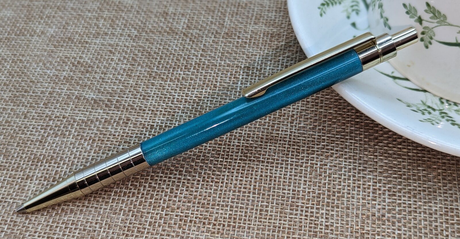

    Fine.
Where was I?
  • Stare at it.
Sheesh.
  • Stare at it.
Sheesh.
So no, Mr. Egnald, you are not alone in not being able to let it go. :)View attachment 366015
So far my misadventures are trying to use CA glue to glue tubes in. And the CA hardening with like 1/2 inch of tube still standing proud. Or, having a acrylester blank shatter when the drill bit broke through. (I actually glued that back together the best I could, then filled the rest with mica mixed into some deep pour epoxy. It almost worked and you couldn't tell. Or I've had a carbide catch that caused the urethane blank I was working on to just shatter down to the tube..
But never such a story as this one. For all the pain and suffering, it looks really nice though.
