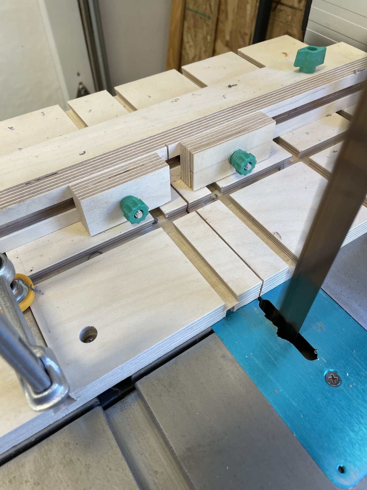

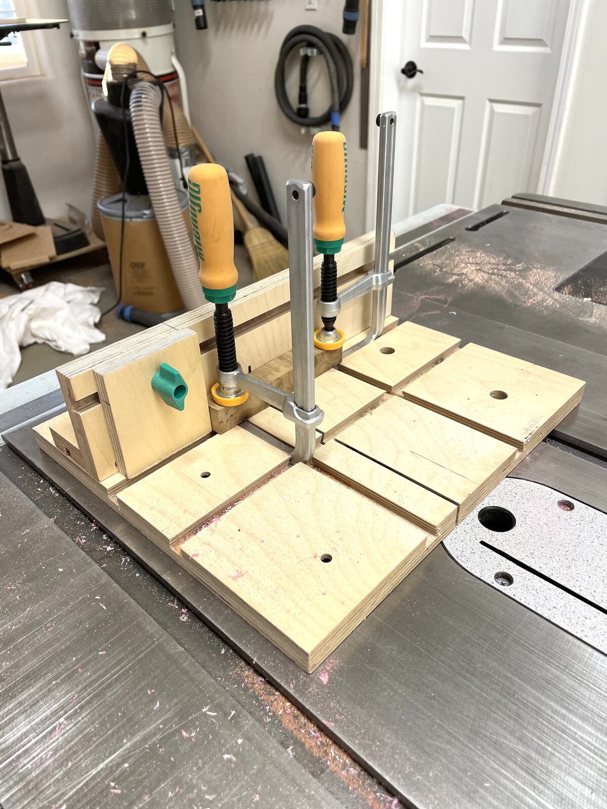

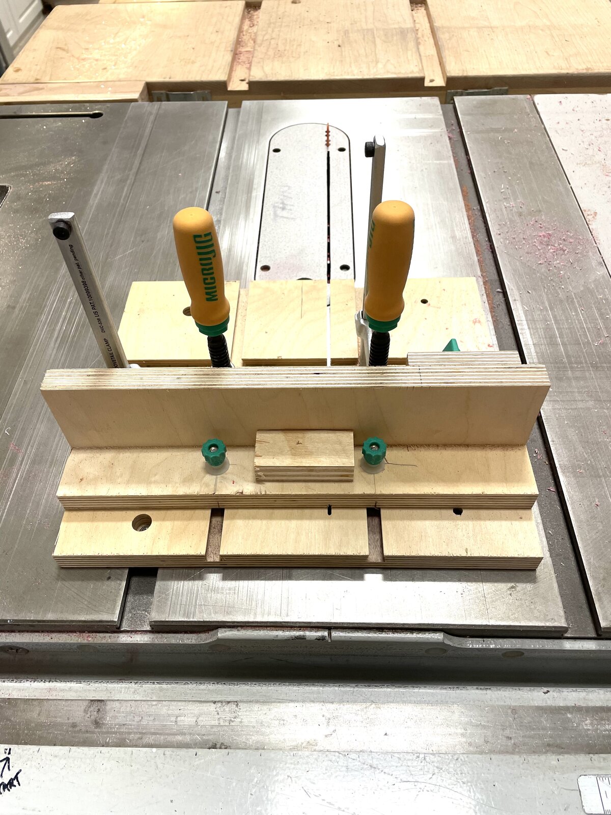

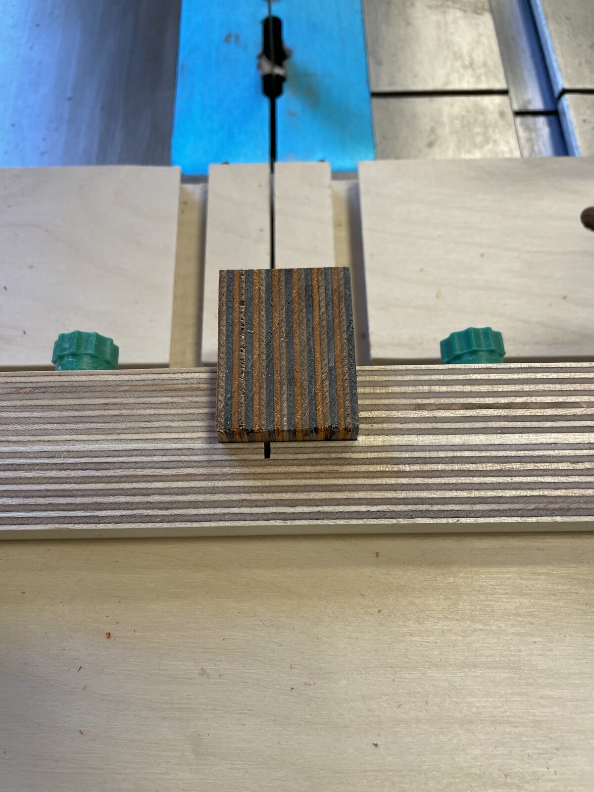

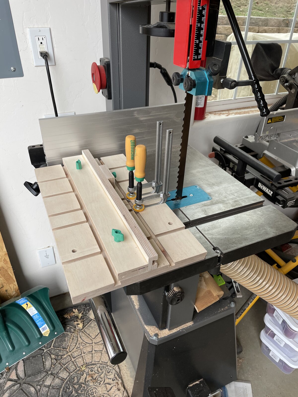

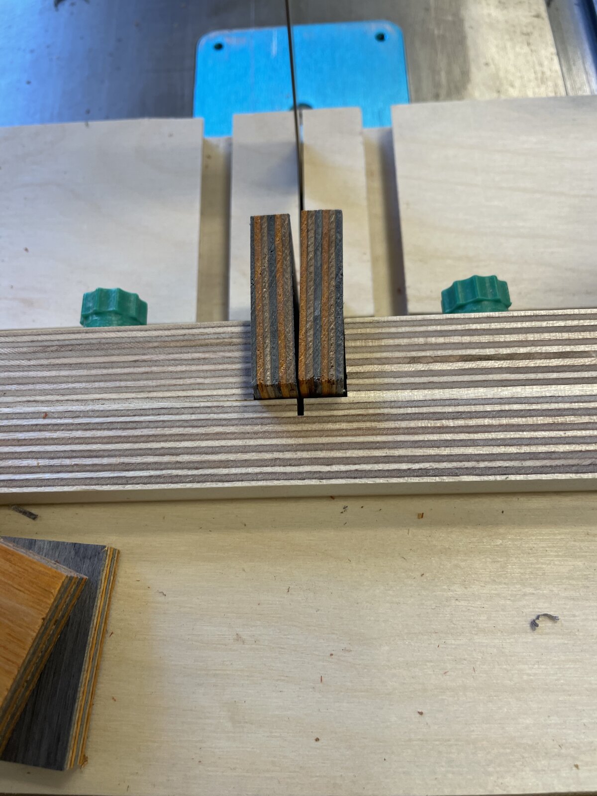

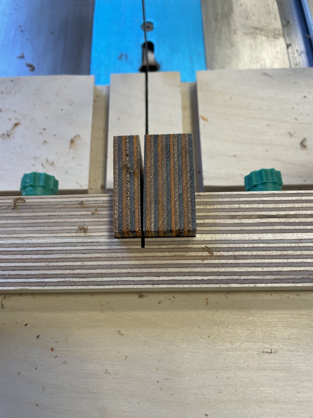

Made my first pen blank cutting sled. There is a learning curve, but it worked well. I managed to hold down both sides of a blank during the cut. My goal was to reduce small pieces flying at me after the cuts. Success. I cut several blanks nicely and far better than my Rockler small sled. I think biscuits will be used for 90 degree pieces on fences. I used screws and later a screw and a router bit said hello. I was quick to stop. Biscuits and glue won't care. Photo of prototype to follow.
One drawback- the dovetail clamps don't rotate. Think about where you want your blank and where you route your dovetail grooves.
I will cut one more groove an inch to the right side of the kerf to have both clamps travel front to back.

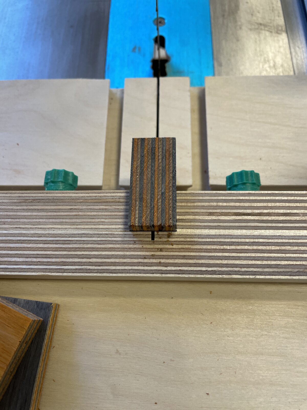

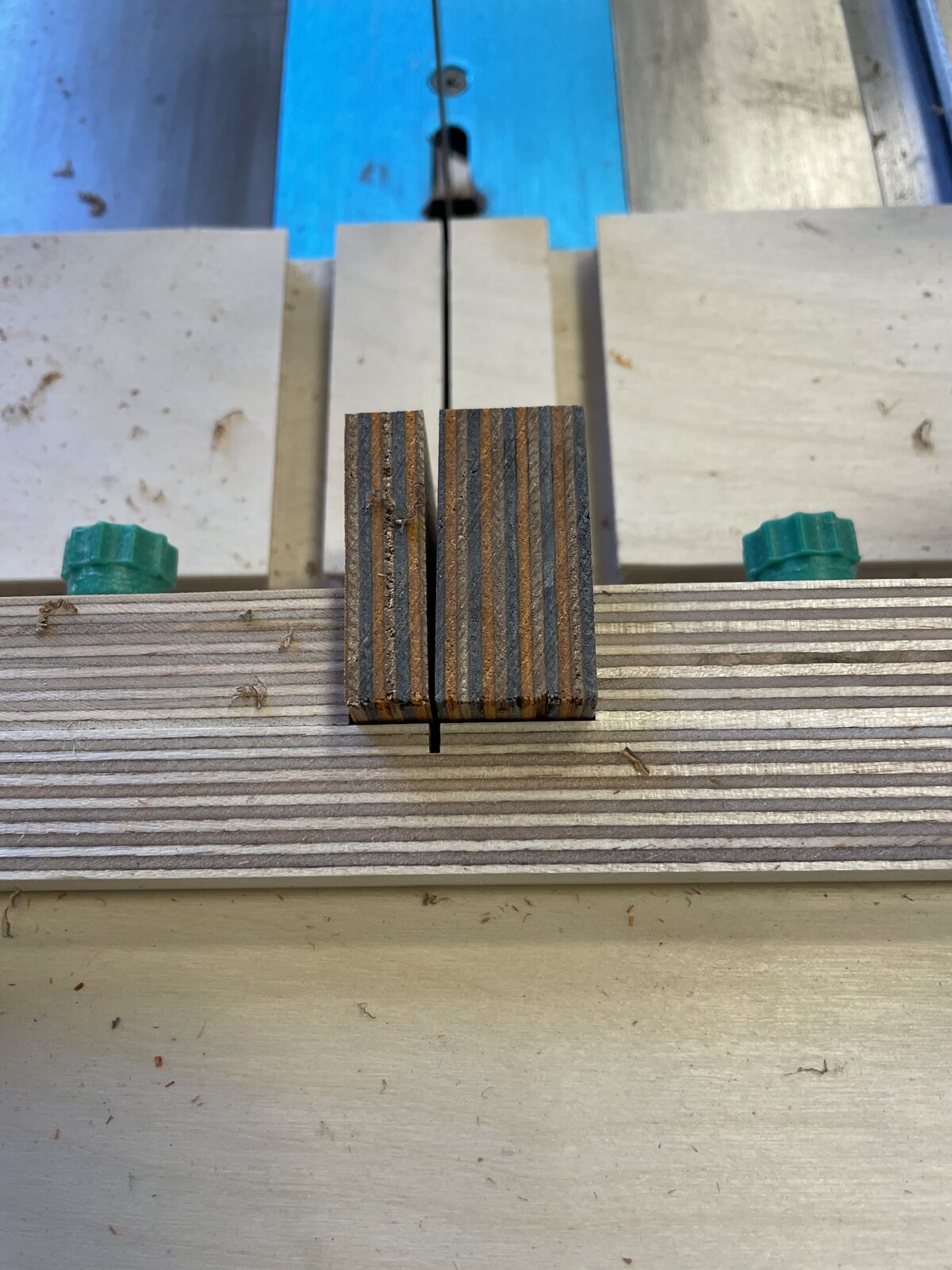

Here is my bandsaw sled for small parts like pens, bottle stoppers and ring/money clip slices.

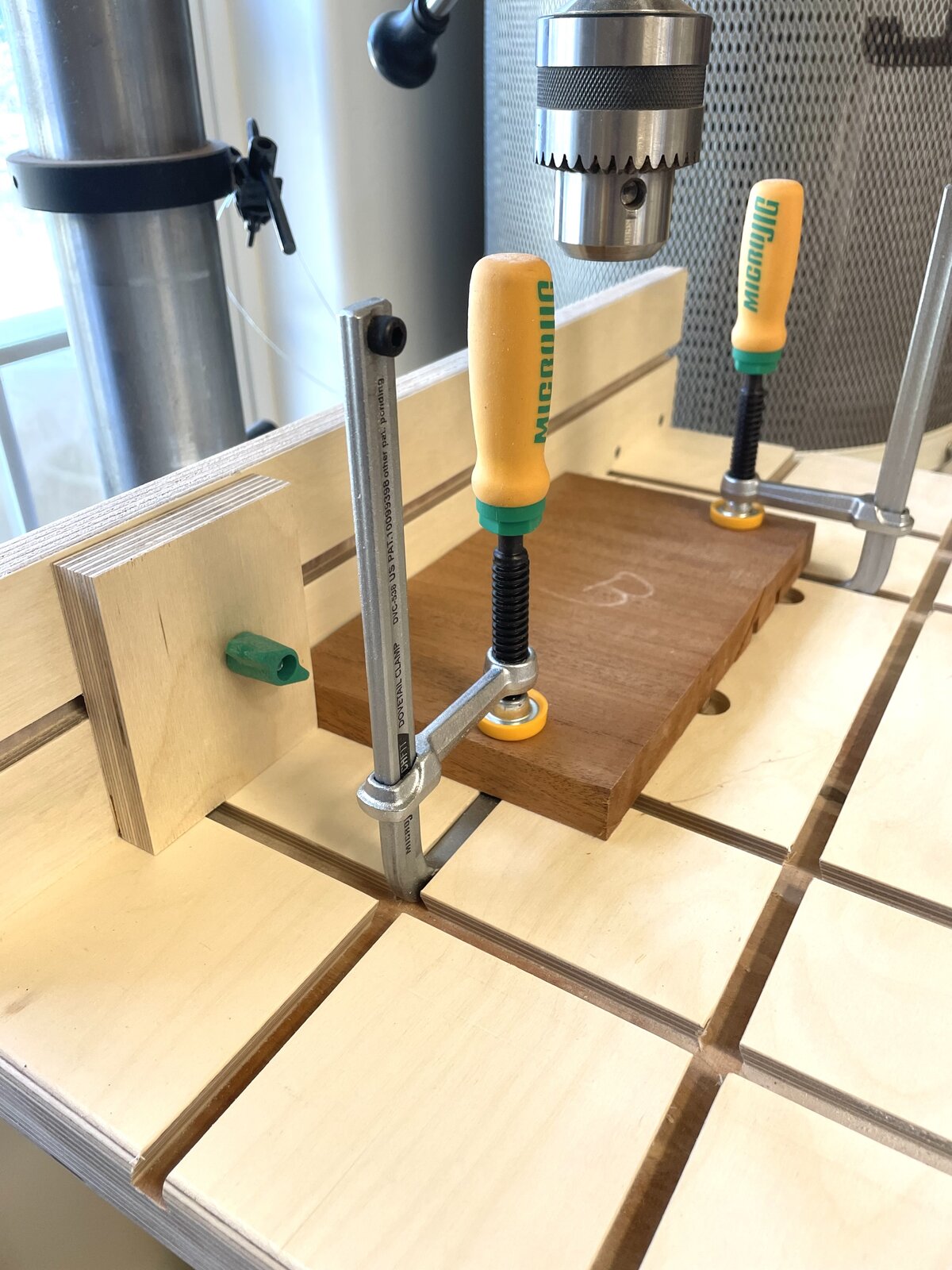

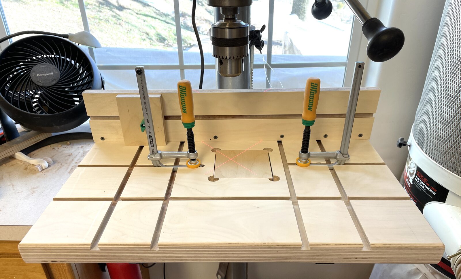

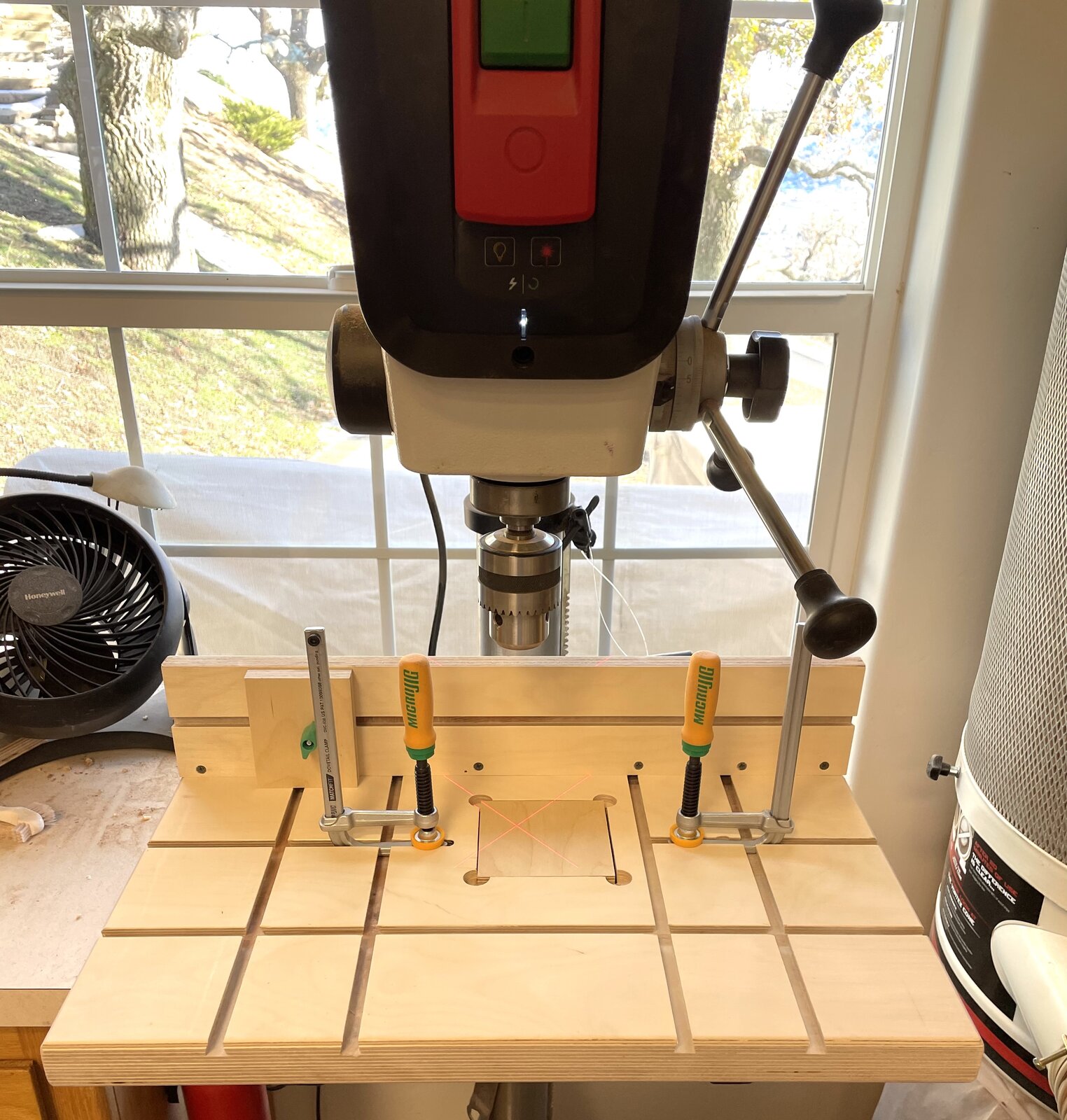

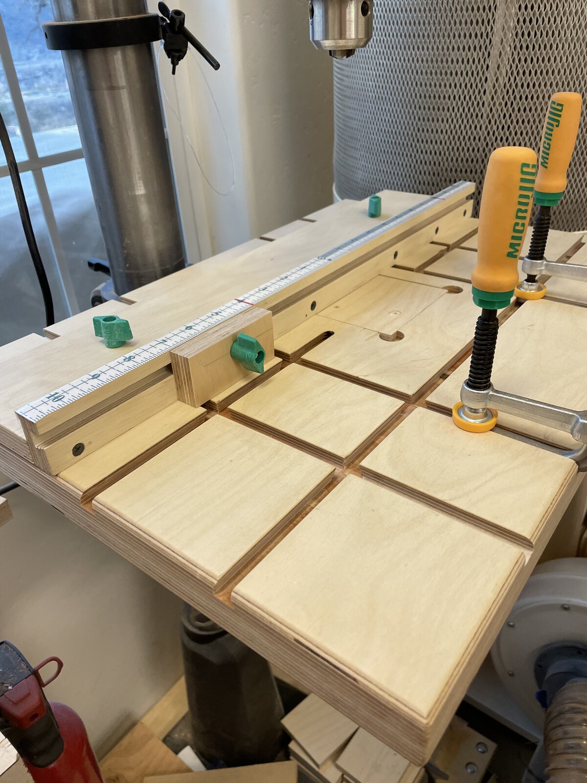

Drill press base and fence. The fence has been shortened to avoid interference with the chuck.

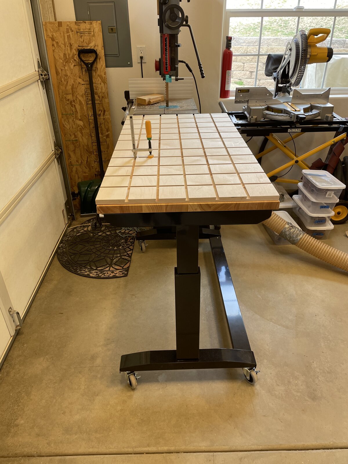

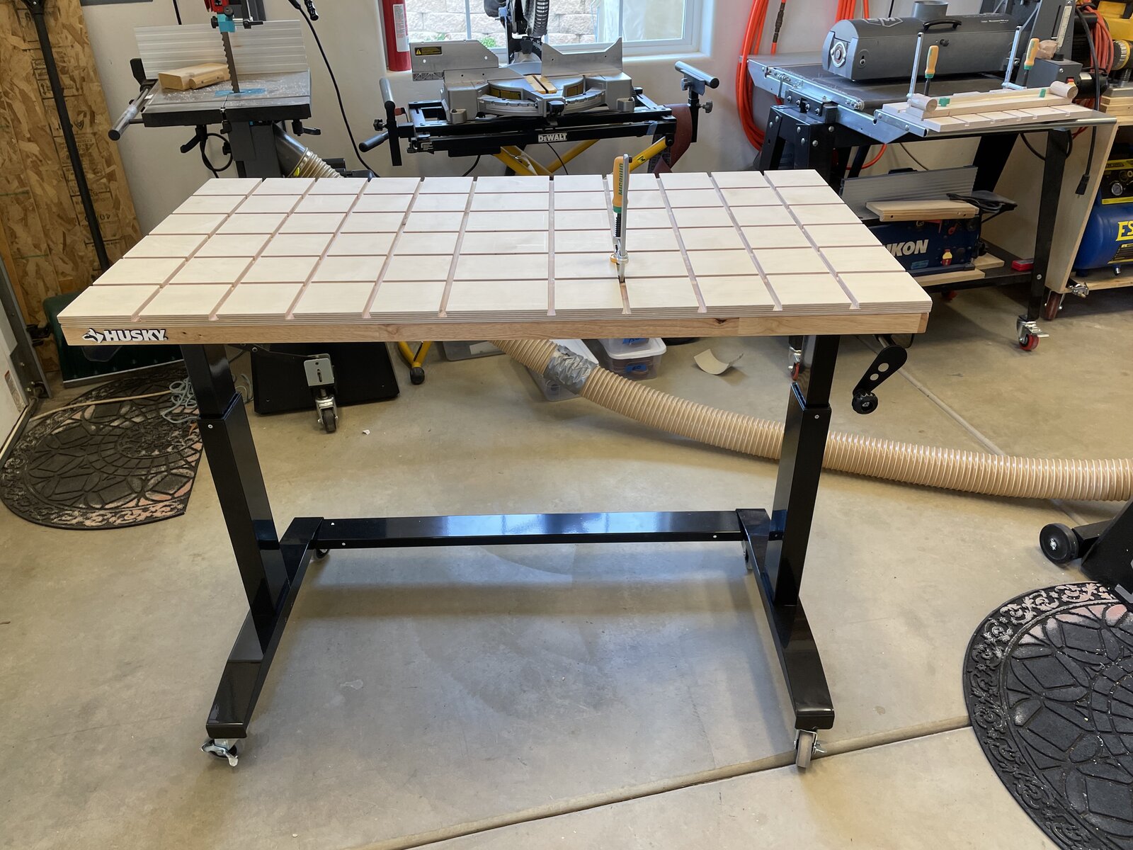

This is a Microjig modified assembly table based on a Home Depot adjustable height mobile table. It can be used to enhance the real estate of my bandsaw.
